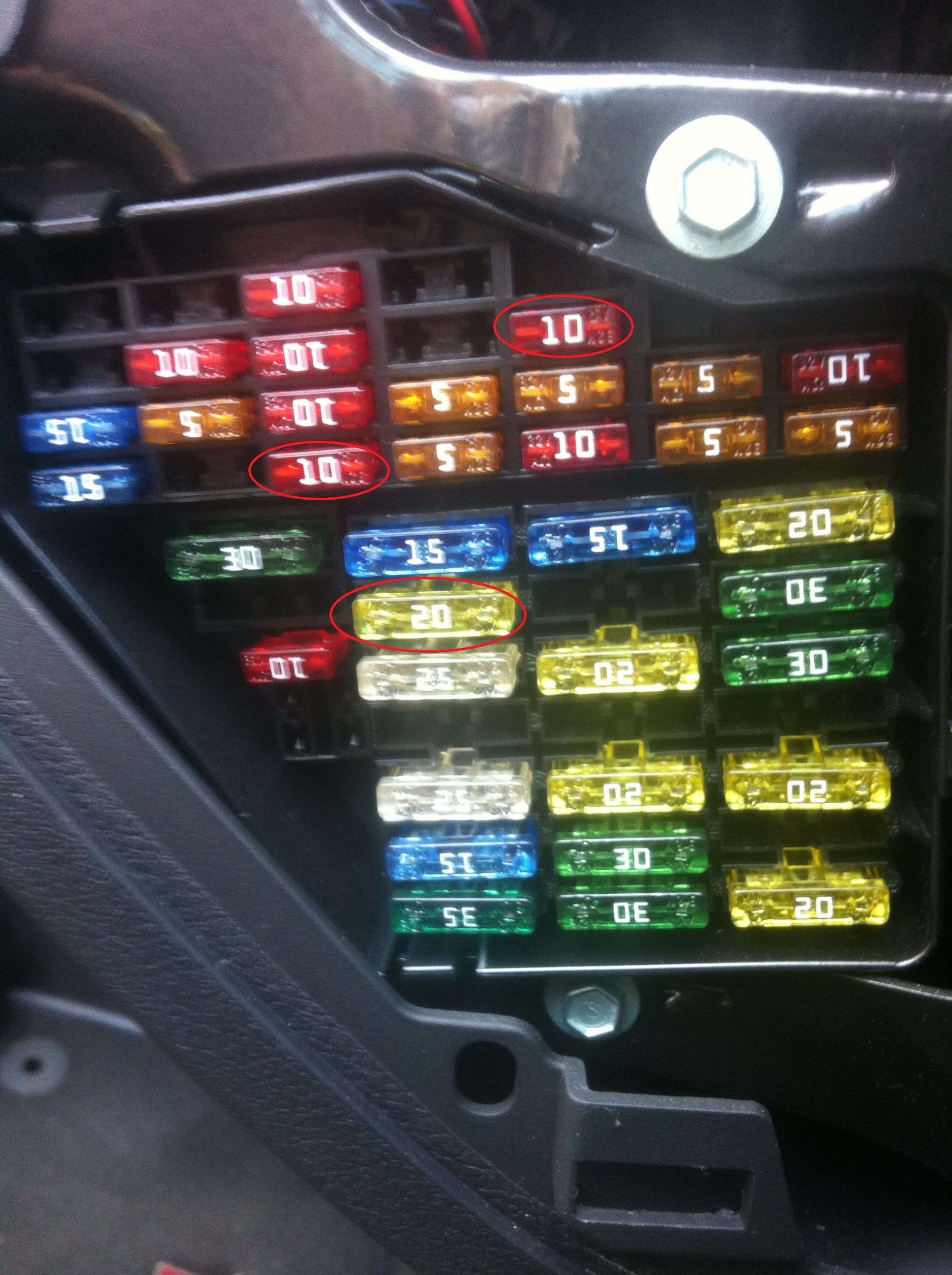

Ok so I pulled some fuses, not 100% sure I did the correct ones as tbh I've never done them before.
I tried number 5, 15 and tried 39 as well, the fuses looked ok but didn't make a difference apart from having to reset the time/date.
Were these the correct numbers?

Billy wrote:didn't make a difference apart from having to reset the time/date.
That's strange, if the CAN connections are faulty then the RNS-E won't read the time from the instruments but it should set its time from the GPS.
Looks like you're gonna have to take a look at the connections maybe. Best plan is to disconnect one device at a time - I'd suggest in the order BT, AMI, RNS-E and check with VCDS when connections to the others start working again.
The BT module is still my #1 suspect, is yours factory or retrofit? If it's retrofit then its most likely behind the glovebox which will be easy to disconnect.

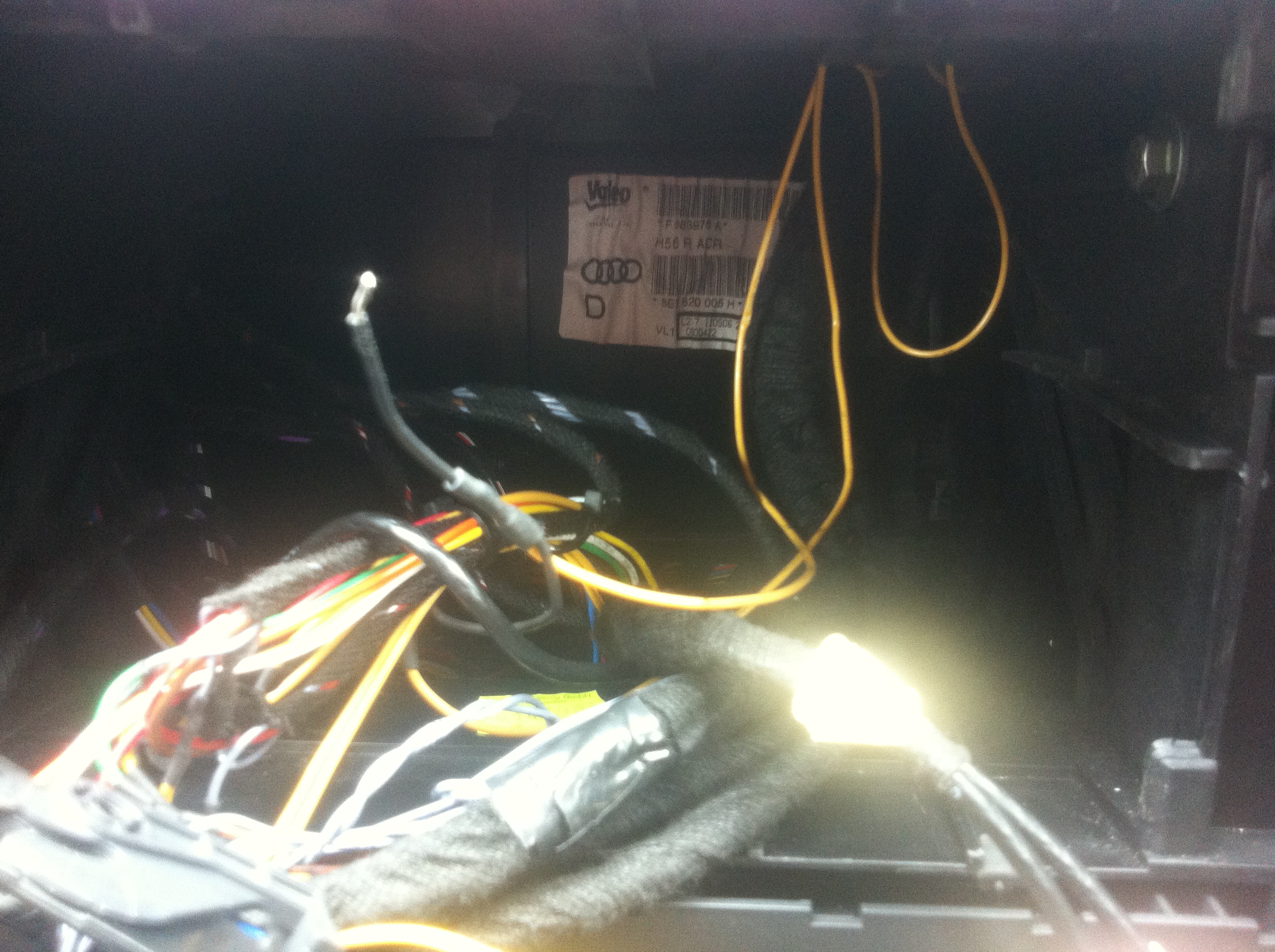

I had look at the wiring with RNS-E out and noticed this wire not connected to anything. Looks like it comes from the BT module and the SDS button on the dash.
Could this be the issue maybe and if so any idea where it should be connected?

Billy wrote:I had look at the wiring with RNS-E out and noticed this wire not connected to anything. Looks like it comes from the BT module and the SDS button on the dash.
Need to know what terminals that wire is connected to before I can comment - wire colours mean nothing.
Only thought is did pippyrips used to have a CANGate - as the SDS button would need to connect to that for it to function.
