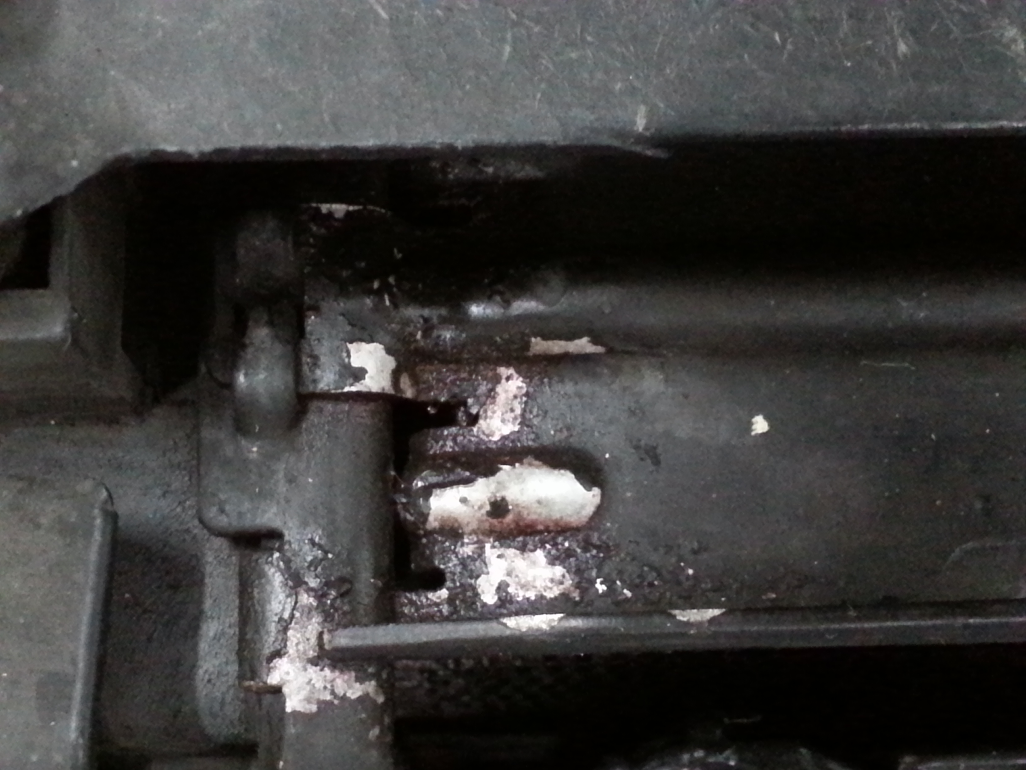

Hi all, have recently had the car serviced and was told about a leak at the top of my radiator drivers side. I haven't had to top up the coolant so it must only be a small leak at the top.
When the the rad gets replaced will the condenser rad or oil cooler get damaged? Should I replace those parts as well or will they come apart ok? Can anyone tell me if I also need to buy oil cooler pipes?
I've priced up the parts from TPS and it's about £1200 for the three parts. On the other hand, the garage quoted £800 for just the radiator and coolant - £430 for the rad and coolant and 3.7 hours for labour. Will it be any more labour to replace the condensor and oil cooler at the same time? Regards

Dont waste that much money.You can buy one on ebay for far less and have your local garage fit it shoul only cost a couple of hundred

I'm looking for a new rad too. Pressure tested mine and it has pinholes all over the place. Someone has used the dreaded RADWELD too. Pulled it last week, It's a fairly simple job to do and it and shouldn't damage any other parts. I just can't find a replacement part anywhere. Any suggestions welcome.
Re: Small leak on radiator RS6
I posted some part numbers (Valeo and others) for much cheaper high quality options; Nothing complicated about fitting a RS6 radiator. Shouldn't cost you more than £300 in parts and a couple of hours labour.

Part number 4B3 121 251E or F depending on VIN number. There was a slight modification to the cooling system during production that means that later radiators have an extra nozzle on or something.

Found it on the Valeo website dude. There a quite a few stockists near me so I'll make a few calls on Monday.
Don't forget to check for this difference in model years. Compare with yours before going to far into the dismantling.
New rad done, £216 from GT it's an identical part. It's an NRF as GSF were useless and said they couldn't get one from Valeo. I've used parts from them before and they always seemed alright. Thanks for the numbers though

General traffic only did one rad. The numbers on the old one were worn off so just had to go off measurements.
