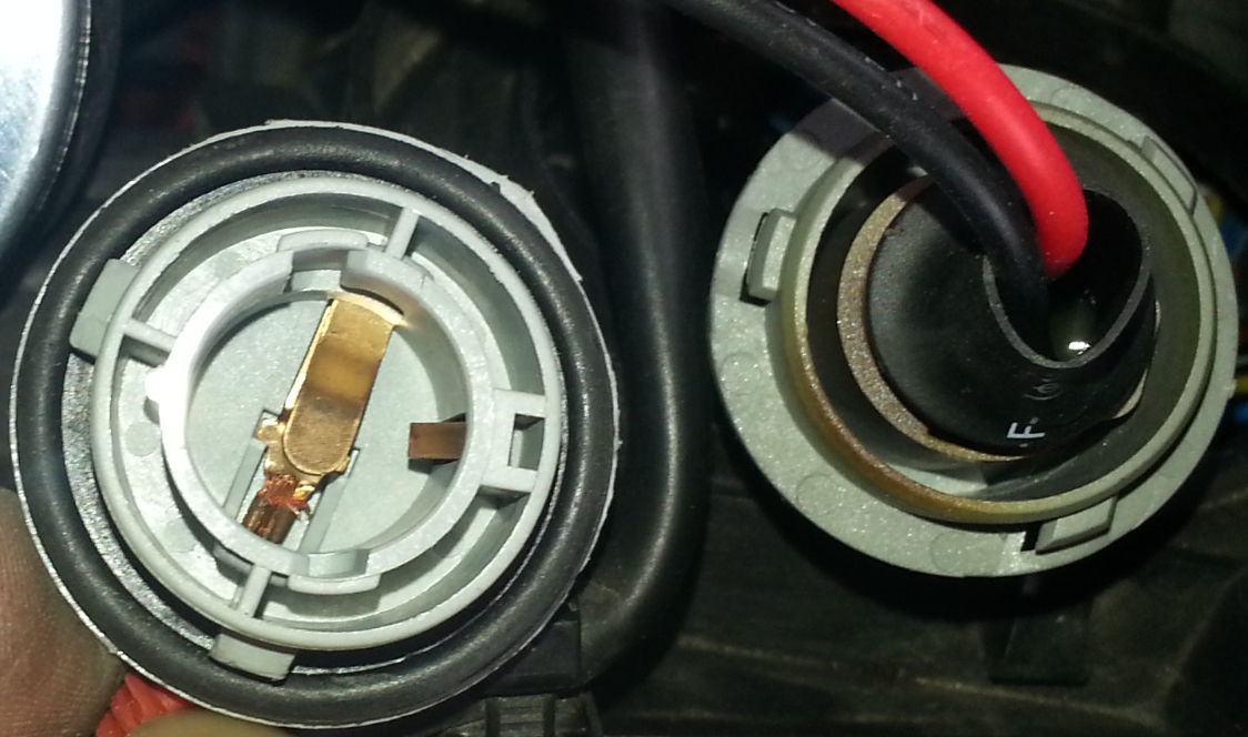

Having real trouble getting them to locate properly in the headlight.
The replacement unit only has two locating lugs, whereas the original has three and locates easily.
Also, it's nigh on impossible to rotate the bulb holder so the lugs line up as the bulb holder has to be rotated by almost 180 degrees from it's natural position, which is very difficult due to the wire into the bulb holder.
Off to try again.

Post by guffy » Sun May 12, 2013 6:16 pm
Got them installed, but not convinced the bulb holders are as secure as the originals, does look better though.

guffy wrote:Got them installed, but not convinced the bulb holders are as secure as the originals, does look better though.
Like I said they are off the shelf, they come with 4 lugs, if I trim 1 lug off it wont go in at all so I have had to trim 2 lugs keeping the ones that are closest matching to the OEM holders, the 2 you have locked in are secure, check back after a week or two and they will still be in place.
if you look through the front of the headlight you will see the lugs you have secured, if you think they are not secure then swap over the lugs to the other blank lug if that makes sense?

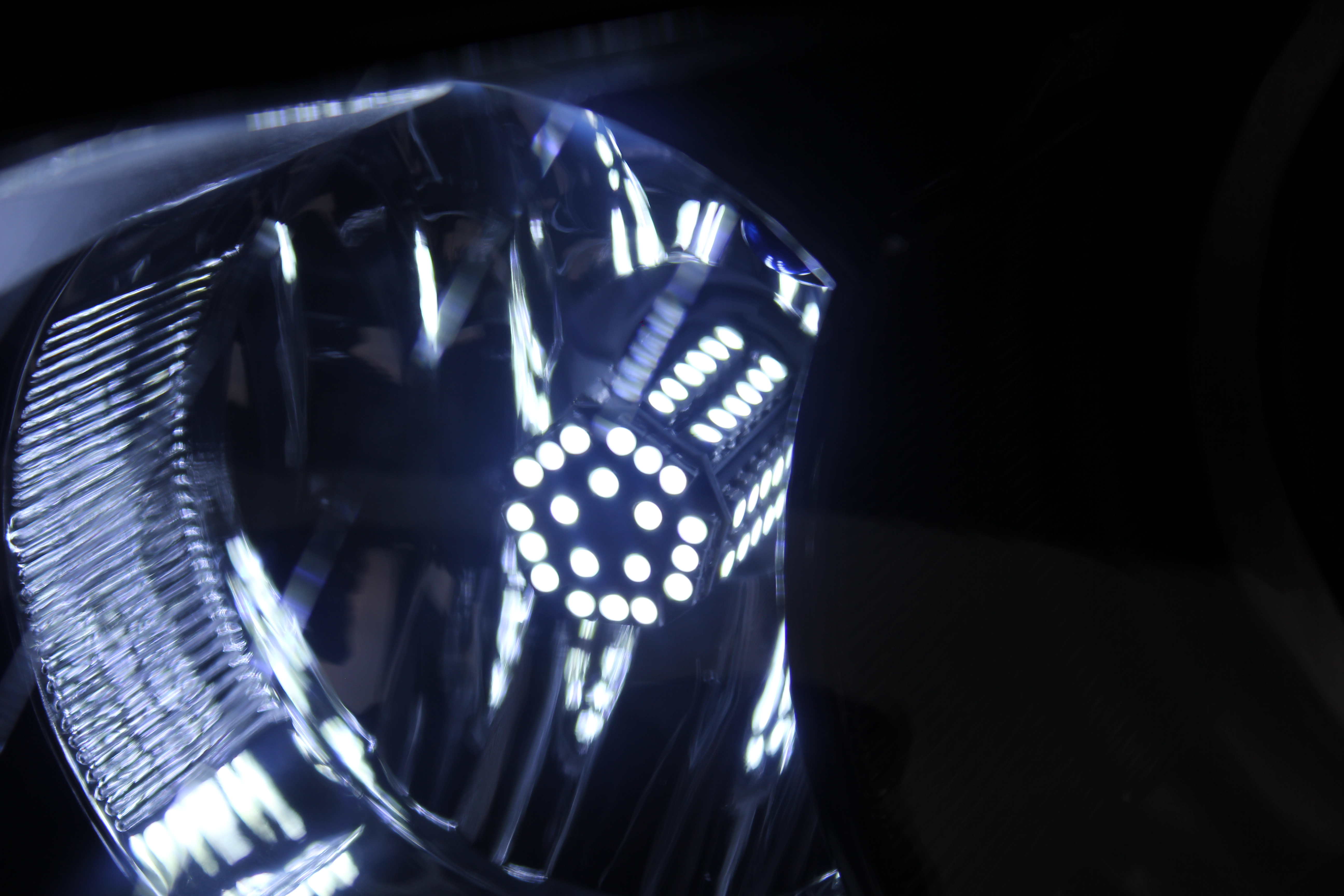

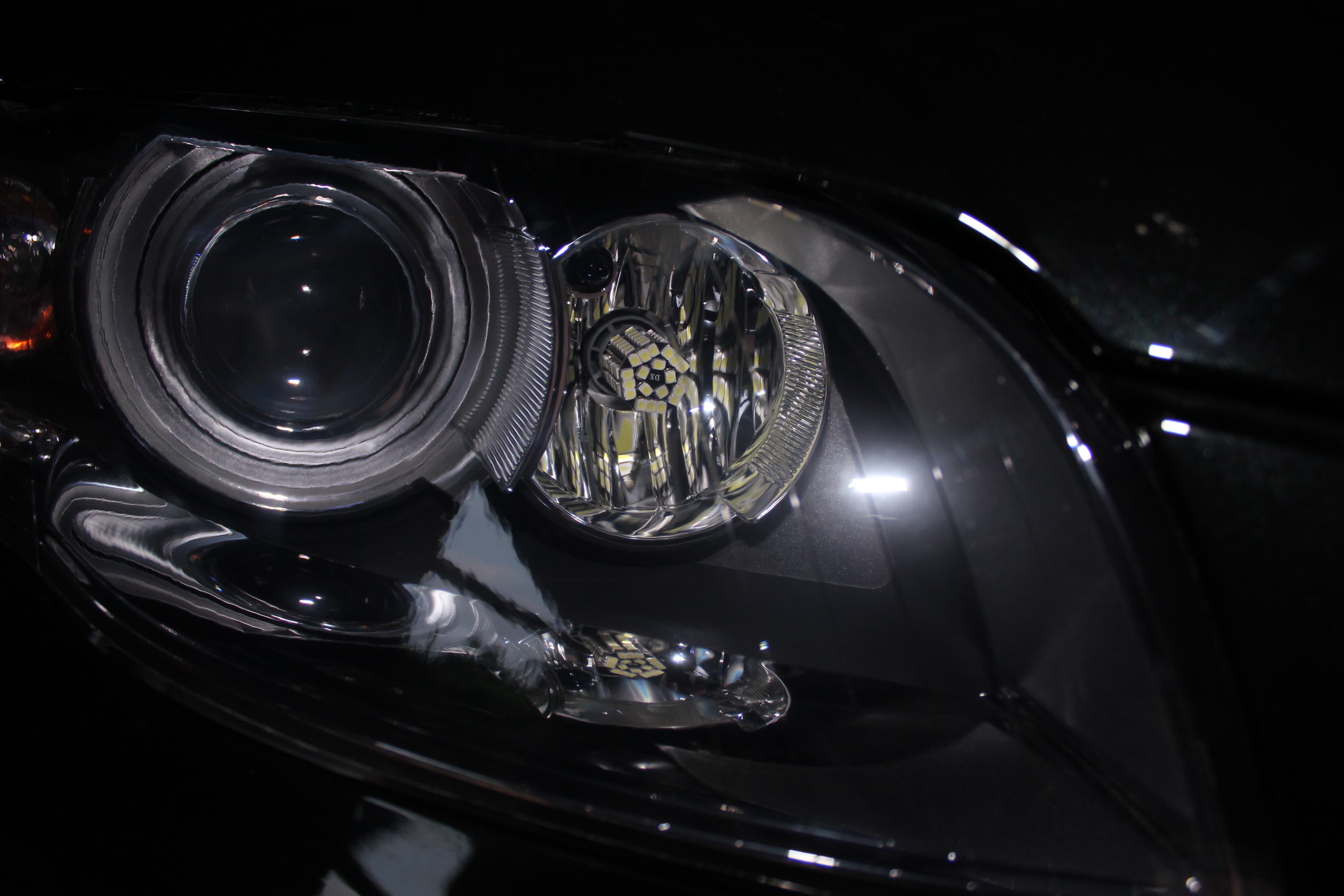

I fitted this kit to mine the other day and I am impressed with difference it makes over the PIAA bulbs (which were brighter than the std)
The LED is 80 smd and I believe it's this one below which Trups supplied as part of the kit. :thumb:
http://dx.com/p/1156-4w-400lm-80-1210-s ... tAod6TcAUA
Here are some shots with close ups..
P.S. Stock up on plasters as your hands afterwards is going to need it :lol:
