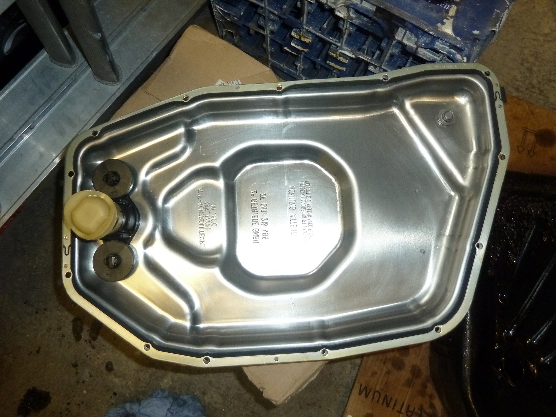

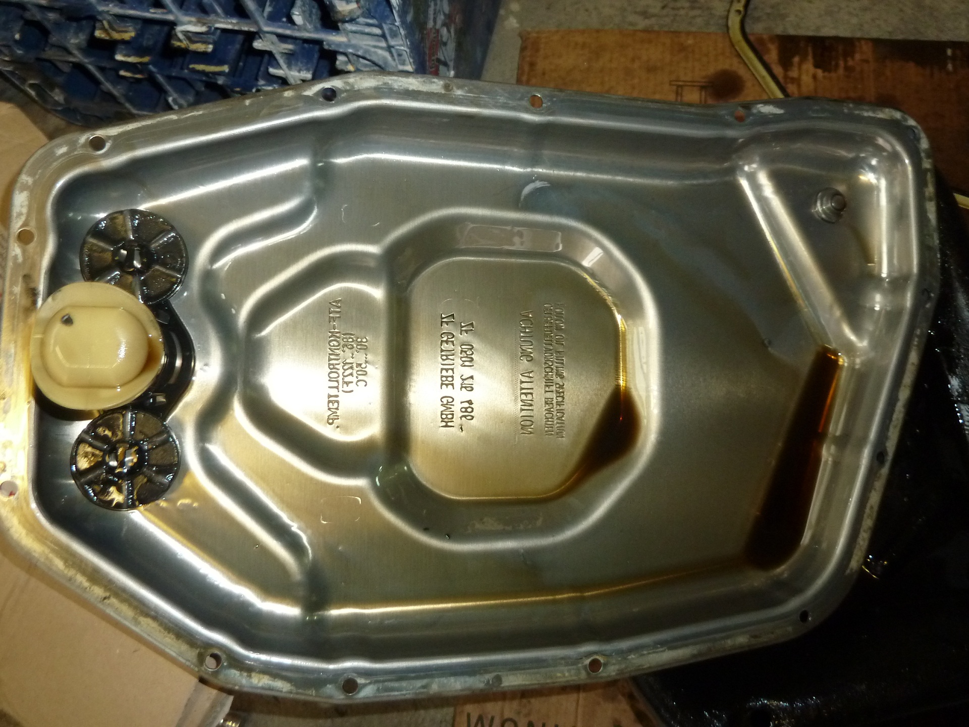

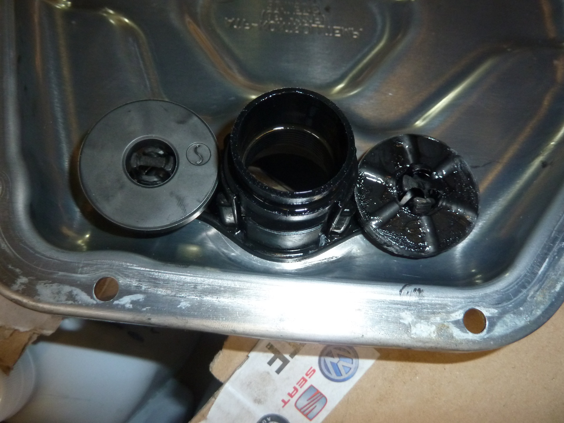

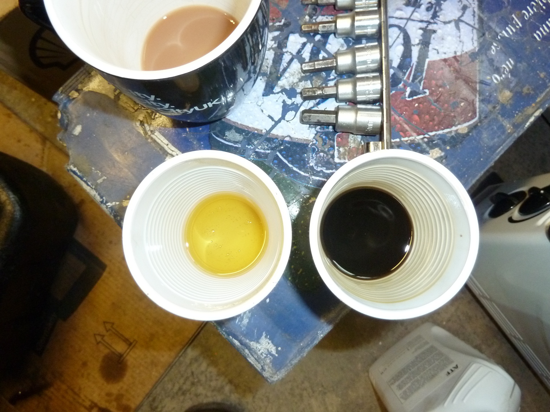

Chaps
Here's the photo's recovered from an abandoned Blackberry. Not at all retired as it got covered in oil.
New fluid on left, old fluid on right and a cup of tea.
New pickup/filter against old;
Sump upon removal, see the two magnets for picking up ferrous particles in the fluid;
Sump and one of the magnets cleaned up;
Sump fully cleaned and ready to go back on;
It's a simple DIY job. It took almost as long to get the thing up in the air and safely on stands, as it did to change the oil and make the tea. I's strongly recommend you all get this done, whether you DIY or GSI. As mentioned above, I had a sealed for life ZF autobox fail on a Range Rover TD6 a few years ago. An expensive out of warranty fix. It's now common practice to change fluid on these. Surf the RR forums for more info on these sealed for life boxes.
