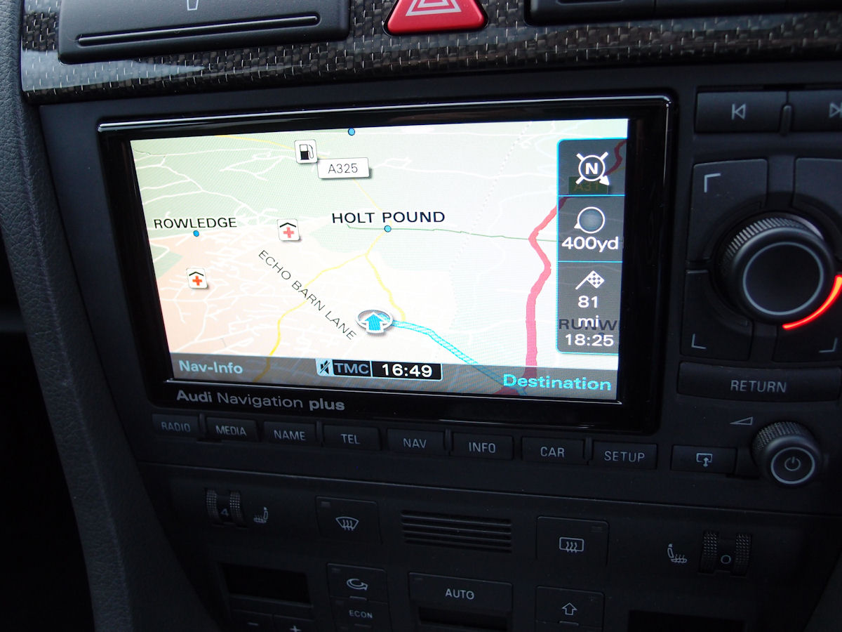

Sorry guys, I forgot to reply to your helpful posts. After a last minute decision on friday, I now have the very latest generation RNS-E installed. NHN took the unit out of his A3 to use as Guinea Pig and removed the front from the Ebay special I bought. After a bit of tweaking well in to the evening and headscratching, the car and head unit seemed to figure out that they liked each other and everything is working exactly as expected. Even things like turning on/off with the ignition only worked after the ECU etc and the E sat in there for a while.
The price killed me a bit but I don't regret doing it at all. Twin 32GB SD card capacity, beautiful screen, surprisingly informative satnav system that is quick and the sound quality is an immediate step up to my ears.
NHN says he thinks that me saying that the bass has noticeably increased is due quite possibly to the system not adjusting the crossovers to remover lower frequencies from the speakers to let the Bose sub do all the work. There is a wire spare and he wants to put that back in to see if is the case. I have to say that I am blissfully happy with the noticeable increase in bass as it is, think I don't need another sub at all as it sits.
He soldered in every single cable I think to get the best quality connection and reduce the space needed behind the unit for all the convertors, his work and attention to detail are flawless. He would have been quicker on the conversion but he openly said that he gets to do very little A6/RS6 work due to the forums that he is known on not having many on there. You wouldn't have known for a second.
Current:

I was expecting to be having that fitted on Friday morning, but Nigel yanked the last gen RNS-E from the dash of his A3 and fitted that. Basically, this - http://www.vag-tec.com/audi/a3-1/audi-r ... on-radio-3
The front was A3 so in order to make mine up he took off the fascia from the Ebay one and transplanted it on to the newer backend.
Currently, it looks like this:
Before you hate, the gloss black screen face looks better in the flesh and I had the option to not use but I left it with the gloss surround as it visually differenciates it from the previous gen.

Tired so not going in to detail but this one just does things better honey:
Main differences compared with the earlier RNS-E 2G
* Improved graphics & graphics processing
* High Resolution LED screen
* Compatible with Latest RNS-E 3G AMI iPod Kit
* 32Gb SD card compatible
* Faster switching between menu's and re-calculating routes
I decided to go for it as the latest gen one looks a hell of a lot better graphics-wise, the screen is a nice leap up and it can take much higher capacity SD cards. All of that and pretty well nobody has gone this route with our beasts on this forum. When I get the other one back (which has a A3 front on it currently), it will be coded for an A3 and I will sell it as one.
