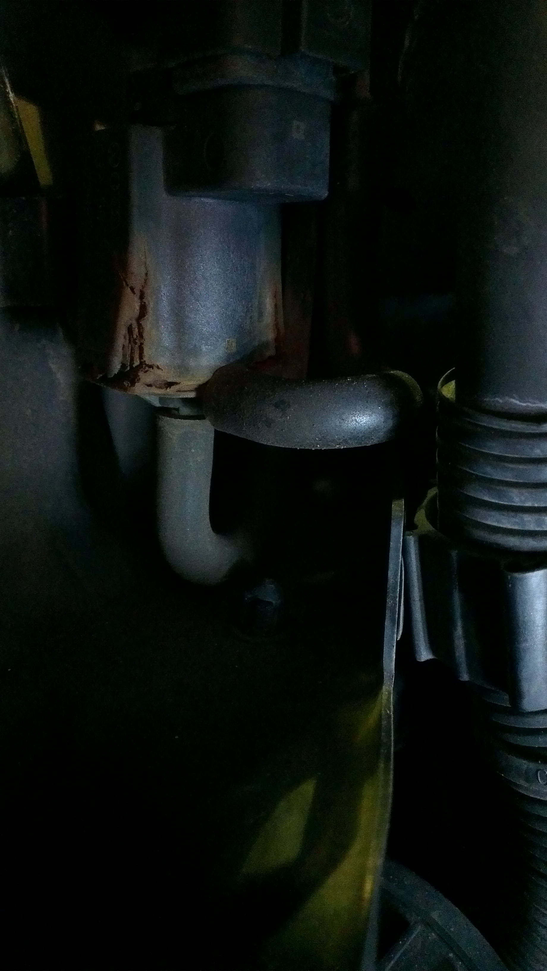

5. Then the end of the pipe diss-connected from the aux rad in step 3 is re-connected to the metal existing pipe that lives behind the metal bracket, use an extra clip from the redundant aux pipework to ensure a good seal (pic 1 below), re-fix all aux rad brackets etc and zip tie the water pipes to the right to allow space for the new ducting. You can see how the existing pipe has been routed in the 2nd and 3rd pictures below:

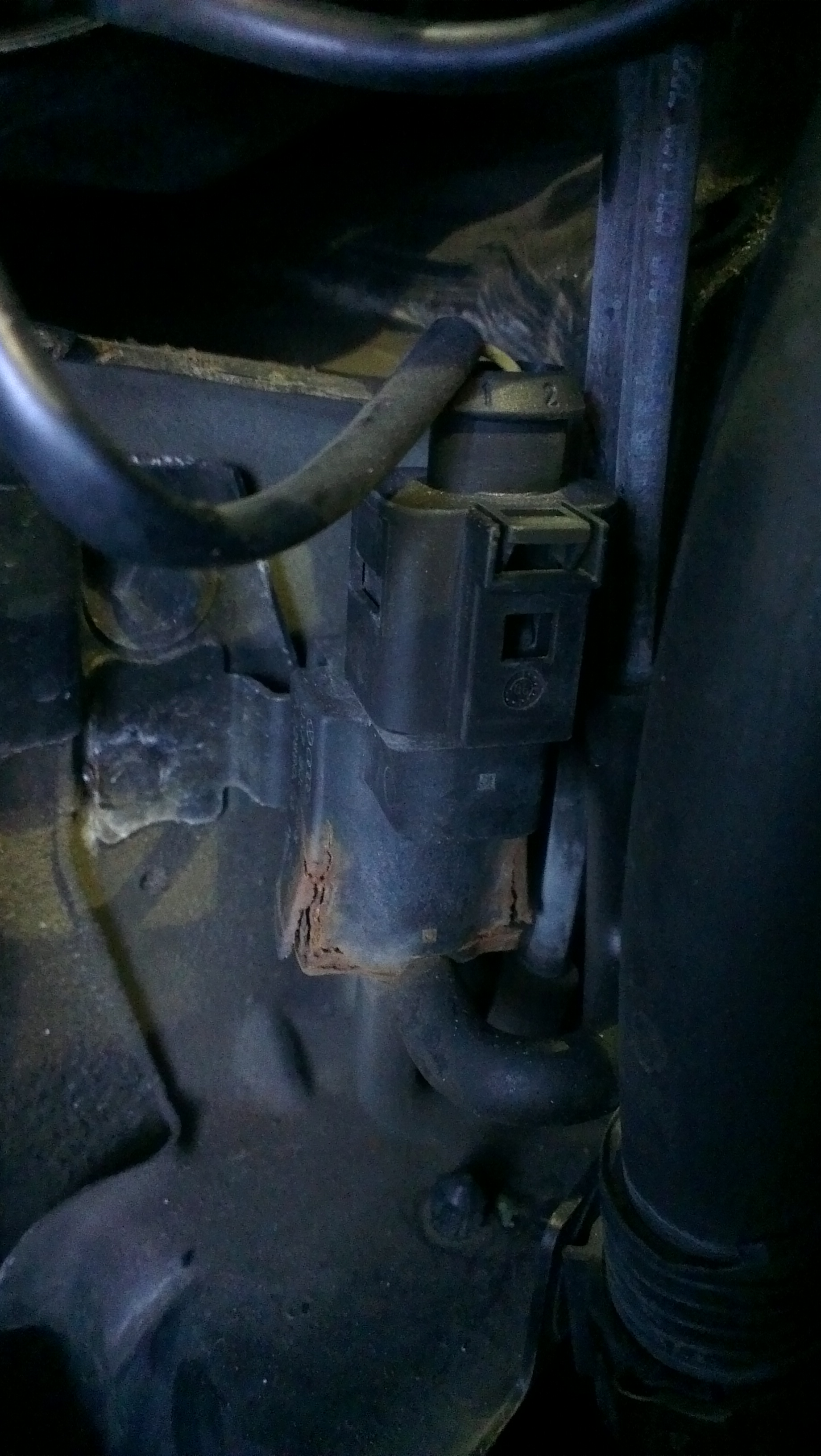

when the aux rad was out i noticed the solenoid for the air box flap was rusting and had started to split open, maybe enough for a vacuum leak even though i had already blocked of the vacuum pipe at the top where it connects to the flap a couple of years ago when i de-flapped the air box.
the pipe on the side goes up to the air box flap, the pipe on the the bottom is the source of the vacuum, i don't think it would be impossible for it to rot enough to cause a leak.
so i pulled the pipe of the bottom and have plugged that as well just in case.
maybe something for people to look out for.
