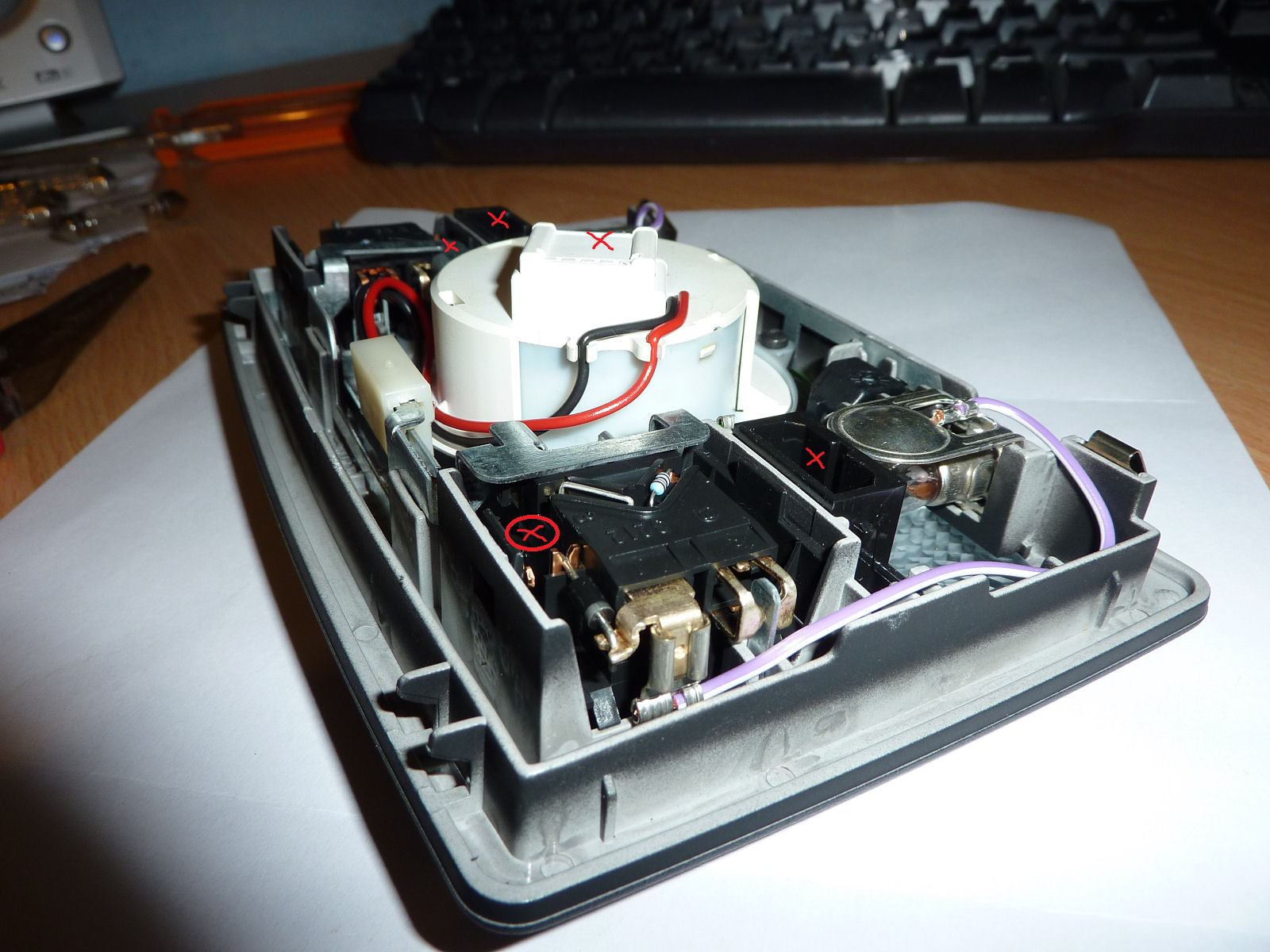

Ok, sod work, again....... I at least turned the ignition on but didn't start the car. Pressed the left toggle button on the display and it cycled through without error. I decided to pop out the front light/sunroof controller so I could see what bulbs wound be needed for that. A picture of the unit is below. X indicates a connector and the X with a circle around it is one that was a little bit fiddly to get out from that area to allow total removal of the panel:
The 2 little BA9 bulbs are a bit fiddly to get out.
Just for reference for people, I have done an image showing the types of bulbs found in the roof lining and the front footwells of the C5 avant. I haven't checked the door bulbs or looked for other yet but will update as/when:
