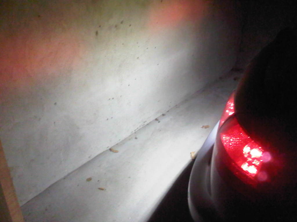

They are a bit stupid bright at the moment but here is a picture - the reversing lights are NOT on & the only reason I may keep them is they might help when reversing...

Wow that is bright,the police won't miss you at night lol

Aren't they ! Have already ordered some more modest bulbs for them as only 2.99 for the pair - the existing ones have a battery of 16 LEDs on each !

Rudolph going backwards.
