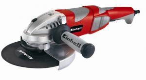

Re: anyone changed a starter motor???
- Attachments
- rtag_230_1_haakse_slijper_230_mm.jpg (7.16 KiB) Viewed 1847 times

probably one of the secrets beside the gearbox out without taking out the engine...which are many rumours about, but never told how to...
