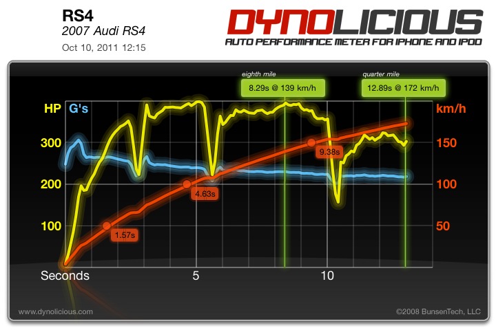

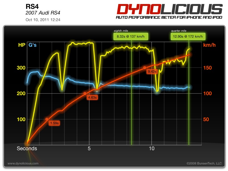

i want to start saying that i am a little lucky = i am working for the biggest spare parts in romania and the parts are easy to find for me.The relevance for that is that a stock clutch for me is 200 euro (and we have 120 garages) and last year after i smell for the first time the burn clutch i was thinging - ok - now i will launch hard to kill the clutch and to replaceit.After that i think i was hard launching the car for maybe 60-70 times and the clutch is in very good shape(one of may friends was responsable for that little clutch burn).
For me the best way to do it is with 4500 rpm,sidestep the clutch and sinchronyse gas with the moment the clutch is engaged.Launching with lower rpm is consistent lower but not tu much,only with 0,1 - 0,15 seconds to 100 km/h,
I think the best times you will see will be with 5,000 rpm in that way - keep your foot to the clutch go from iddle full gas to 5000 rpm and then release the clutch( sidestep).Dont do that if you love your car!!!!!!!! it is brutal and is posible to damage the car.I was tryed that method but my clutch is a little to old for that and it was a liitle slip and the times was equal to 4500 method.
i posted 2 graphics from dynolicius(*very accurate as tested in magazines and sites).12.89 S TO 1/4 MILE AND 4,63 0-100 KM/H WAS THE BEST FOR ME.Is true that was with new michelin tyres,new air filter,new oil and all vacuums fixed in 15 Celsius(60 fahrenheit).In two days i was making 10 tests with times from 12,89 to 13,02.
In that 15 C the range was 12,89 to 12,92.
My car is 72,000 miles, stock beside off Miltek,100 cels cats but stock map.
This week i will clean the valves(never cleaned and i will remapes with Revo stage 2.After that i will post hopefully some 12,6 times...
