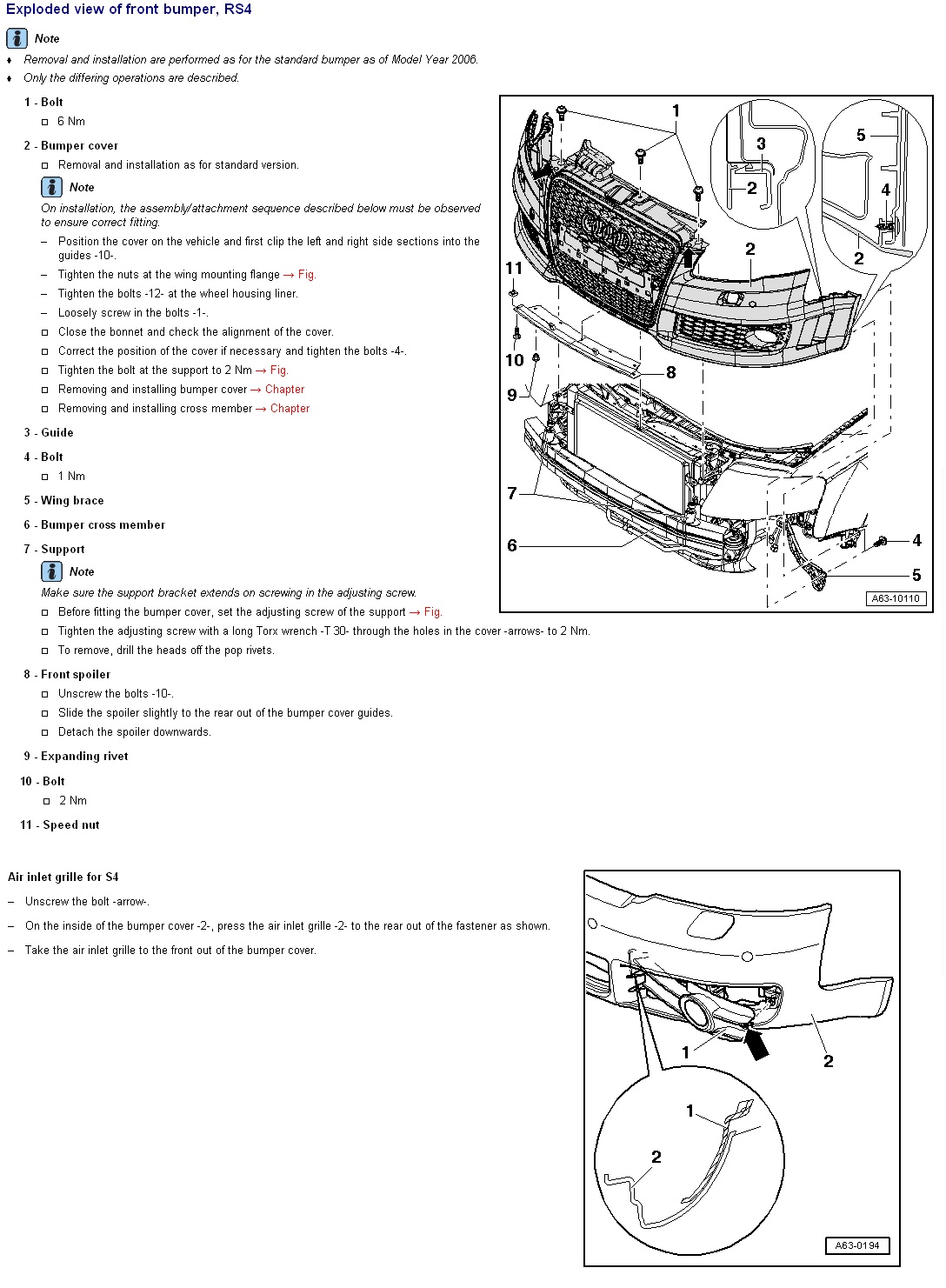

I don't know if this is useful or confusing, I also have some more specific stuff on bumper removal and refitting.

Thats what I thought.
I was going to post it days ago, then I was thinking it's confusing but now peeps here seem to be serious about doing this to their cars, so I thought I would give the info I have got.
