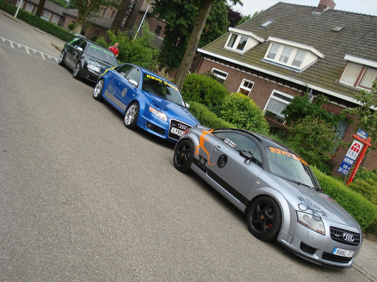

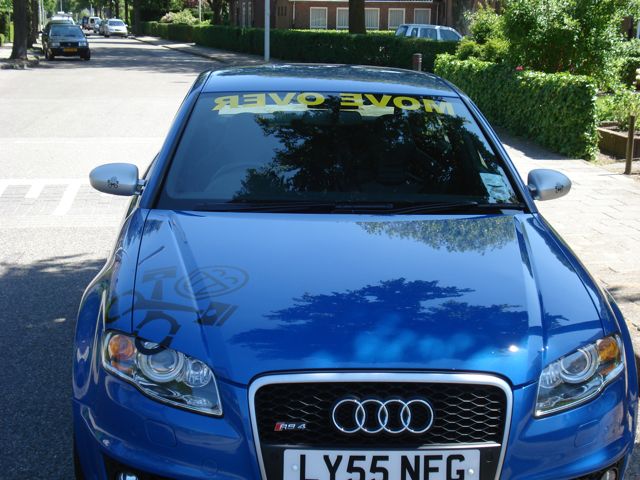

LOL, love the sunstrip.
Surely plod have given you some gip over that?

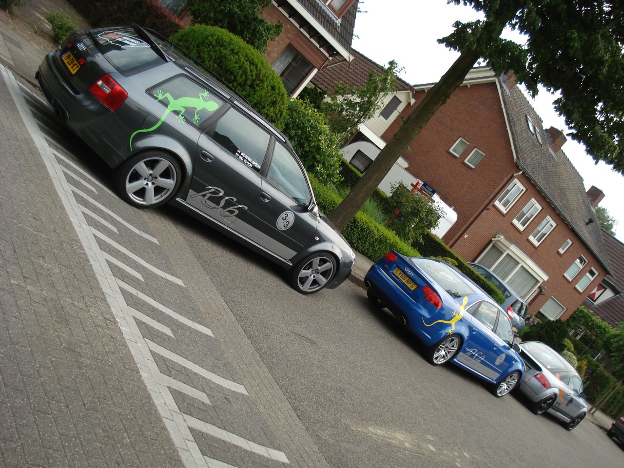

Had it on for le mans last year for i bit of fun as well as theseP_G wrote:LOL, love the sunstrip.![]()

Loving the sun strip!
Is yours an ex-press car, (being a 55 plate)?

jeez, the plod must love you three - i like it though

No i think it was a dealers car then 2 private owners then me only had 13k when i bought it a year ago now has 27k a year later.Steve_C wrote:Loving the sun strip!
