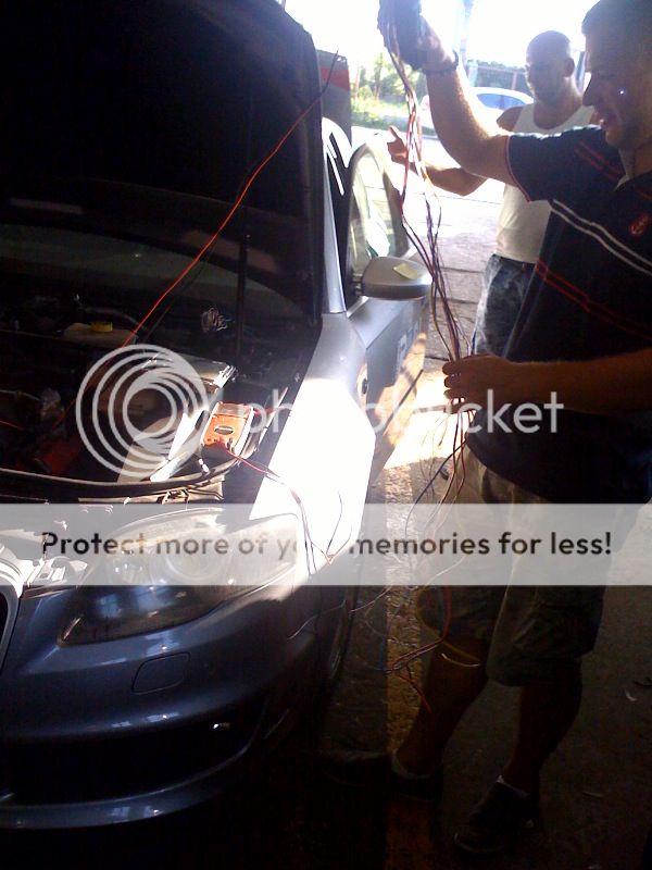

I`ve finished fiting a system to my rs4. Waiting for the re-filling equipment to arrive so I can fill the bottle .

What details do you need ?
Single nozzle ,progressive pulsed delivery. 25 hp jets for starters. System should flow enough for 100 ish hp.
Wizards of Nos system .
Routing wires :
More wires :
