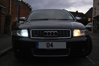

For info, I fitted the LED sidelights tonight (well, one...), and I'm really impressed. I managed to break one of the LED units as I was putting it in, so at the moment I've got one LED and one regular bulb!! Means I was able to take a pretty good comparison picture though!
I haven't got my xenons on here, but the LED matches the white light of the xenons a lot better than the old yellow sidelights. It just looked wrong to me having yellow sides & nice white xenons.
For anyone that's reading this who's thinking of replacing their bulbs I'll add my experience: I had to remove a piece of cowling on the passenger side (easy - no screws involved), and what I think was the air intake for the cabin on the driver side, (again, pretty easy, but slightly fiddly to replace). Once these were off it was just a case of unclipping and removing the rear cover of the light cluster, and pulling out the bulb holder. This is where I definitely agree that small hands are useful! Not a hard job really, probably 30 mins for the first time you do it, and that's if you're going carefully and are a bit hamfisted like me!

marv wrote:For info, I fitted the LED sidelights tonight (well, one...), and I'm really impressed. I managed to break one of the LED units as I was putting it in, so at the moment I've got one LED and one regular bulb!! Means I was able to take a pretty good comparison picture though!
The same happened to me. When I was twisting the bulb into place the top part came off. Ultraleds replaced them no qualms. Send them back.
