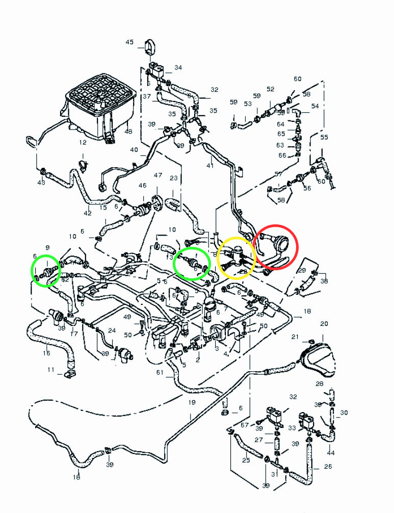

You should take it up to about 15 psi. I had leaks that showed themselves first at around 12-13 psi. Mine also drops to about 5 psi in 15-20 seconds. I also have a fair amount of air coming out from the PCV breather (red circle in the picture). A common problem is leaks in the spider hose (yellow circle) and the two none-return-valves (green circles). I will change mine and see if this makes any difference.

Dragging this one up again following a pressure test today to diagnose a leak. I don't normally quote myself, but it seems I have been misunderstood (even though on re-reading, it makes sense).Blue_Thunder wrote:And how much pressure is lost through the PCV breather? I'm sure when i've tested mine in the past not much at all came out, but when doing it last weekend I had to hold my thumb over the PCV breather pipe in order to allow the system to hold pressure.
I'm well aware you need to block off the bit on the side of the Y-pipe, I was referring to the PCV breather, the black plastic thingy which usually attaches to the Y-pipe (circled in red above).
I permanently lose pressure out of this when pressurising the system. The only way can get the system to build any pressure is to cover this up. Surely this isn't right??
