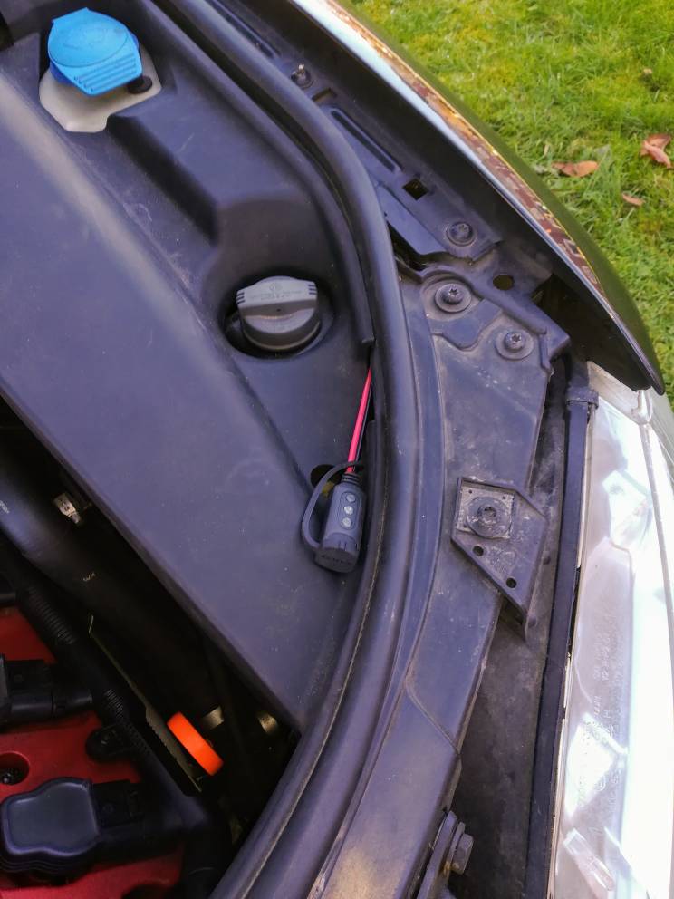

Got myself a CTEK battery charger with the comfort bits and was wondering if any of you have permanently attached the charge lead to your car?
Picked an indicator lead up for £2 on offer from https://www.jsaccessories.co.uk/pages/h ... h:products
as one of the stores is only round the corner :)
So, any ideas for a permanent fixture on the car? Don't mind extending the lead etc..
Any thoughts appreciated
Mike

I have one of these chargers and as the battery is in the depths of the boot (C5) I fitted the ‘eyelet’ connector to the terminals but had to slightly enlarge one of the holes to fit over the bolt, bought the extension lead also to bring out behind the side panel and then just connect the charger unit when required.
Works a treat without having to access the battery again, it’s a good charger as well

Thought about this too as im always doing diagnostics/coding to my car and the drain is huge.. Was thinking about having the terminals extended to outside of the car through one of the lower grommets in the boot and have the connector just by behind the rear valance on piece if velcro or similar.

You can run the crock clips to the terminals in the engine bay and run the cable out of the bonnet. Alternatively if you have the option pack that has the cigarette lighter in the boot you can get a connector to plug in and run the cable out of the boot.

This is what I do. Clip on terminals under the bonnet then close the bonnet. Takes a few seconds to set up or remove.

My RS6 has the lead (not crocs, the first one in the link you put up) permanently connected directly to the battery and coming out under the back seat so that I can have it coming out under the rear passenger door. I had to extend the lead.
The M3 has the same lead coming off the battery terminals and I chuck the CTEK in the boot and close the lid on the cable.
Both are locked all the time when on charge.

Fitted the indicator lead this morning...
Extended the cable a bit using 18awg wire and jubilee clipped the connectors to the charging posts.
