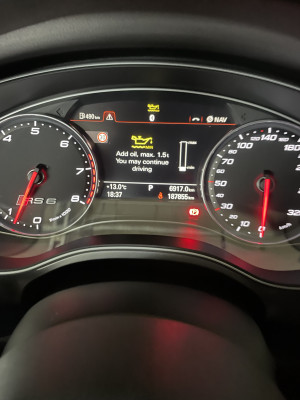

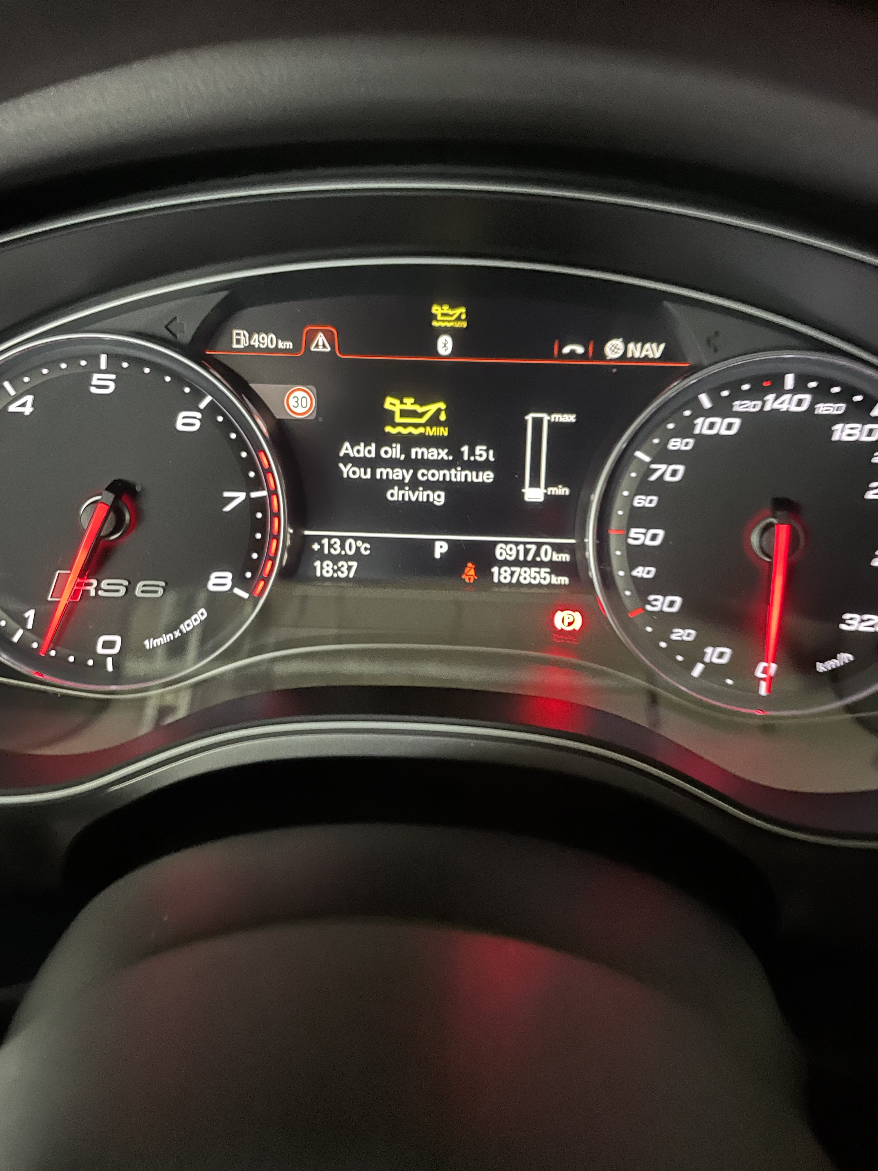

Hello, recently got a warning light, adding 1liter is enough I think?
Plus engine should be cold right?

Just add 1l first either hot or cold. Allow engine to warm up approx 2 mins for the guage to show new level. Check the reading and add a little more if need be. Recheck after after few hours once oil has setled. Probably need to do the warm up again with these silly digital dipsticks

Thanks, added 1liter it’s not max but it’s ok
