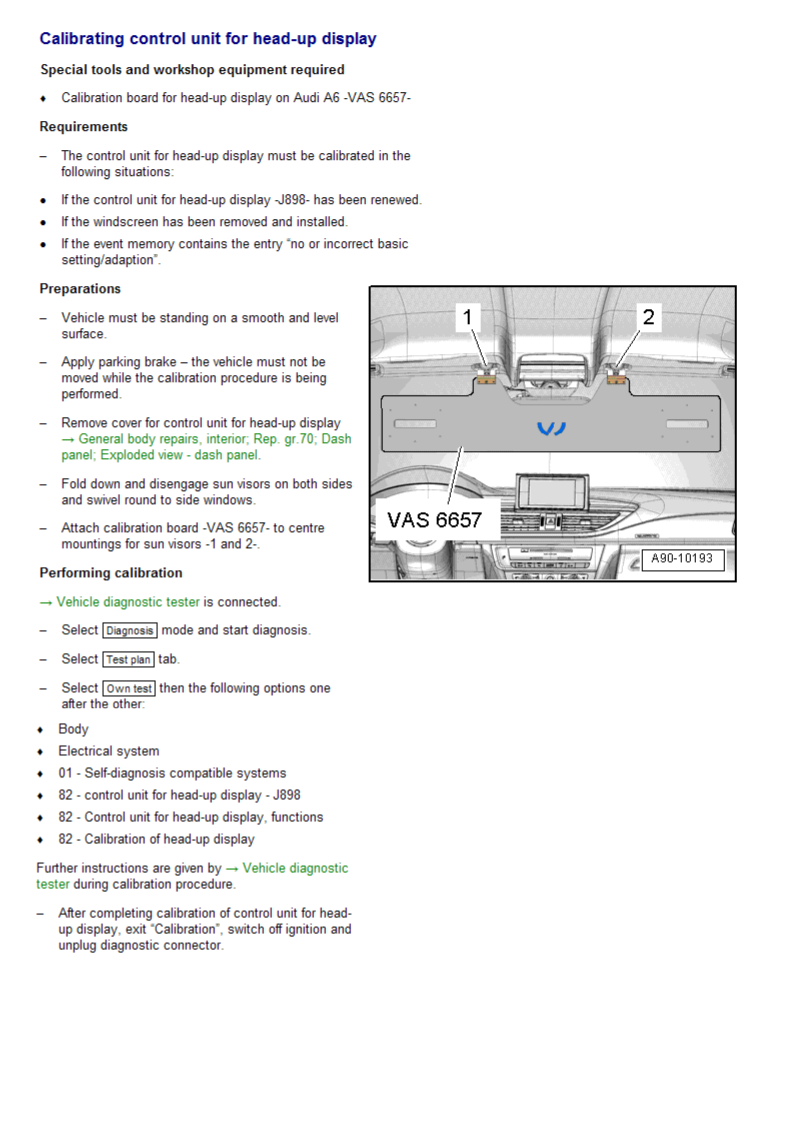

If it is a mechanical misalignment issue then the posts suggested may help checking for that (?).
ELSA win shows the following for calibration (looks like a trip to the dealers):
Strange that it would misalign all by itself; maybe previous owner replaced windscreen and didn't go to Audi for full recalibration(?)

Hi thanks for this info, it has had a replacement screen in the past, so Im hoping thats the cause.
My local dealer admitted they dont have the calibration tools, have never done it before and dont even know of the subject.
