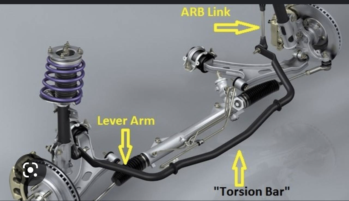

Thanks for mentioning that, I definitely going to Audi dealer, that I have that noise and point them about that it could be drc refill time or these arb links. Or should I not mention them anything just tell that I have that knock sound, I can show on a video
P.S you mean those arb links in a picture I posted?

Post by morski » Wed Oct 19, 2022 10:29 pm
Yes those are correct. As you have DRC part no is 4H0411317C. I try to use a decent brand such as Lemforder, Febi, Meyle
