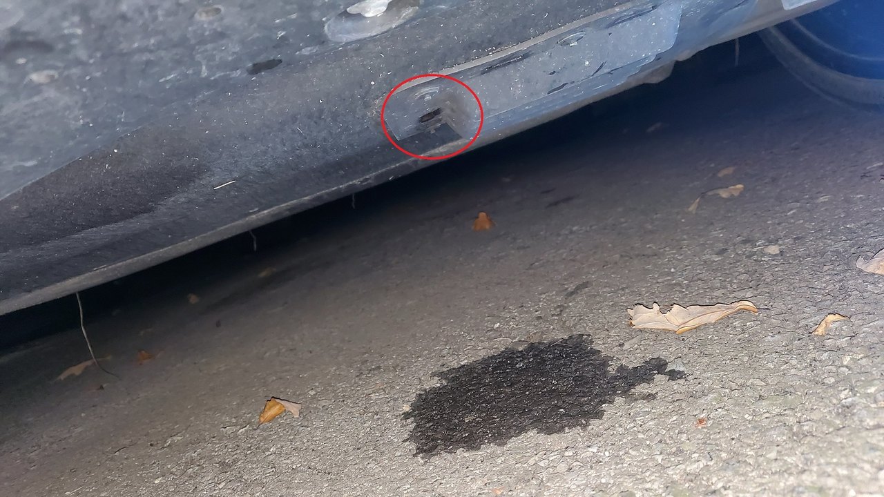

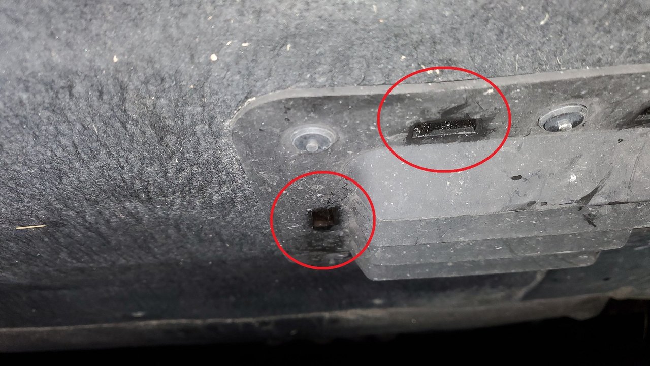

Hi,
Today I just noticed a bad coolant leak under my RS6.
This leak occured after 2 days without driving the car (yesterday wasn't there I'm 100% sure) so it seems that letting the car cold for a long time cause it.
I'll call my dealer monday, my car have warranty, but I'm worried. Do you know what it coups be? Waterpump?
The liquid is dripping from a small rubber grill under the car (see attached)
My RS6 only have 4 years / 60'000 km :cry:

Yes sure, it's purple with chemical smell and it doesn't dry from floor.

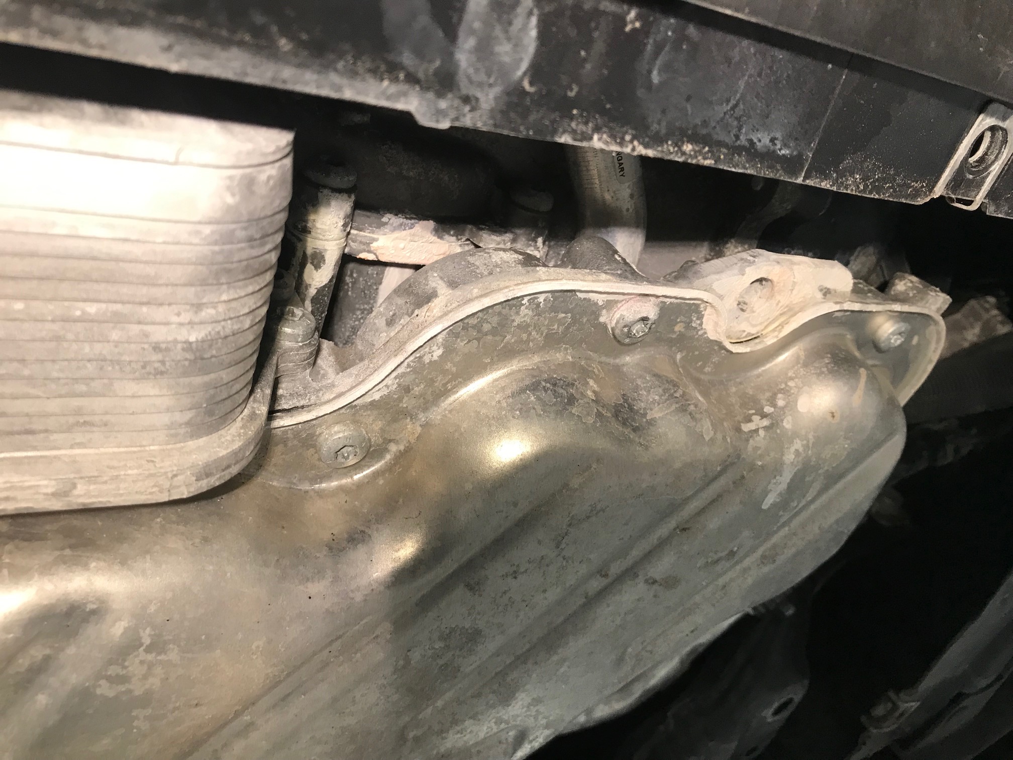

There's a common issue with the water pump housing leaking, so check for coolant crusted around the water pump. I had the same on mine last year at just over 3 years of age.

Just read the document attached above and the indication of coolant traces on the thermostat housing align with what was found on mine as per the attached photograph

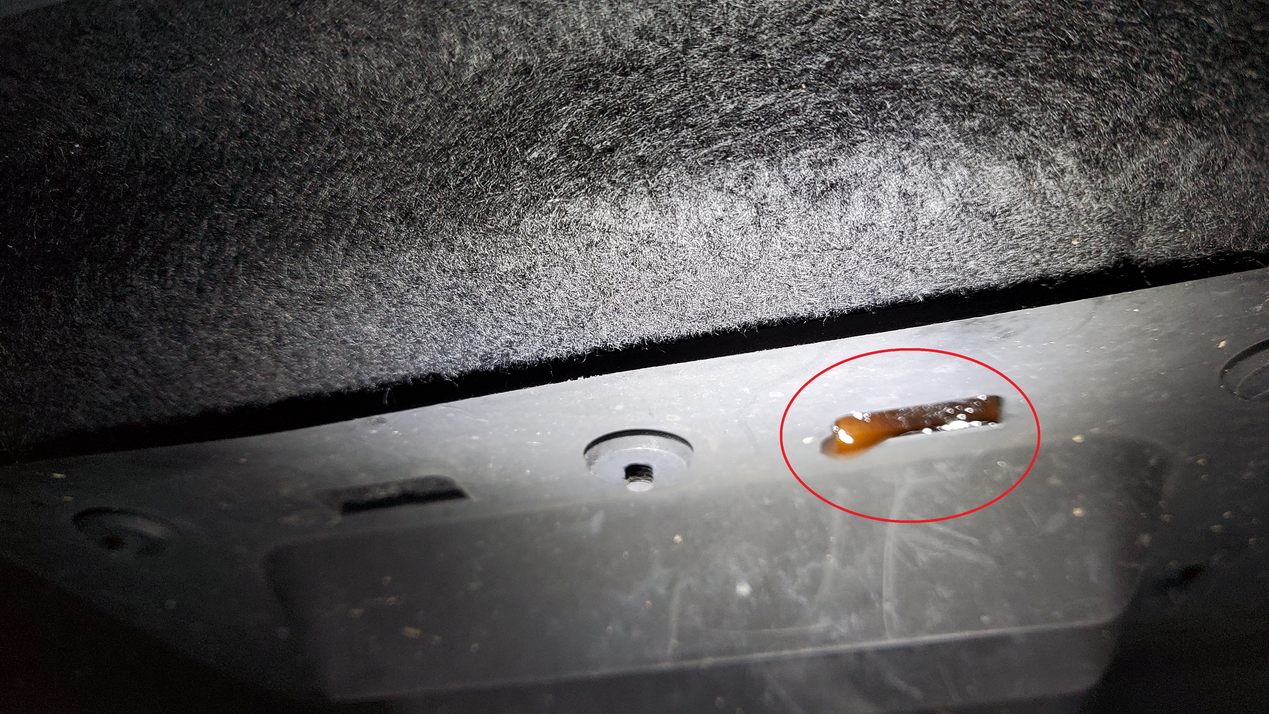

So it seems that my car do lose coolant ONLY if it stays long time without drive, more than 24h.
All the past week, I drove my car everyday and I didn't had any leak (no missing coolant, no coolant spots on the floor).
For try, I decided to let my car in my garage for all the weekend. Yesterday, I looked under my car after about 24h without driving --> no spot
This morning i checked after about 36h --> leak started! A spot on the floor and some coolant leaking from a hole under the car...
I'll leave it thursday and friday to the dealer for check/repair under warranty, but I'm really affraid that they can damage/scratch misallign something as they will have to take off the front bumper of my car -_-
