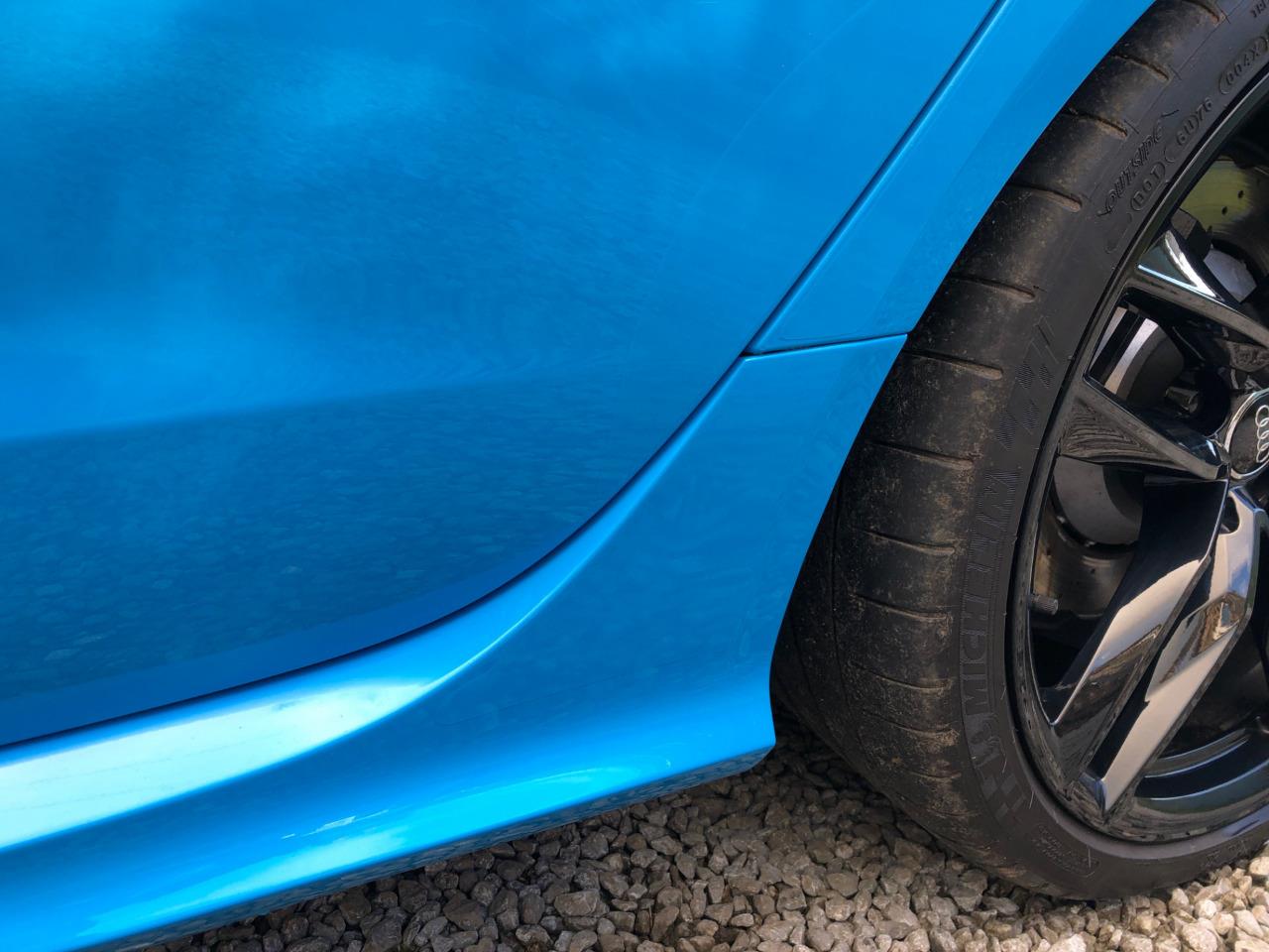

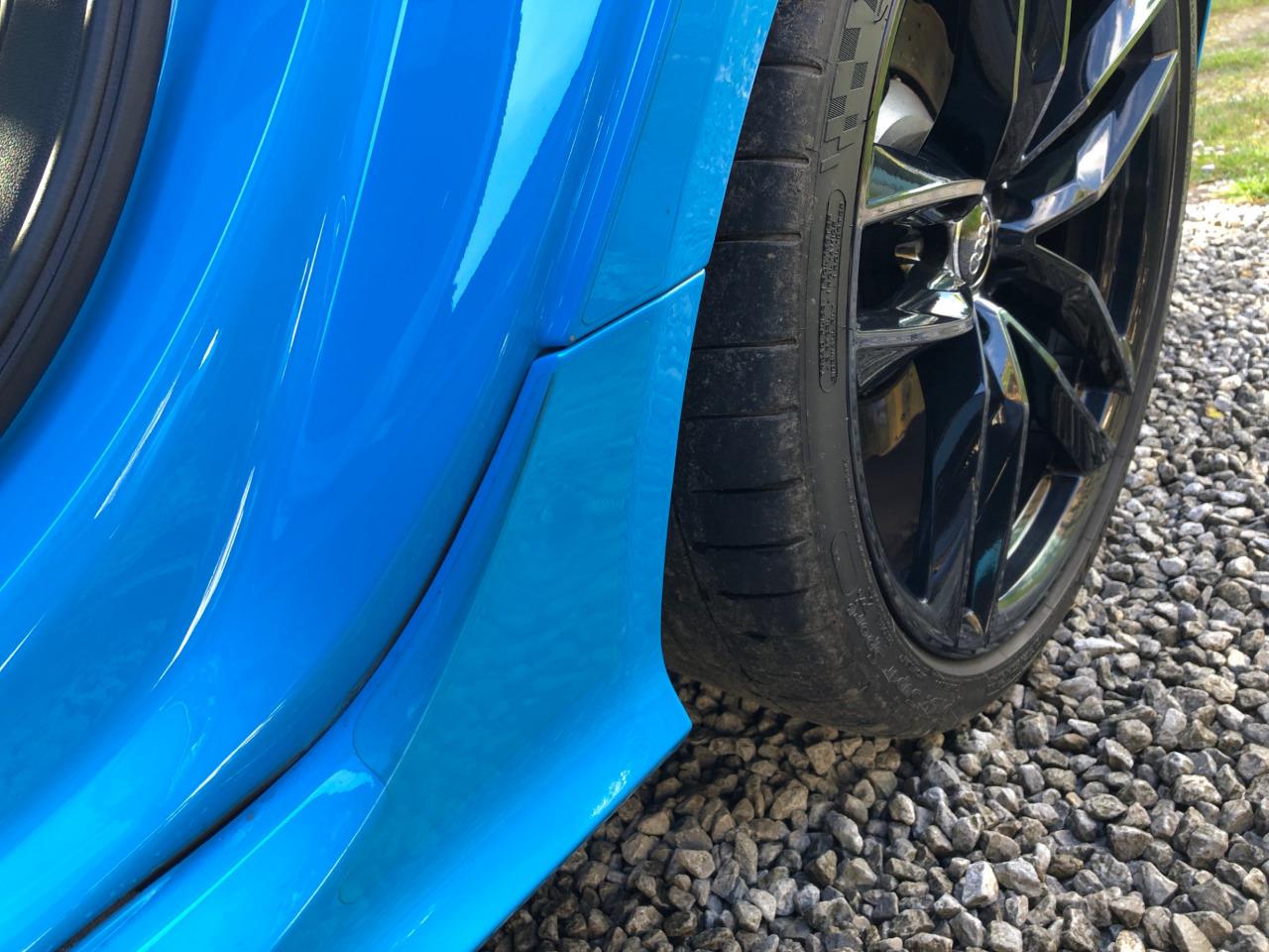

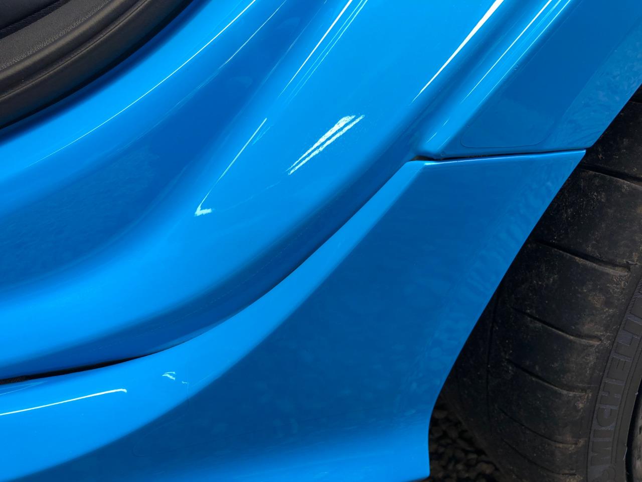

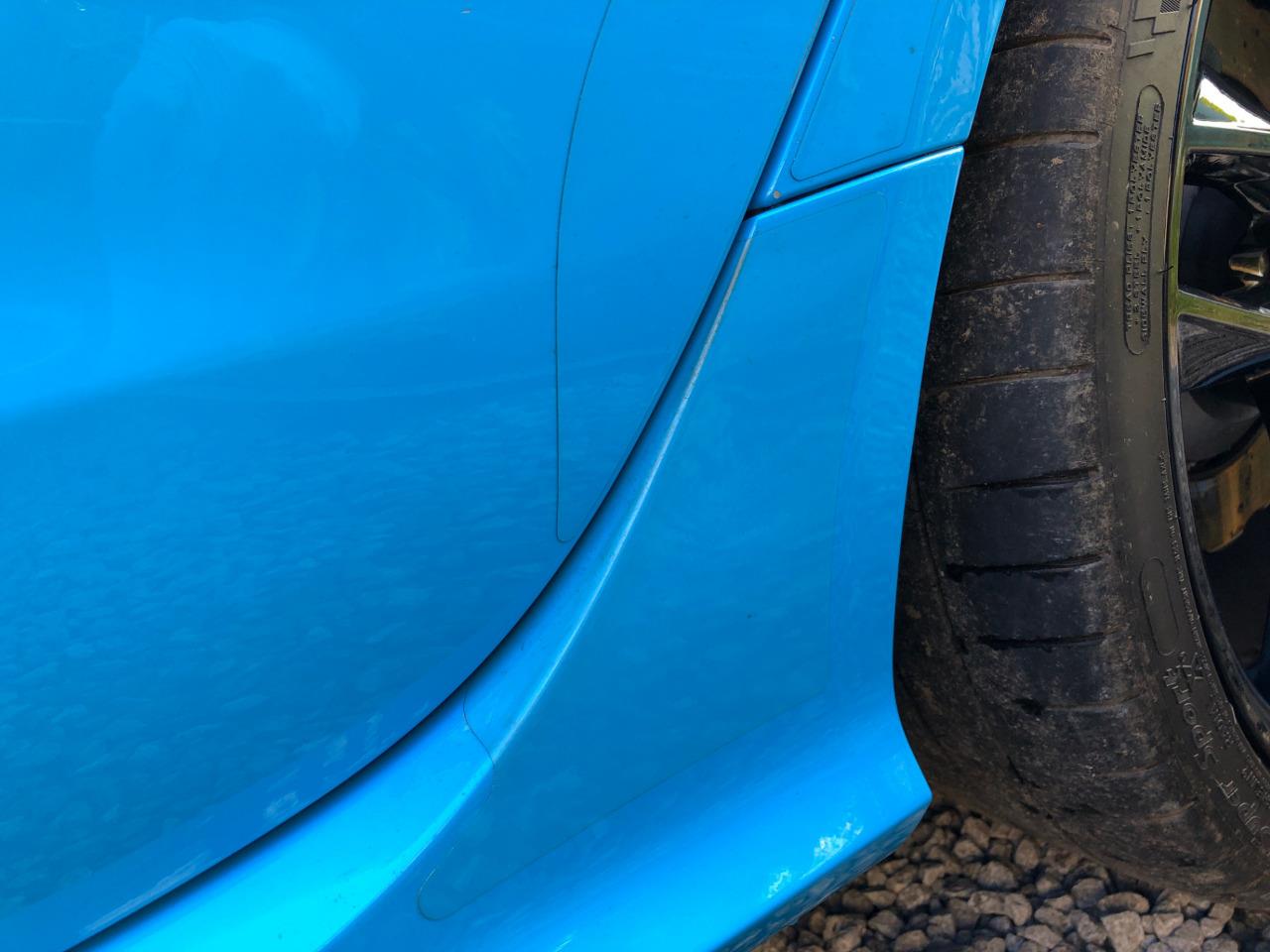

Done!!
It easily came off with a bit of heat. For some reason the two pieces on the metal came off easier. The one on the sill left quite a bit of glue on, so had to use some Goo Gone on it!
Once off I could see more that they had discolored and were quite yellow.
Applying the new pieces was real easy, just had to use lots of water, and then squeegie all the bubbles\water out. Really pleased with the result. From stand height you can't really see the new are on there. Its hard to see the lower new piece in the NEW images.
OLD
NEW
If anyone is thinking of replacing theirs, then I recommend the Oraguard (Orafoil brand). Its great to work with.
