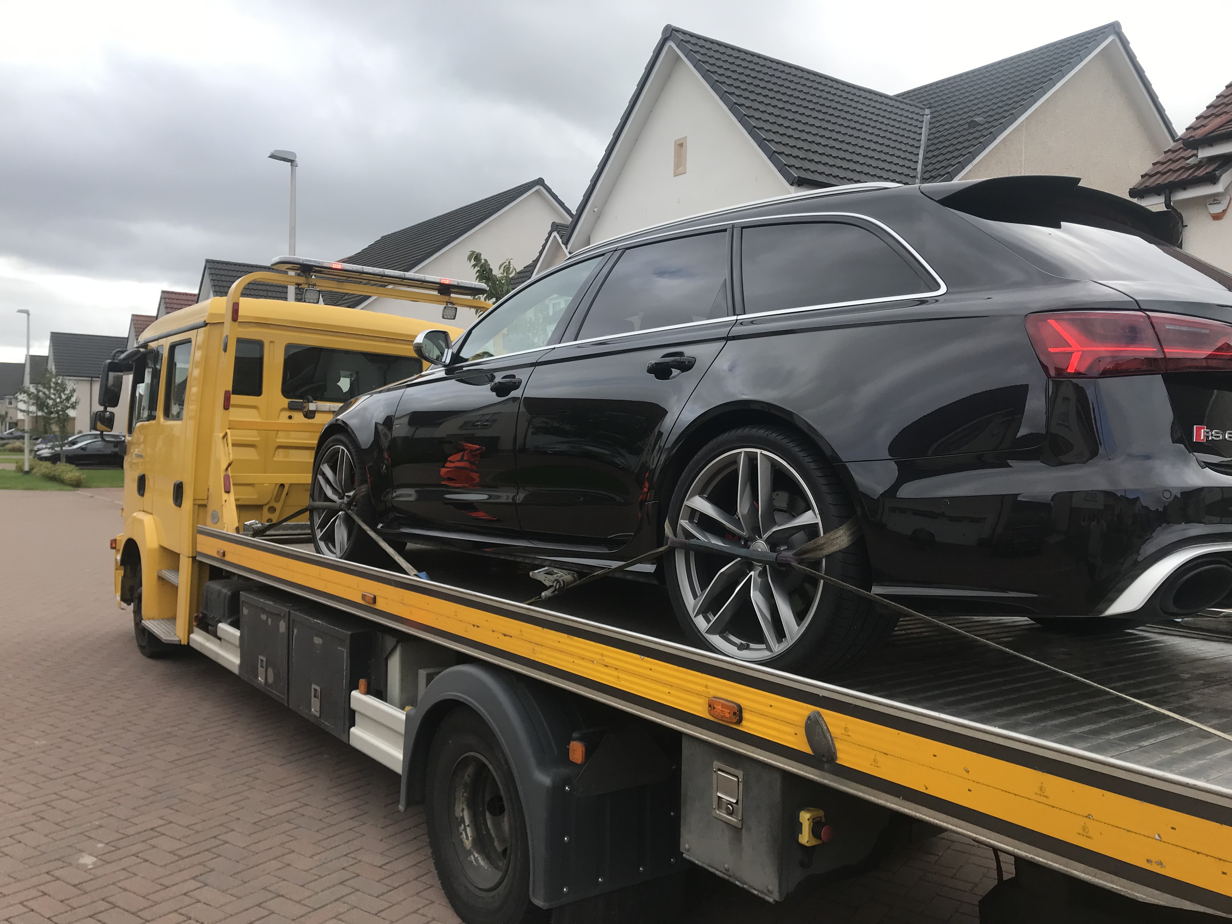

Just managed to get the car dropped at the garage there. I’ll update on the findings once they have had a chance to look at her. Sorry sight seeing them on the back of a low loader. Had to get it picked up as required by the warranty company.

Post by Lig » Mon Sep 16, 2019 6:00 pm
A sorry sight indeed... Nice and clean tho' :lol:

Yeah Lig, the ceramic coating makes it so much easier to clean
