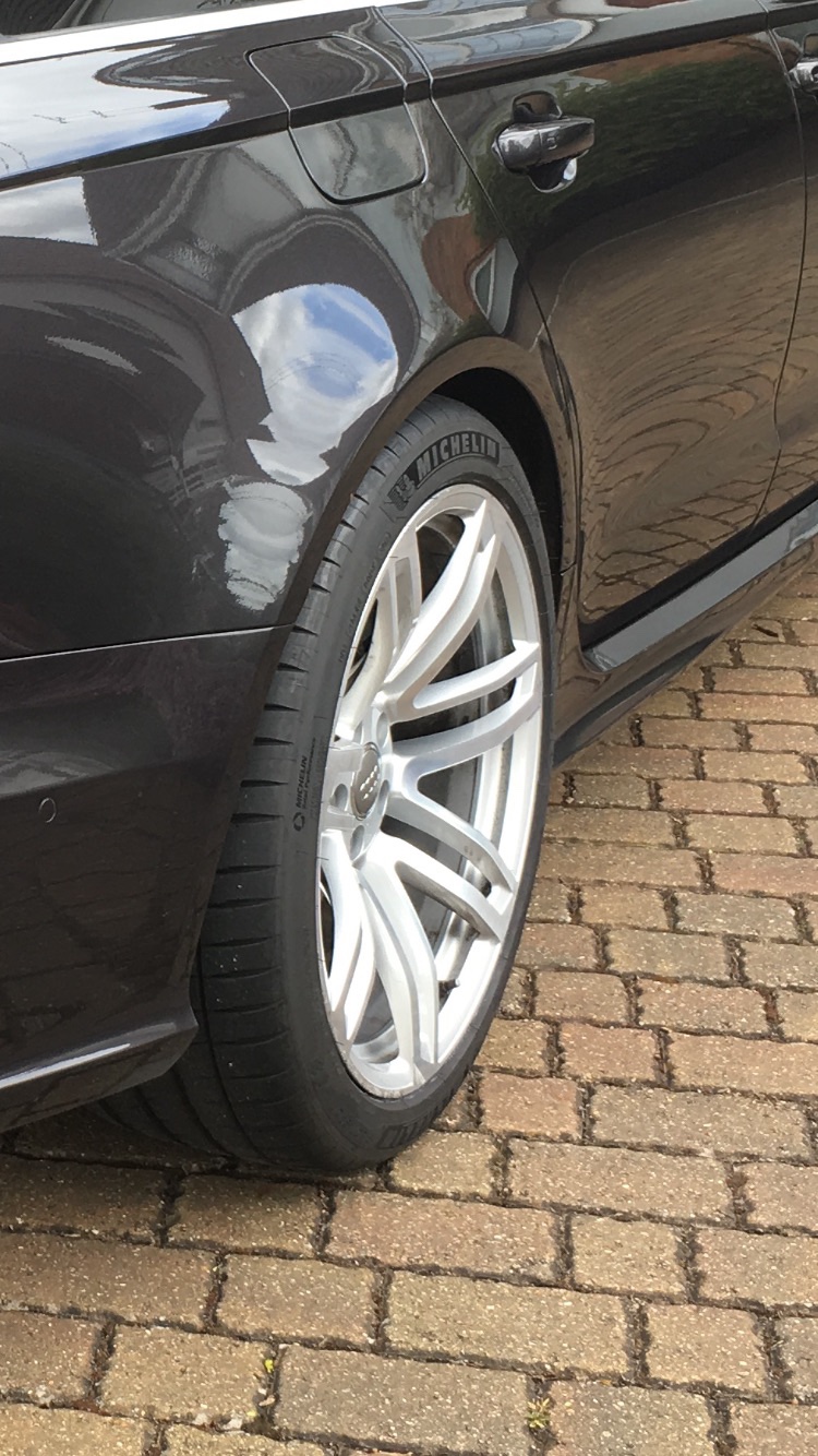

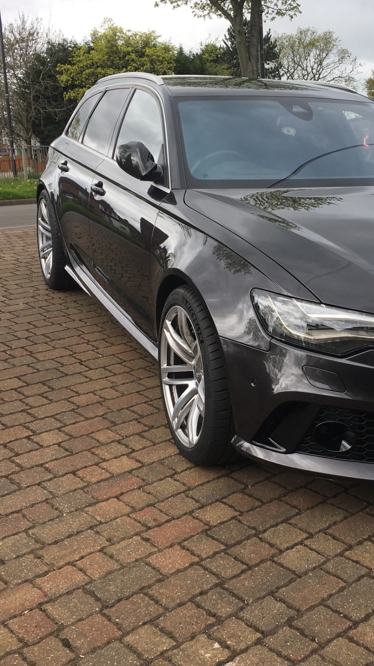

Post by HDPete » Fri Jun 07, 2019 9:20 pm
20mm trial spacers
20mm
HDPete
Posts: 261
Joined: Sat Mar 12, 2016 6:57 pm
Re: Performance spacers
Post by HDPete » Fri Jun 07, 2019 9:21 pm
Vs standard
Vs standard

Post by MountainMutant » Sat Jun 08, 2019 5:17 pm
Thanks for pics. Some pulled back ones would be good. Are you pleased with the result?
Post by HDPete » Sat Jun 08, 2019 7:28 pm
This was just a trial to get the right size. I’ve opted for 15mm and they’re being fitted next week. I’ll post when they’re on.
