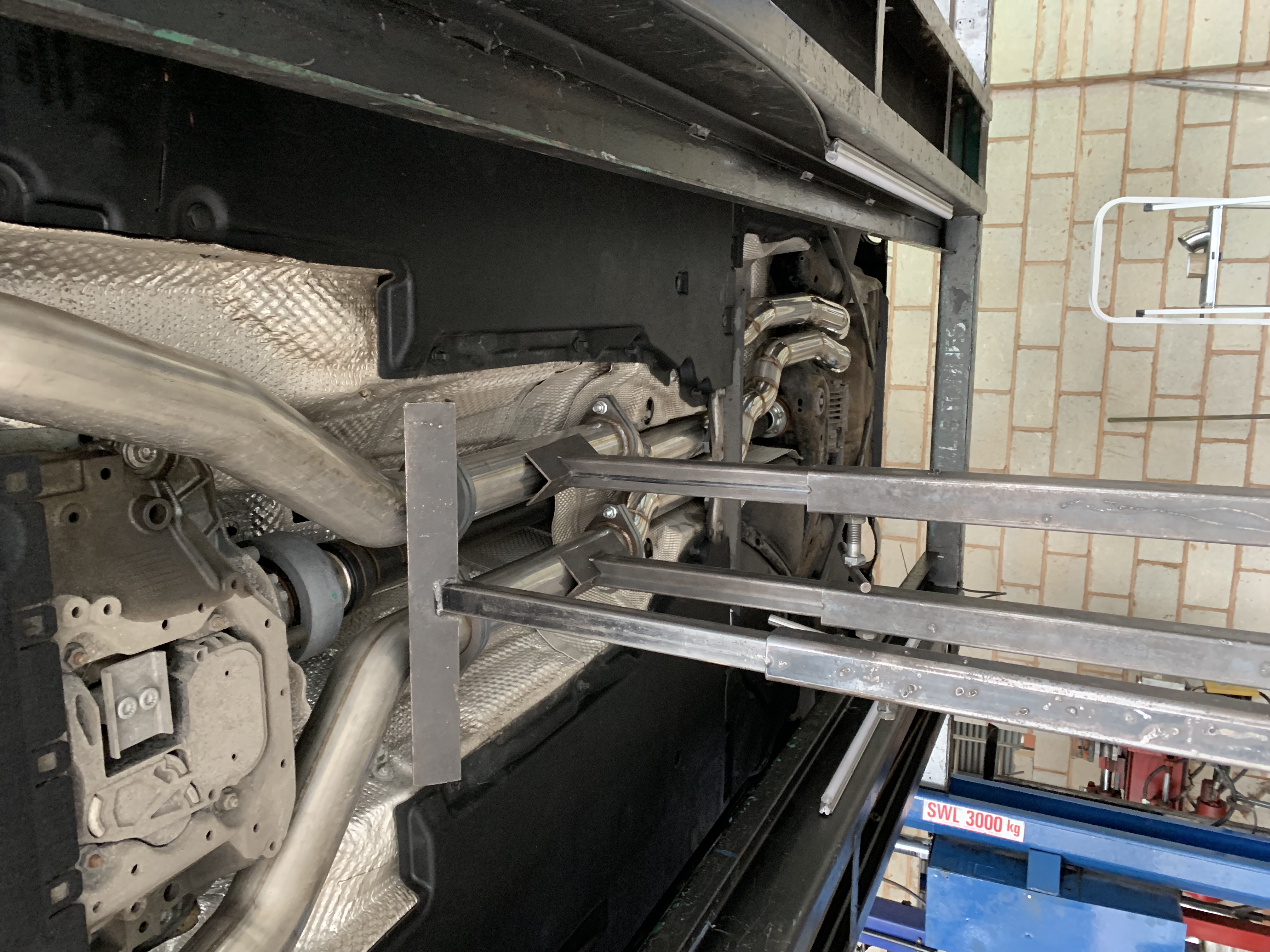

Decided to go for catless downpipes, change the whole exhaust for free flowing, non res custom one and adapt primary cats to be fitted just after downpipes for MOT...
Re: Exhaust choices - what are you running?
Straight through from catless pipes to original backboxes (until I can find a suitable valved backbox set to retain the noise control). Sounds perfect and grunty, grumbly and not raspy. factory backboxes are 2.25" inlet so I'll only be changing them for flow reasons, but the car is quiet on idle with valves closed, stay below 3k rpm and it's quite civilised, will be having to map out the cold start mainly as it's no longer needed (no cats) and quite loud. Should be able to creep off the drive in relative silence and open it up on the motorway / fast A roads.
Few niggles with the exhaust but it's a very tight fit and needs a little adjustement, will leave it a week and go back.
Overall quite happy although it took a long time to do.!
Link to 2nd / 3rd gear pootle around in 40 limit... https://www.dropbox.com/s/kr7te7wjwsumz ... 2.mov?dl=0
Interesting the pops and bangs are gone completely in drive, would like to lose those in sport so will play with overrun fuelling to get rid. In D the valves are closed so a quarter of the noise. Will be looking into mapping valves open in sport with minimal pops, d mode stealth until floored, when valves open at 50% requested throttle.
Forward thinking made me get the front section made with bosses, and I'm going to get a pair of sports cats fabbed into that piece to make the system legal and use the straight pipes for track use. Apologies for the phone video, but the audio on GoPro didn't capture the tone very well at all.
