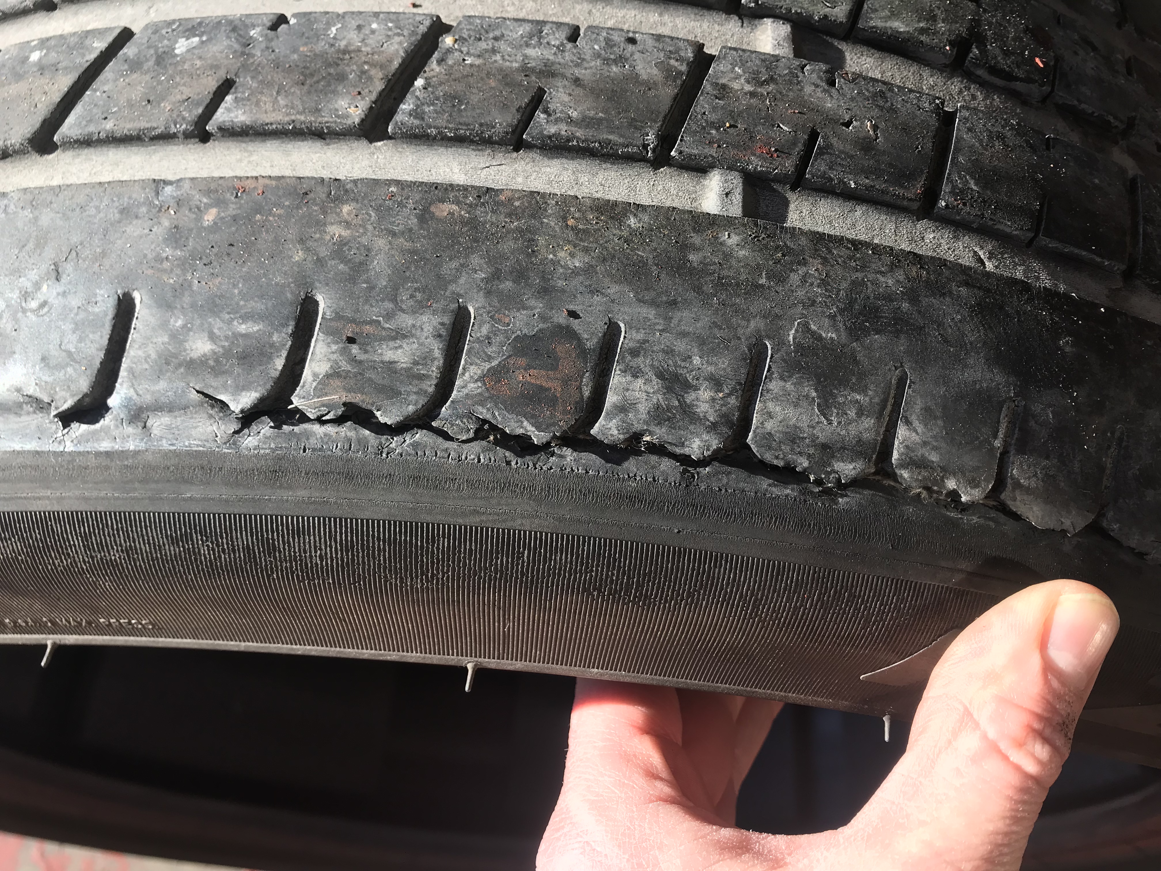

I know most of you don’t rate the P Zero for grip. But has anyone else had their P Zero decide to do this?
Happened just before I got to the EuroTunnel on me way to DisneyLand Paris 😡 Just a little annoying!
I know they were getting a little low on tread but I still had some wear left!

Time for an alignment check!

Yep my Pzero’s wore the same way.
Had an alignment check and all was ok too!

My cars are generally lowered so front camber is out and therefore the innder edges wear quickly but I have never seen then wear in that way. Looks more like a split than being worn through bad alignment.

That looks like the tread delaminating. Usually caused by running the tyres under inflated at high speed and/or hard cornering and so generating way too much heat. However, to do that on a road tyre, I suspect it would have to be almost flat. Any ideas what pressures you're running? Oh, and thanks for reminding me why I'll never have P Zeros.

2.4 Bar, TBH I have never checked to see if that was the correct pressure for the car. It was what was in them when I got the car. Little naughty of me.
I’m sure someone will tell me now if I was running the wrong pressure.
Definitely no hard corner from me. I drive very civilised now.
I had been cruising for 2 and half hours at roughly the speed limit. Stopped at the services. Set back off and pop!
Low tyre pressure!
I’ll be checking me pressures are correct before I set back off home!

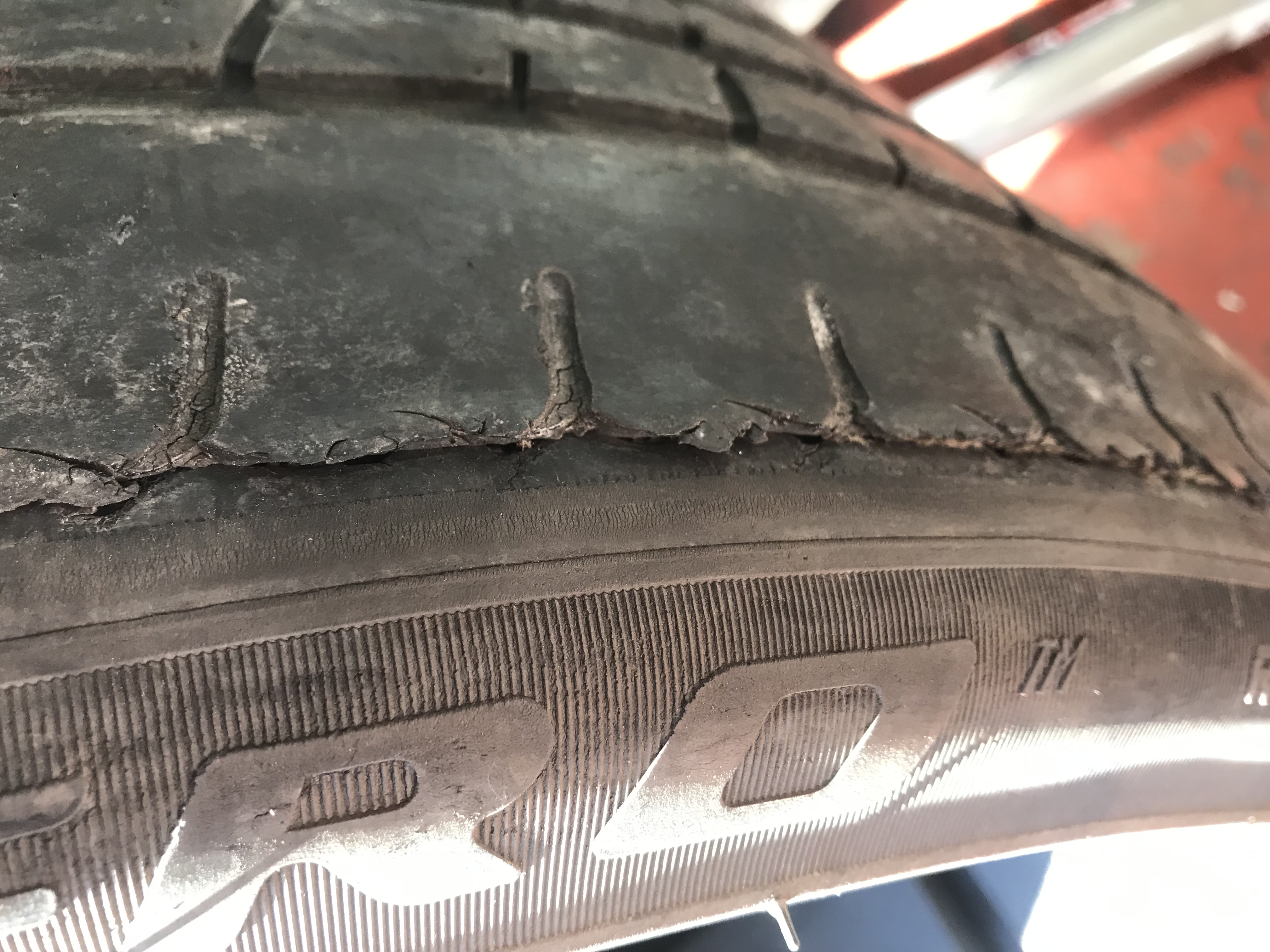

This looks familiar...
My P zero is exactly the same, rest of tyre has good wear, edges are coming apart. I have a set of PSS waiting for me this week.
I have had PSS on my B8 RS4 and the turn in and balance on that car was amazing. The 6 is an understeer disaster (all geo's checked and re-checked). I'm hoping that the the PSS will re-coup some lost ground as I'm no fan of these PZ. Audi tells me they are OEM recommended for my car :-/
https://imgur.com/a/WuU90vW
I will check the pressures though - as wear on the edge and not on in the middle sounds like under pressure to me.
