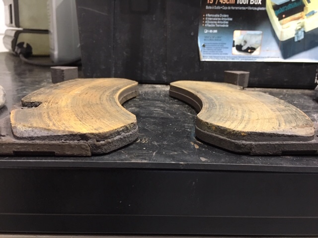

Mike will love me digging out an old thread through shameless self interest.....Image
My RS6PE is with Reading Audi right now having a brake grabbing issue investigated.
Having found nothing wrong with braking system (as expected), they’ve pointed out my discs and pads are 75% worn and I should consider replacing pads and discs, front and back.
Couple of things:
• The car has done 29k miles, 9k of which with me since buying from Southampton Audi in July ‘18.
• My miles are mainly motorway with the odd, good spank in between. Discs at this mileage seems unusual to me
• Car under warranty until end of ‘19.
• Prices are £1458.92 and £1777.93 for front and back respectively which seems stiff.
I’m inclined to go to an indie when the time comes assuming I’m out of warranty. I’m in Berkshire area btw if any good specialists come to mind.
Any guidance/thoughts appreciated.

Those pads look only 50% worn at max, they don't have tonnes on to start with.

Thanks LeeRS6, really helpful. I’m not at all technically minded so I’m ripe for being ripped off!!

Rs6 pads only have about 17mm of meat on them so its not that much in the first place.
@holmsfree did they provide you with disc thickness measurements? Its usually the best way to work out how worn they are as they have the min thickness printed on the disc

Thanks Morski. "75% worn as measured with a Vernier gauge" is all the details I have beyond the photos.
