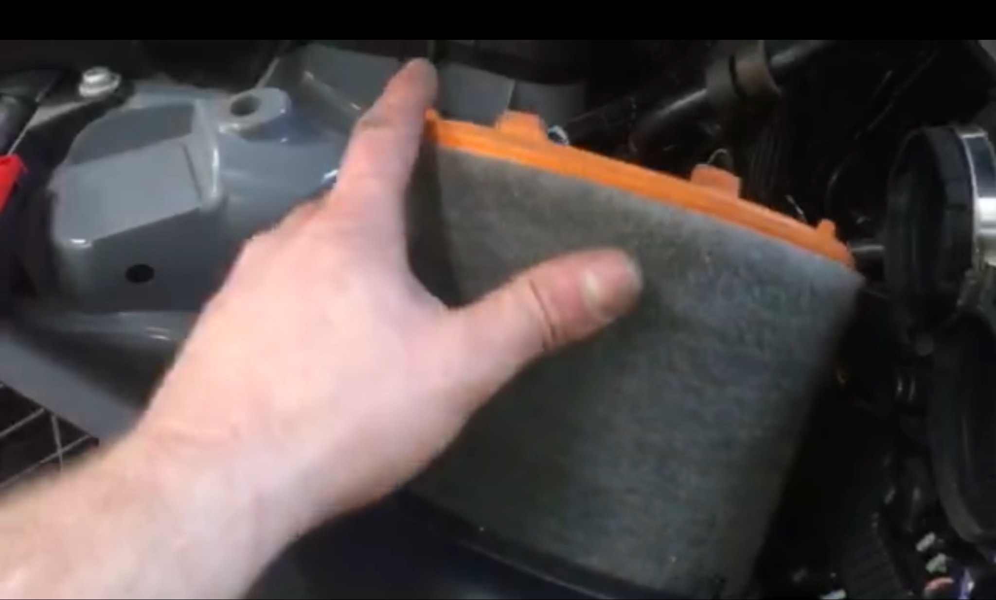

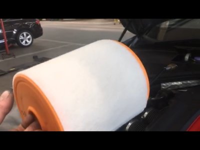

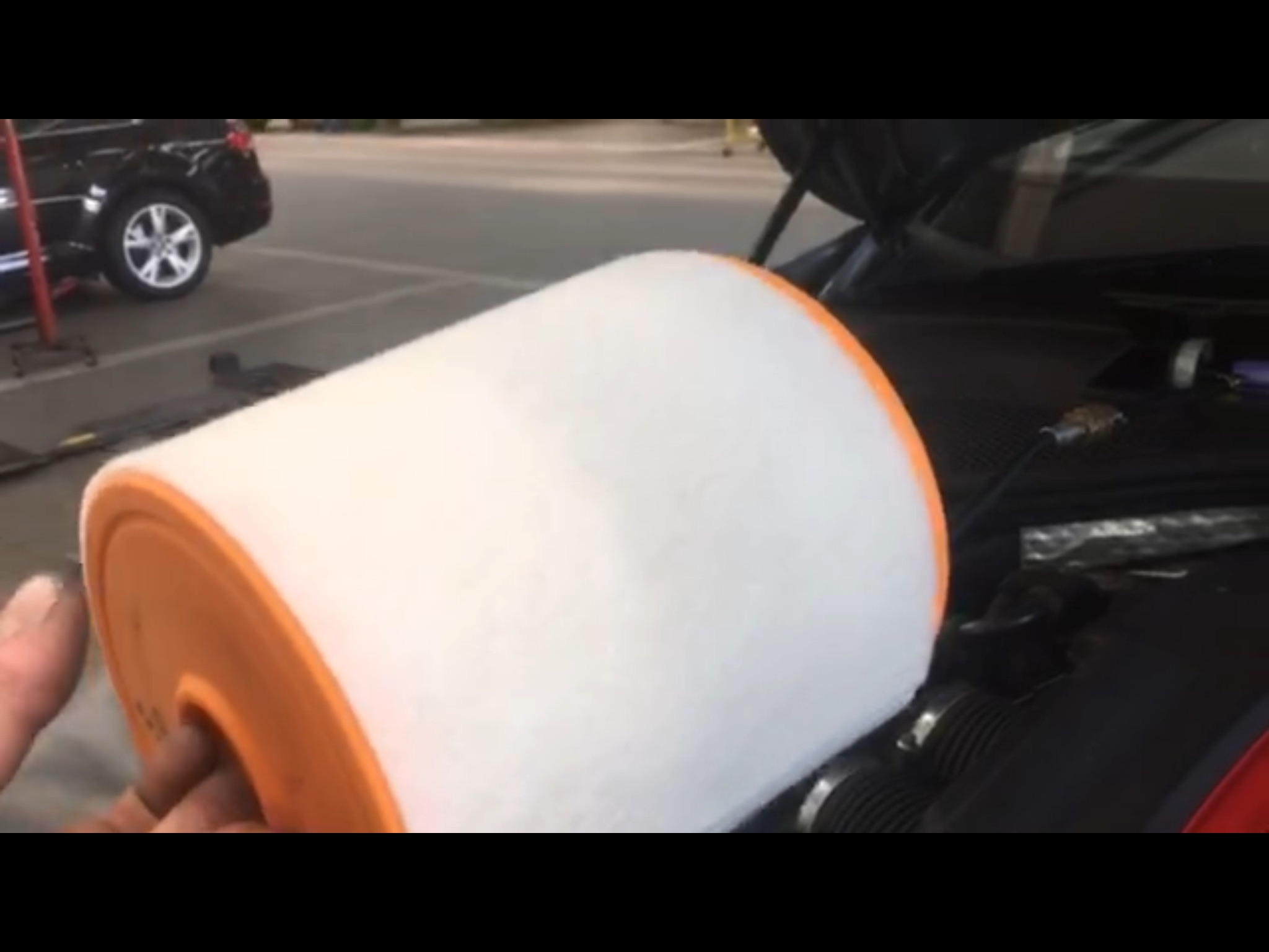

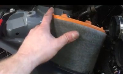

What's the sump volume 9 ltrs? That's around all the oil used us every 12k isn't it so really on top ups alone you've changed it ! Ha seriously though, I'm with Mike oil and filters every 9k just done my air filter at 19k ! Looked dirty too .
