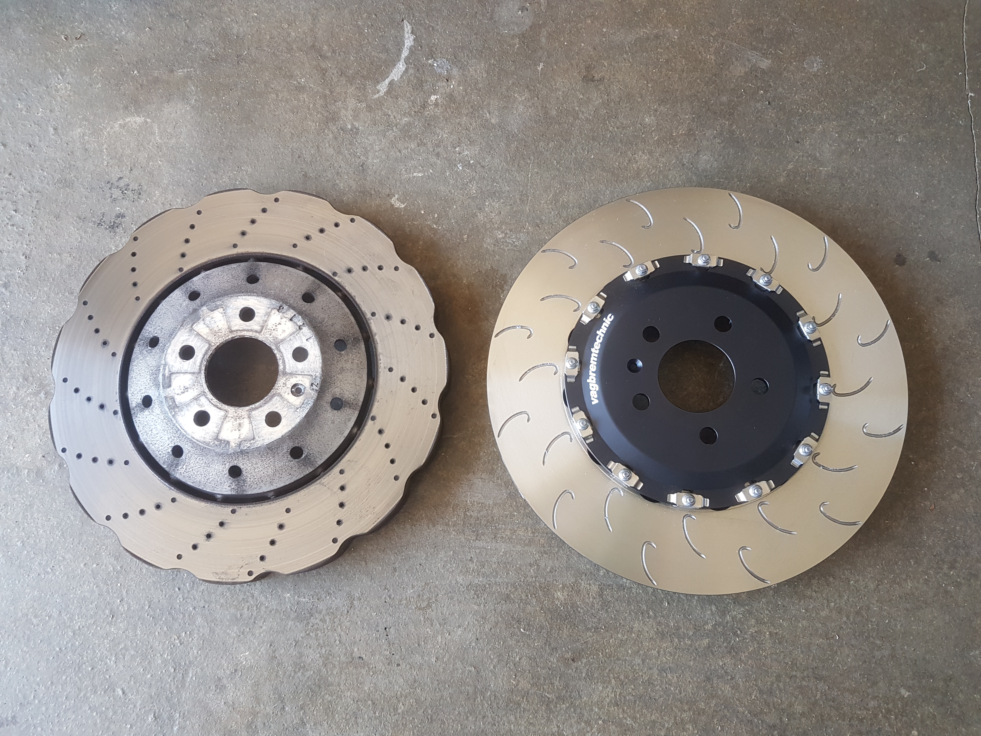

Like Mike, I installed Ferodo DS-2500 pads and find them very good indeed. Again, like Mike, at the same time I installed braided lines and new Motul RBF 660 fluid and the transformation was like night and day for me. My brake fluid had gotten pretty bad and found the brake pedal going away from me pretty quickly before the change but now I have a lovely firm pedal feel that lasts and lasts.
As I had managed to warp one of my front discs prior to doing the work, I also installed the VAGbremtechnic/AP Racing 2 piece discs which again aided to the braking feel if not the overall performance. At least now I can attack the brakes hard without worrying about warping the OEM discs (which is a common problem).

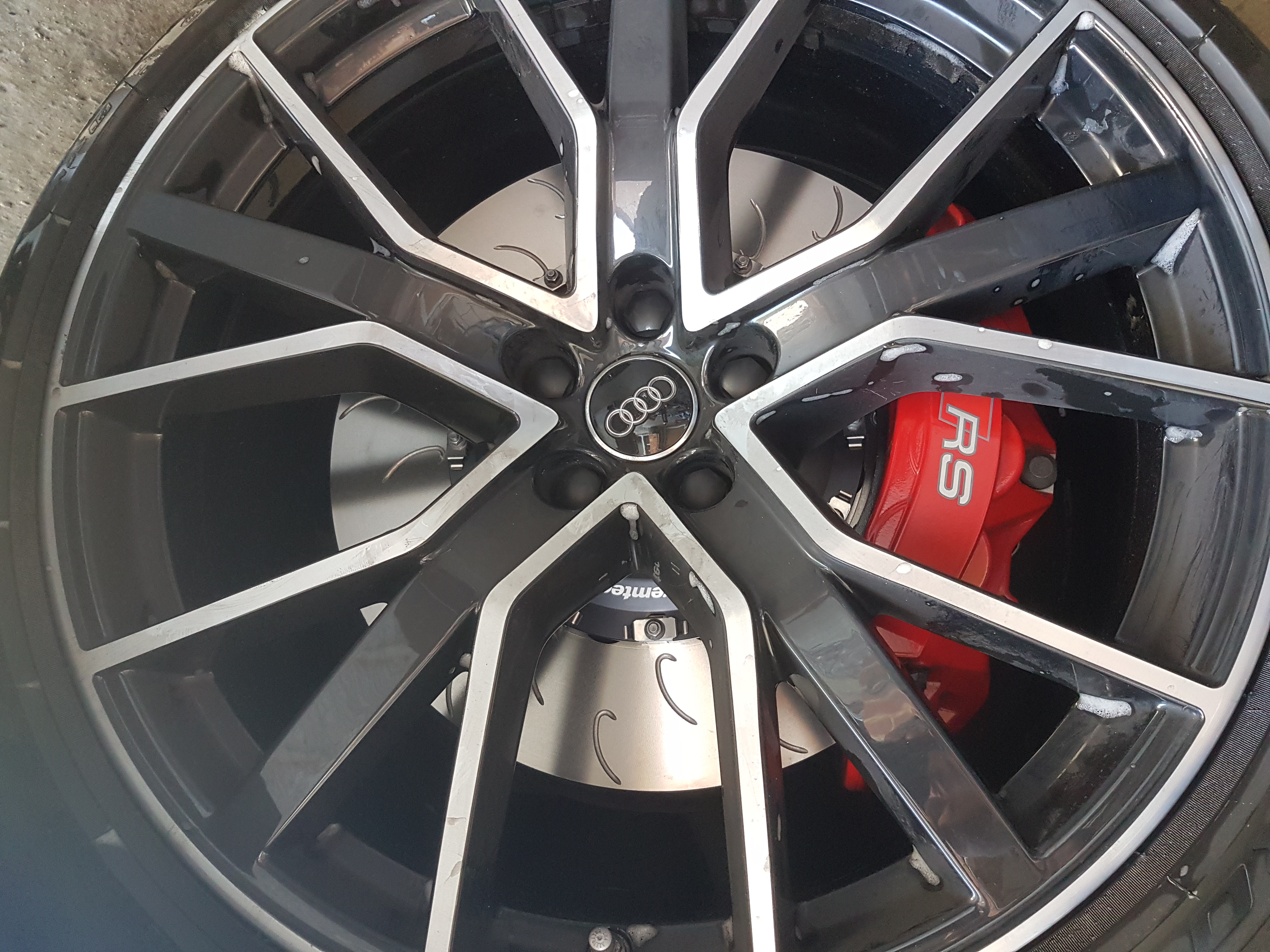

Post by tartan_rob » Thu Oct 04, 2018 8:01 am
Excuse the very unclean wheel.... :bowdown:
You can see the brake pad residue on the disc surface...

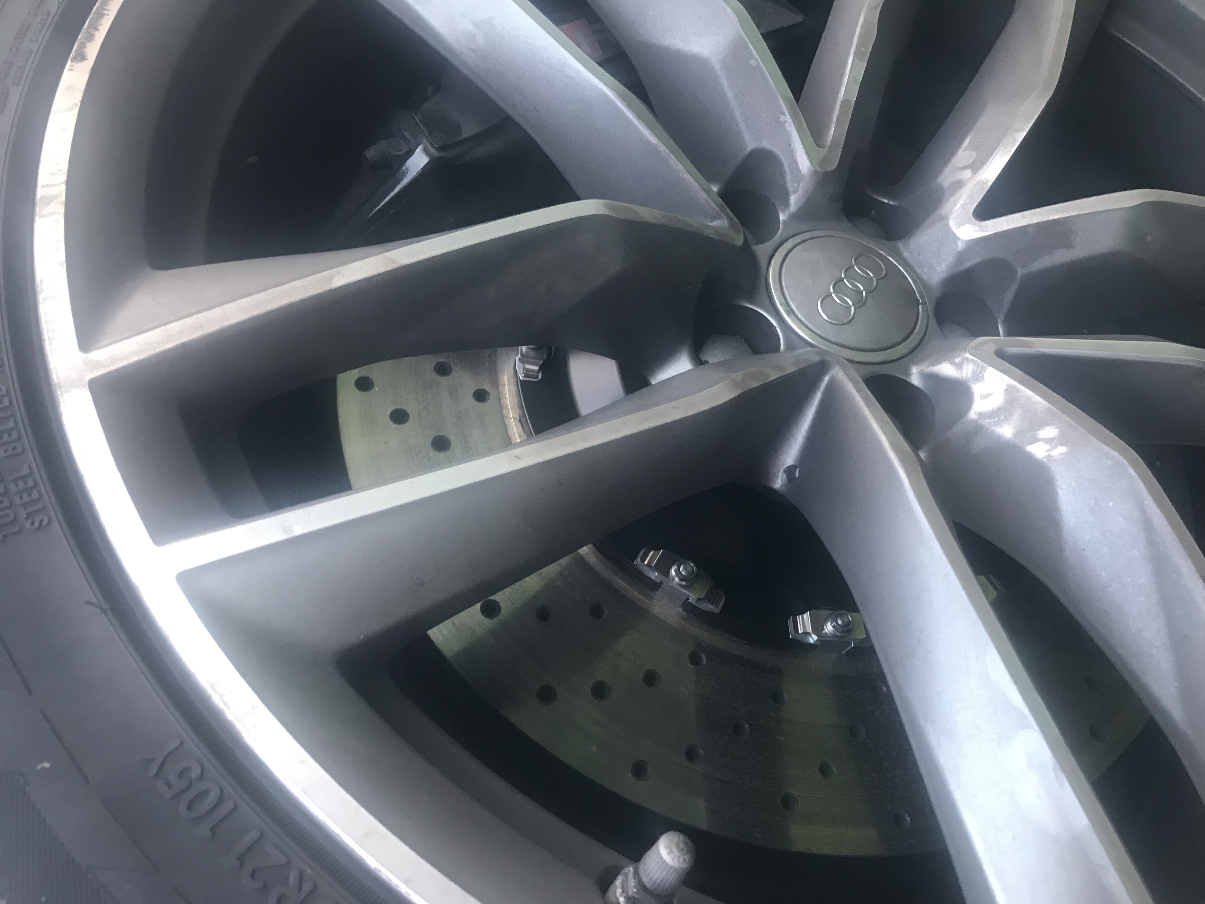

21” wheels...
