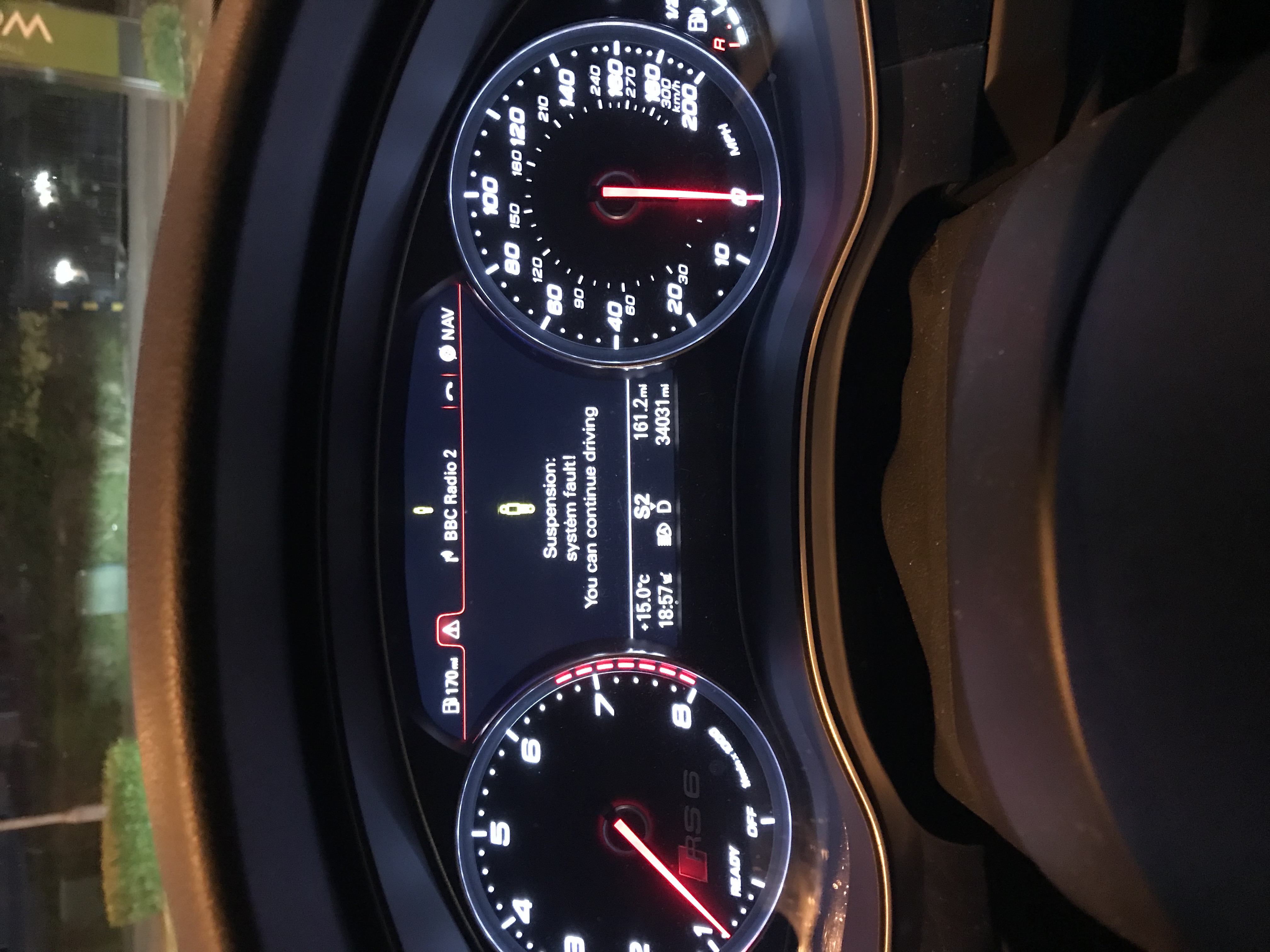

Ohhh boy - this came on the other night - God only knows what it is, but she's going in on Thursday for fluid changes, incl gearbox oil and for the fault to be looked at
Anyone else have this issue, if so, was is a long time to be sorted?

Apologies the pic is 90 degrees - when uploading it is facing the same way!!

Post by RS6chris! » Sat Oct 14, 2017 8:25 am
Yep
Ive had this....and mike fish too
On my old C7 pre FL car.
Is your car lowered is my first question?
The car has two level sensors on opposite side of car...one front and one back diagonally placed....my rear one kept throwing up that error.
Something to do with lowering car, only seeemd to do it when car had a bit of weight in it.

Post by Iain » Sat Oct 14, 2017 8:53 am
Car is standard - not lowered.
Nothing in car weight wise other than me driving it

Post by RS6chris! » Sat Oct 14, 2017 10:31 am
Called a level sensor I think???
Think it was on rear o/s that was throwing code
Turned car off and it reset a couple of times

Post by Iain » Sat Oct 14, 2017 11:01 am

Post by MikeFish » Sat Oct 14, 2017 1:59 pm
Chris is right i had it too. I plugged my laptop in and it said it was a faulty level sensor (front right). I pulled the front right of the car apart looking for the front right sensor but just couldn't seem to find. Turns out the air cars have sensors on all four corners but the DRC cars only have 2 sensors; front left and rear right). It also turns out that the front left sensor can actually be seen quite easily without stripping the car apart!! Anyway there was nothing wrong with any of the sensors and I had a couple of other warnings flash up so thought it could be a low battery.
So I charged the battery for a few days and the fault went away and never came back.
I keep my battery topped up now and it seems to keep the errors away.

Post by Golfather » Sat Oct 14, 2017 2:15 pm
Same issue on C6, rear sensor can be temperamental. Esp when decked. Clean connections, check wiring, and reset codes usually sorts it. Reoccurrence means new sensor, pretty cheap and straightforward to DIY.

Post by Iain » Fri Oct 27, 2017 10:21 am
Turned out it needed a new N/S/F Shock absorber - waiting for the O/S/F one to fail now!!!
