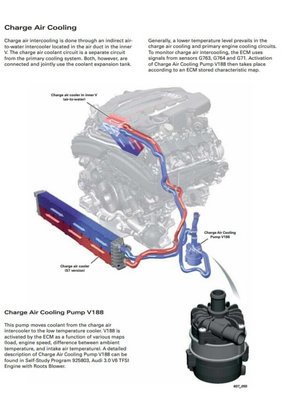

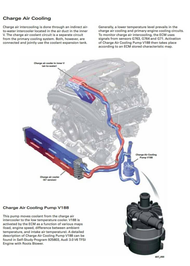

They're charge coolers, not intercoolers so they don't use air flow to cool but use coolant (water?) instead. The coolant in the charge cooler is then cooled by a small radiator just infront of the main radiator at the bottom.

Hmmmm, just looking at that diagram, it looks ripe to use Phase Change cooling.
  • Step 1 - Beef up OEM aircon package
    Step 2 - Redesign cooling jacket for the cooler
    Step 3 - Route into newly beefed aircon
    Step 4 - ??????
    Step 5 - Profit
At the very least you could use CO2 or the aircon circuit to help lower the temps of the charge cooler water jacket. Bigger isn't always better if you can keep the intake temps sufficiently low, ne? Just increase the cooling capacity of the current solution.

Bam - The charge cooling has it's own reservoir and radiator which is separate from the engine coolant res/rad setup. It is these that are being made bigger to help the small charge cooler work more efficiently by getting more coolant through the charger cooler and then cooling it faster by using a much bigger rad.

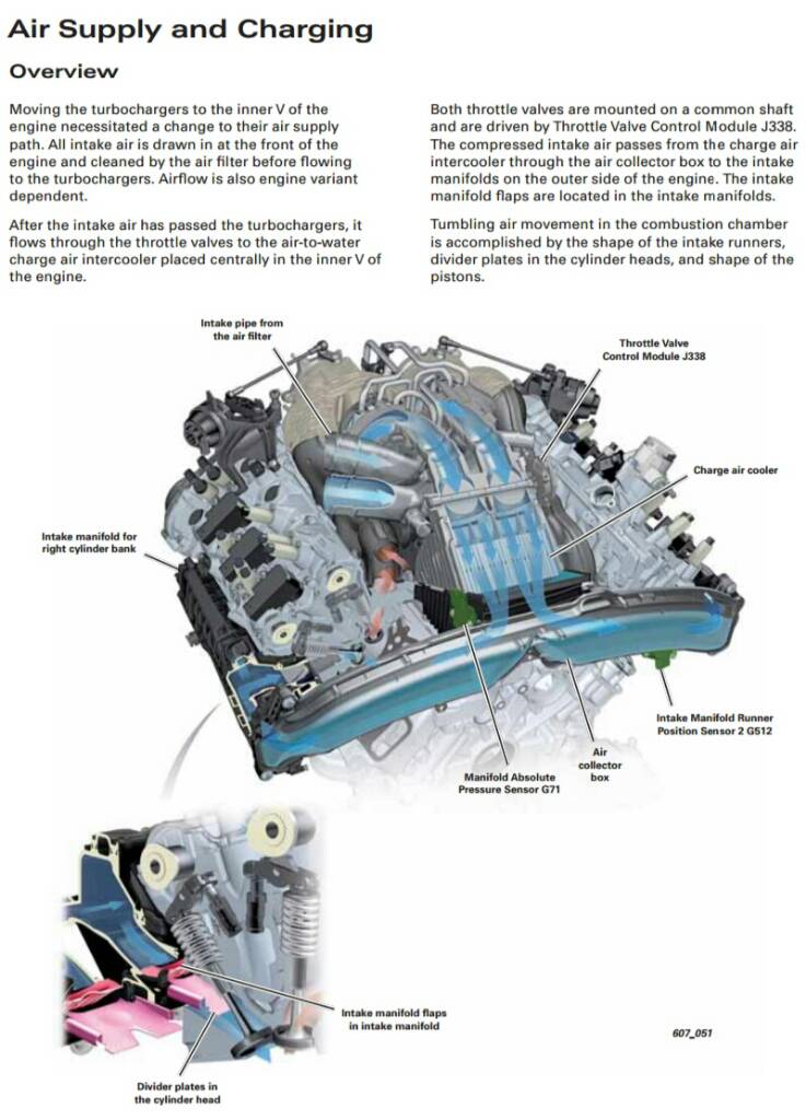

However, the 900+ hp issue is mainly air flow through the Charge Coolers (restricted pipework diameter/bends is the biggest issue) and also volume, but that's to a lesser extent, although bigger is always better :D

IanH755 wrote:Bam - The charge cooling has it's own reservoir and radiator which is separate from the engine coolant res/rad setup. It is these that are being made bigger to help the small charge cooler work more efficiently by getting more coolant through the charger cooler and then cooling it faster by using a much bigger rad.
Ahhh, got it. So it has its own circuit, that's awesome. So the remit should be to increase the charge cooling circuit output while making the core more free flowing? I see how the pipework is an issue.
Bigger isn't always better with charge coolers, if it's too big you'll tkae an age to make pressure, certainly not a problem here! I'd bet some tuners are just thinking about stuffing a huge single turbo into the V to minimise pipework.
