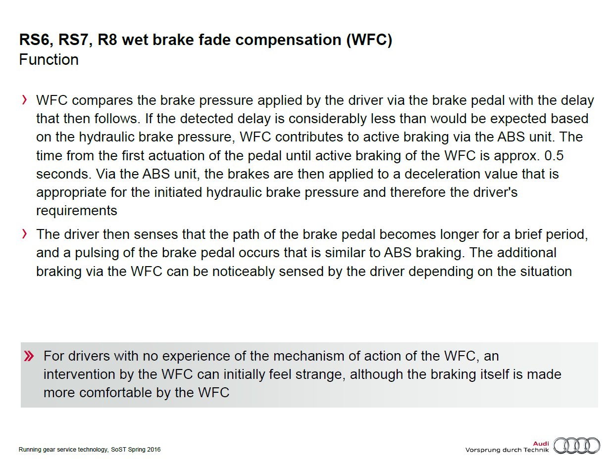

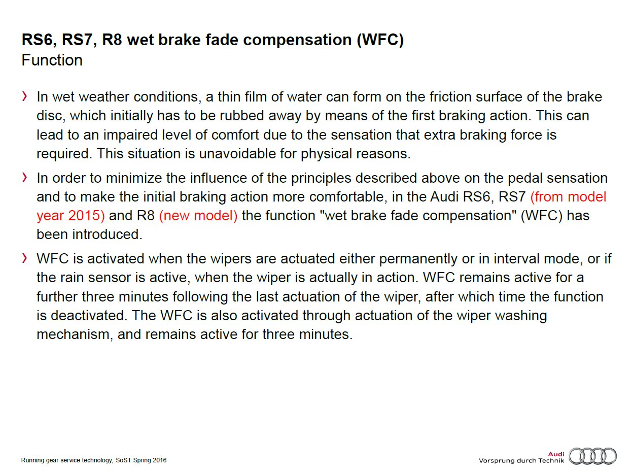

So Technical have suggested it may be WFC - Wet Brake Fade Compensation. Well - looking at the information provided by them, its not, as this is supposed to assist braking not impair it... however it may answer some questions raised by others here who have experienced a different/unusual kind of braking sensation.

It does say it gives you a longer pedal.
Re: Braking Problem In The Wet
Post by MikeFish » Tue Jan 22, 2019 12:02 am
And it says it will feel strange.
Odd that we'd never heard of this feature that appears to have been introduced at facelift. And if it gives unusual or strange feeling then why wasn't it added to the manual?

That's 100% what mine felt like. Feels like the peddle almost goes to the floor momentarily, then because you have pressed even harder when the brake does return you just about go through the window.
When you are pushing on and this happens its very disconcerting. Obviously not fully tested before it went into production!!

I would agree with the pedal feeling definitely, so I believe in my situation it could well have been caused by WFC. But it certainly didn’t improve the braking sensation - it slammed our faces to the windscreen!

I don't like the sound of this at all. I can't figure out why it's needed. Can it be turned off / coded out?
Scotty C
Posts: 237
Joined: Wed Feb 03, 2016 3:48 pm
Post by Scotty C » Mon Jan 28, 2019 4:30 pm
Shoppinit wrote:
Mon Jan 28, 2019 3:15 pm
Yes I imagine it can be.
As a trial, and as instructed by Germany, the dealer has switched off the Disk Wipe function on mine to see if this prevents the problems I have been experiencing. Technical in G assure me the car is still safe to drive (I have kept and printed email evidence of this in case I vanish) and braking will not be affected enough to notice. This code came directly from the factory and was not easily obtainable by the dealer.
