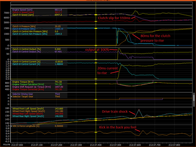

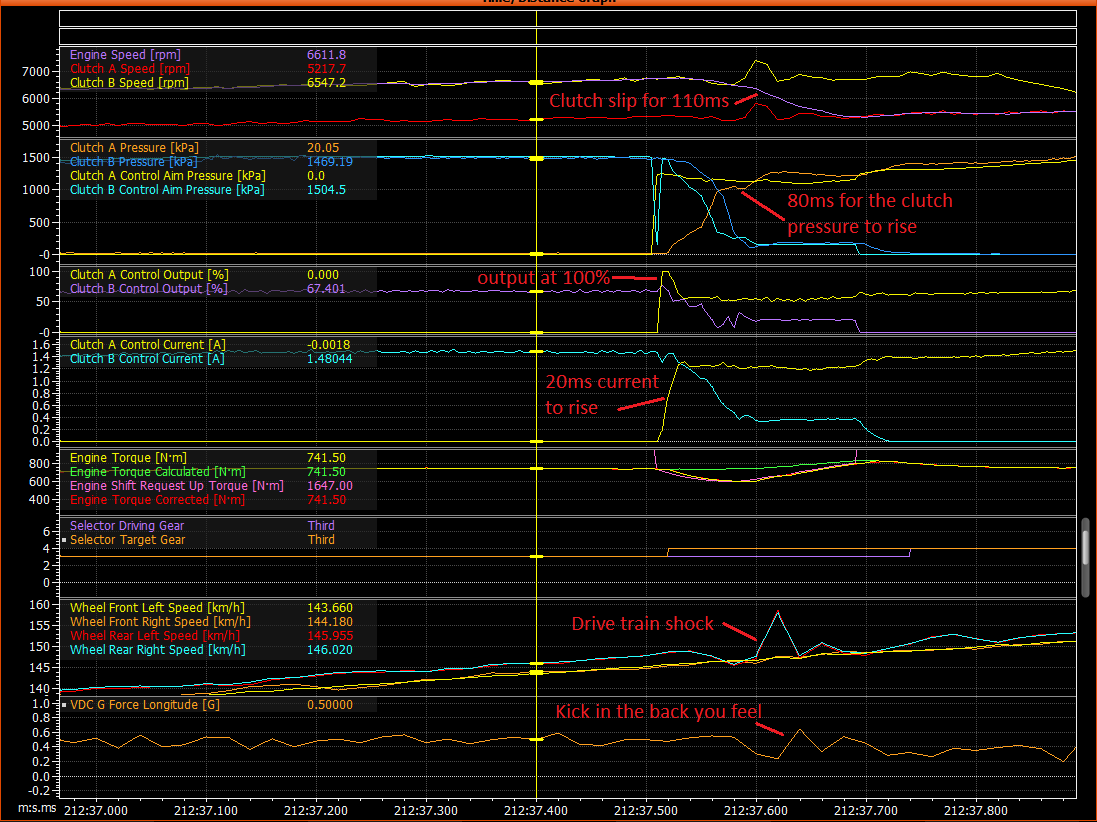

Being someone who has coded a standalone aftermarket TCM for the GR6, I do have all the facts and figures on shift times, delays and what the mechanical hardware is capable and where improvements can be made.
Let's be honest, shift performance is only about full throttle up shifting and the acceleration lost during this time. Other shifting conditions effect driveability and feel, and these are important, but when you're talking about faster shift time it's all about performance. First I want to clear up some terminology.
What I regard as 'Shift' time is the amount of time where torque to the wheels is disrupted and the vehicle stops accelerating. Shorting this time makes for better performance while accelerating.
Then there is 'Delay' time, which is the time from when the shift paddle is pulled to when the engine begins to decelerate which is more an annoyance, but can affect performance where your shift doesn't happen when you want it.
There is also engine deceleration time, which is the time when the clutch is slipping, pulling the engine speed into the new gear.
Shift times on a manual syncro box are relatively slow. Typical fast shift might be 300ms, and some might achieve 150ms in a best case scenario.
Then there is a sequential dog box and this can be manually operated or paddle shift, it doesn't matter too much but the engine 'cut' time might be as little as 35ms.
F1 gear boxes are 'zero' shift so no cut on what is effectively a dog box. This is achieved be selecting the next gear before disengaging the previous. When the next gear begins to drive it unloads the previous gear and this is disengaged in the slop the dogs before it explodes. This requires very precise control and very fast and accurate mechanical systems which you would expect from F1!
A dual clutch gearbox (of any make) is also a 'zero' shift gearbox as it engages two gears at once. It doesn't explode because of the slip in the clutches. The 'shift' time is not always zero though, but only because of poor programming for the modifications to the car (engine or trans). The shift feel can be changed dramatically in terms of how hard the incoming clutch is applied and how much torque reduction (by ignition <beep>) is applied to the engine to counter the additional torque delivered to the gearbox from inertial energy coming from engine deceleration.
So 'Shift' time on a GR6 should always be 0ms, no effective interruption of torque from the engine to the wheels.
The time it takes for the engine to decelerate can vary massively from 50ms to 500ms (longer also but the clutches will burn), but torque is always being delivered to the wheels so this is still and 0ms shift time. If the 'correct' amount of torque reduction is applied to compensate for the deceleration rate of the engine then the shift will be smooth, even if deceleration time is really short. The kick in your back is when there is not enough torque reduction, and a lot of people like this. It's potentially better performing also as you're regaining energy lost to accelerate the engine rotating mass in the first place, but often just means the wheels slip instead.
The delay time in the GR6 is from the amount of time it takes from when you pull the paddle until the engine begins to decelerate. Moments before the engine begins to decelerate, the torque driving you forward is transferred through the new gear. The delay (usually ~100ms) is caused by the time for the clutch pressure control proportional valve's magnetic field to rise and move the valve, but more so for the trans fluid to flow and fill the clutch cylinder, taking up the clutch clearance before building pressure and beginning to drive torque. This is a mechanical limitation of the GR6. The OE TCM does have some delays but only a few milliseconds compared to what I could achieve with the Motec TCM when I tested in the best case scenario of full battery power to the control solenoid 1ms after the paddle was pulled. The OE TCM does a pretty good job and the ones I were measuring were LC1 as I did this work years ago.
Different programming, Nismo or Super TCM programs really only effect the shift feel and not shift speed, but can improve actual performance (balancing the torque reduction), or just perceived shift performance.
This data is from a Targa road race car. Mods are limited for the class but it has a Dodson clutch so is a little better shifting time than stock due to not needing maximum clutch pressure to shift.
This was tuned for speed so the torque reduction was minimised on shifting and you can see the resulting shock through the drive train into the wheels as the torque is transferred to the incoming clutch.
Also on reflection it appears the amount of overlap in clutch pressure was just a touch too much as the G Force drops a small amount before the torque is transferred.
Shifting from 3rd to 4th at full throttle. In this case the total time from the moment the paddle is pulled to the kick in the back is ~110ms, and total shift time is ~175ms.

Very informative post, I had some idea about how DCT worked, that it was constant drive and held the current gear whilst selecting the second but didn't know the details.Paulm wrote:This is very interesting and kind of explains why you cant feel any difference in change speed. Some things can only happen so fast.
