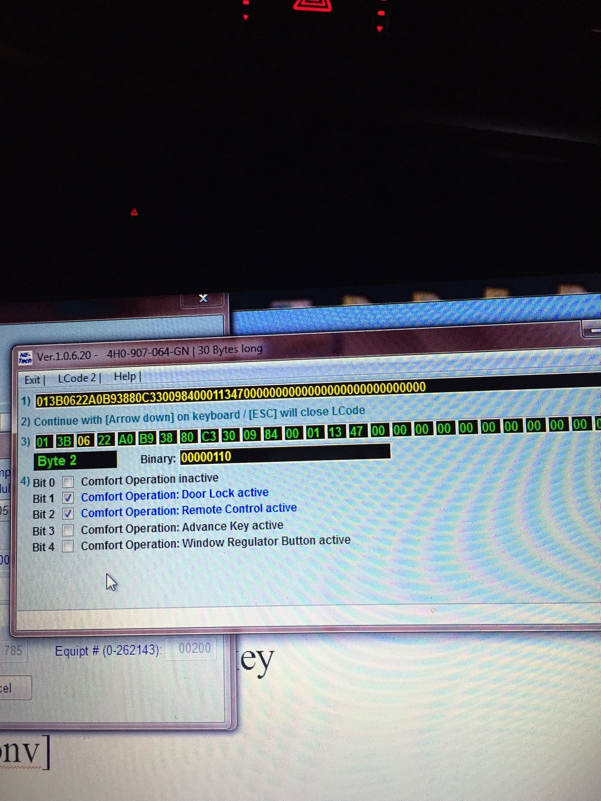

If you have VCDS try the following:
Close electric boot lid from key
[Select]
[46 - Cent Conv]
[Coding - 07]
Click on byte 2, bit 2
Tick Comfort operation: Remote control active
[Do It!]
[Select]
[4D - Trunk Elec]
[Security Access - 16]
Input 12345
[Adaption - 10]
Activation using rear lid opening button in remote key - Touch function for closing
Change to ACTIVE
[Do It!]
[Select]
[46 - Cent Conv]
[Coding - 07]
[Do It!]
[Select]
[4D - Trunk Elec]
Input 12345
[Adaption - 10]
Change to ACTIVE
[Do It!]
- 3rd Gear
- Posts: 271
- Joined: Fri Jul 03, 2015 10:28 pm
Re: Key Fob Boot Opener
looks like it is activated on mine but does not work
Did you check the 2nd part Paul?
yes but most say active (including the one you suggested). I need more time to read through all options. my lap top was going flat.
I tried my fob again tonight. All I hear is the boot lock opening which would suggest it does not know its open. Using the switch inside the car does nothing either
Ok, I've just read about someone with a facelift car with exactly the same issue as you ie both were already actives and this post helped them fix it and get it working:
Check that both tap and touch are not activated at the same time:
6D – Trunk electronics
Security access – 16 = 12345
Address 6D:4G9 959 107 A recoded (ADP-(4)-Activation using rear lid opening button in remote key-Tap function for closing) from not active to active
Address 6D:4G9 959 107 A recoded (ADP-(3)-Activation using rear lid opening button in remote key-Touch function for closing) from active to not active
Address 6D:4G9 959 107 A recoded (ADP-(4)-Activation using rear lid remote unlocking switch-Tap function for closing) from not active to active
Address 6D:4G9 959 107 A recoded (ADP-(3)-Activation using rear lid remote unlocking switch-Touch function for closing) from active to not active
This will result:
remote opening – long press - touch
remote closing – short press - tap
door closing – short press – tap
Touch = long press is set for opening to prevent accidentally opening the hatch.
