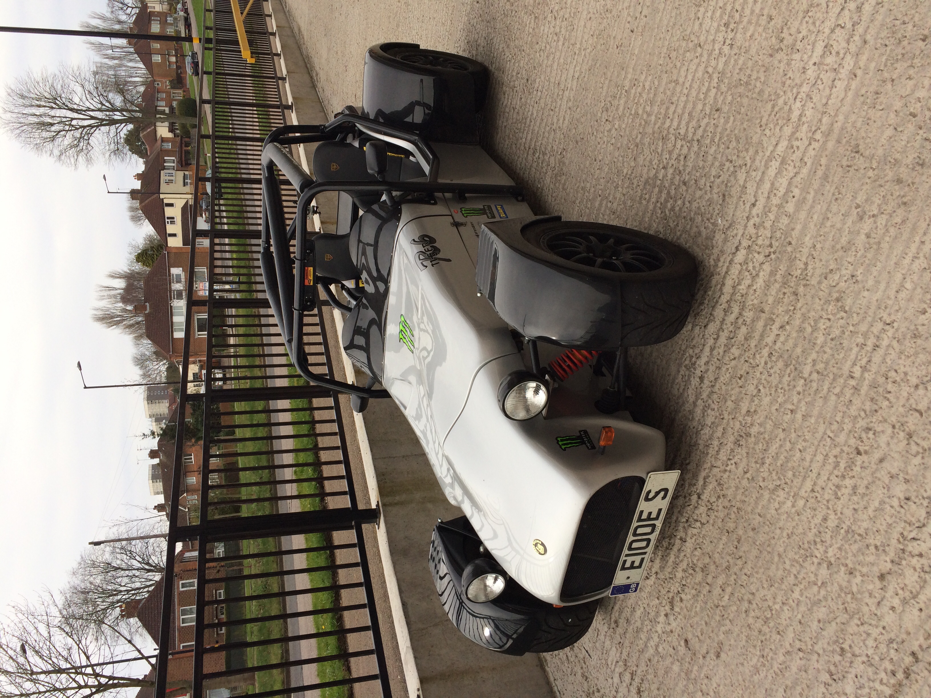

I had this toy for 5 years and only recently parted with it and I guess my driving behaviour was adapted for her. If you didn't wait till you were straight before planting my foot it would be snaking up the road like a lunatic. 210 bhp and 550kg = a whole load of fun.
