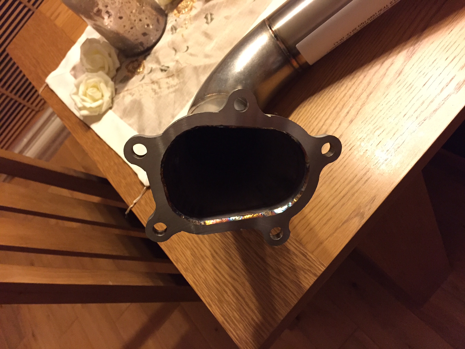

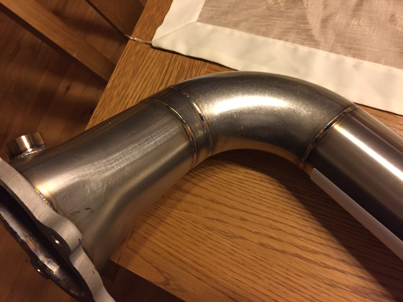

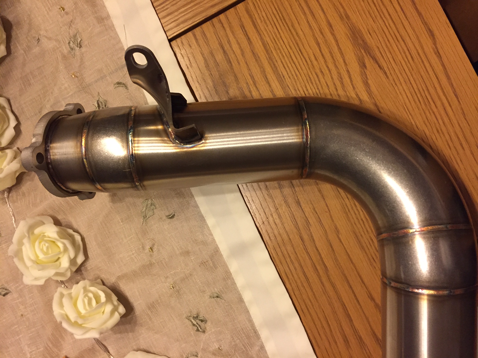

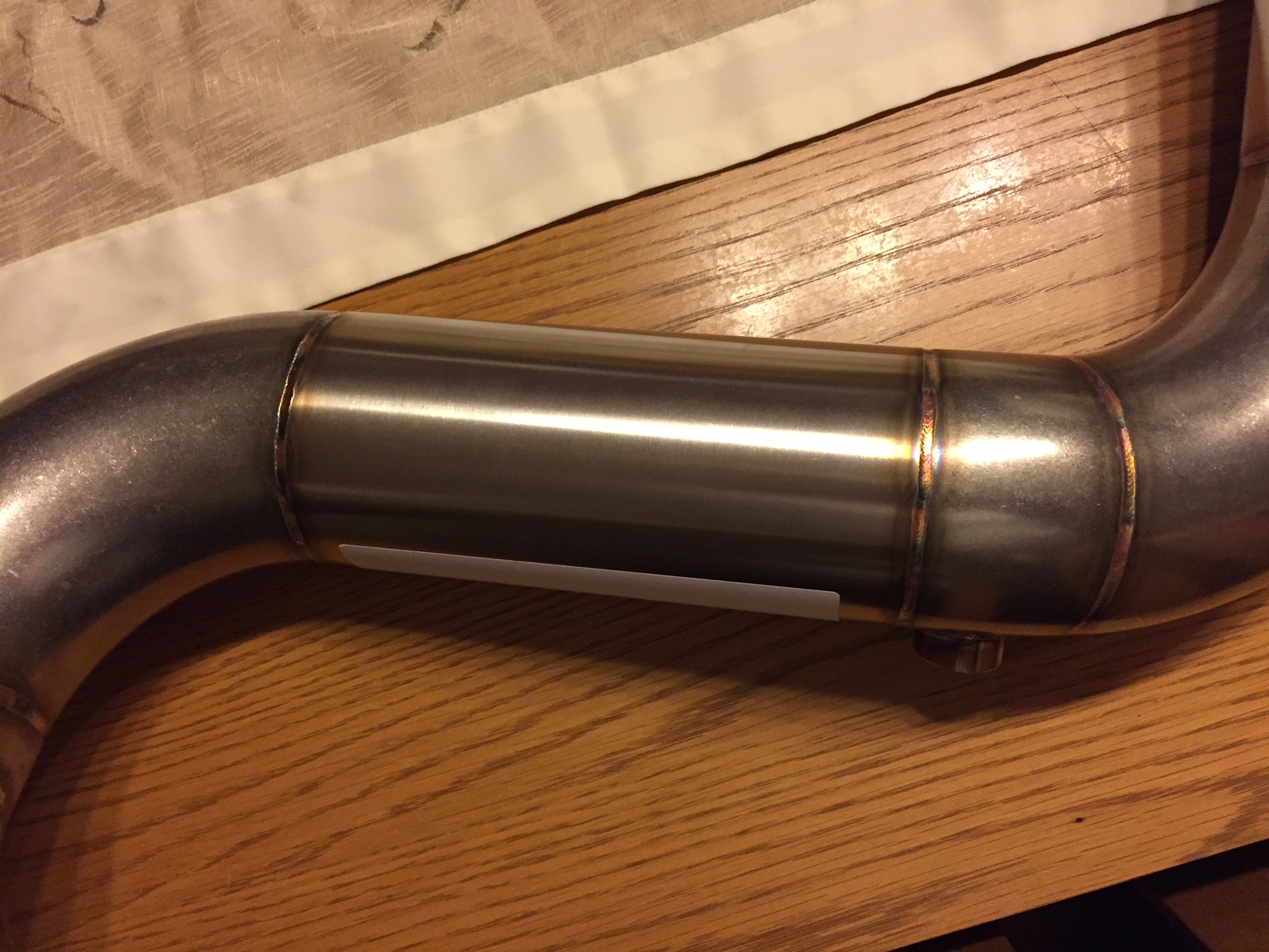

Wow, cant fault the fabrication and / or welding, looks fantastic. Compared to the milltek welding its night and day. milltek looks shabby.
I like the way the turbo outlet has been formed as well. Not the usual 3" pipe with a cut out and 1/2 a 3" pipe welded over the top to create the wide bell mouth end. this is a proper formed wide end. I guess only time will tell if it cracks or not.

apologies if missed but what materail are the downpipes made from ?
Re: 800bhp + DIY Project
Stainless SteelTTE Si wrote:apologies if missed but what materail are the downpipes made from ?

But no idea on what type ? Quite a few grades. Some much better at heat so wondered as the better ones do cost more in raw form.Paulm wrote:Stainless SteelTTE Si wrote:apologies if missed but what materail are the downpipes made from ?
Agree but most use 304 or 316 and range from 1.2mm to 1.65mm.TTE Si wrote:But no idea on what type ? Quite a few grades. Some much better at heat so wondered as the better ones do cost more in raw form.Paulm wrote:Stainless SteelTTE Si wrote:apologies if missed but what materail are the downpipes made from ?
E.g Milltek use 304 @1.65mm on some cars and go down to 1.2mm on others
My pipes are 304 and 2mm thick which is actually better than most.
