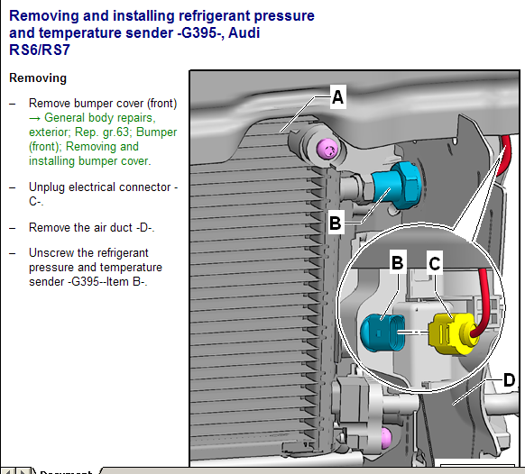

I removed the cover to get access to replace the HP AC pressure switch on my RS6 C7
Cant see where it is it’s near the passenger front light but where
Anyone got pictures mine is 2013-14 model

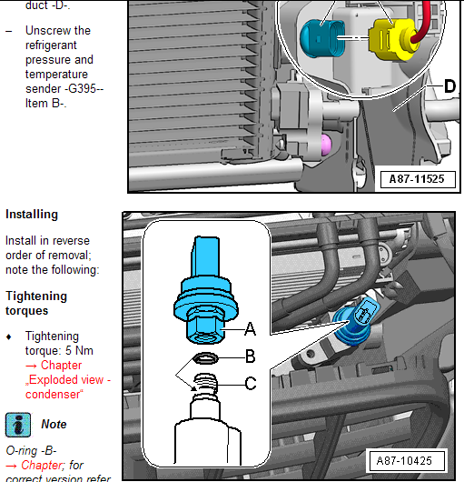

ELSAwin shows it here: (presuming it is the combined temperature and pressure unit)
[second picture shows the general arrangement for non RS6]

Post by morski » Mon May 29, 2023 12:31 am
Much lower down and usually a bumper off job to get to it

Post by Piece » Sat Jun 10, 2023 3:15 pm
Definitely bumper off job. Just had mine done at dealers. Sensor, local wiring and ADAS calibration.
