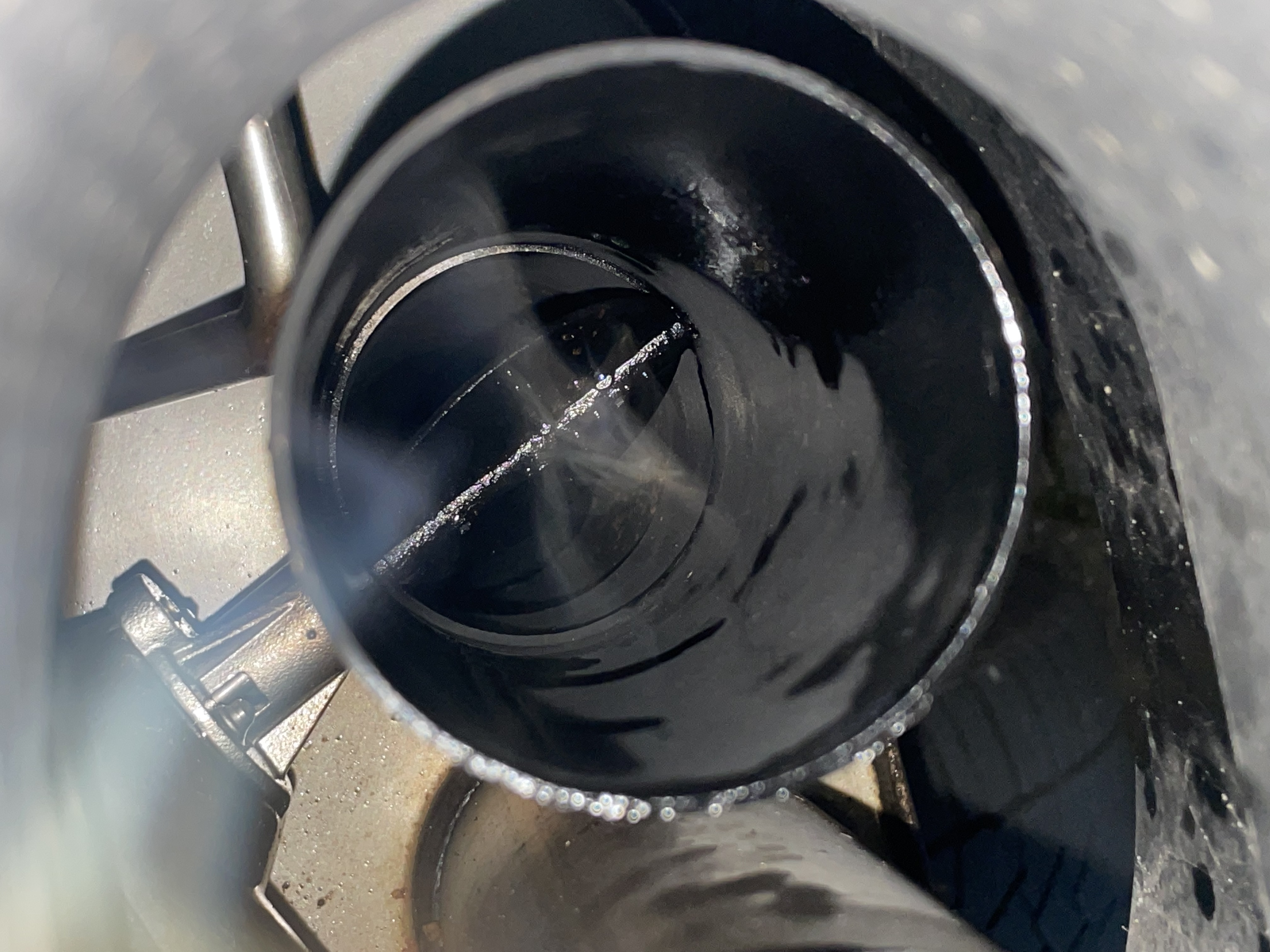

I checked, both seem to be open all the time. I looked in with the car turned off and last used with engine sound set to comfort, and both are open, started the car and turned Drive select to Comfort but the valves didnt close, turned it to Dynamic then back to Comfort and still no movement. I could feel a wire going to the valve control so assume theyre connected which would suggest theyre both stuck open.
Is there a way to release them, cars only done a few thousand miles in the past few years so maybe salt and dirt, plus the obvious coking got in there?

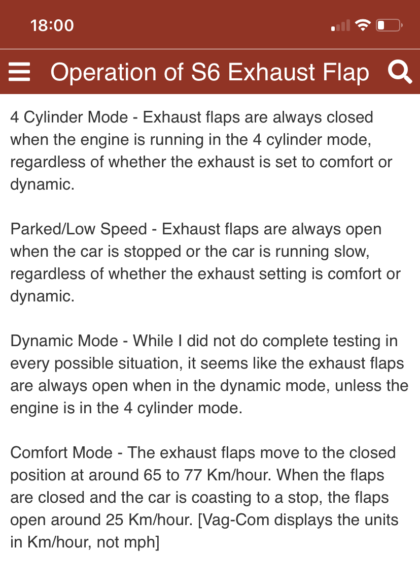

Some research suggests then being open at idle & parked is normal, engine was cold too, so i dont think it means anything then being open today?

Checked again this morning and valves both close no problem so I think its just the none resonated centre section thats causing the drone.
Thanks for the advice
