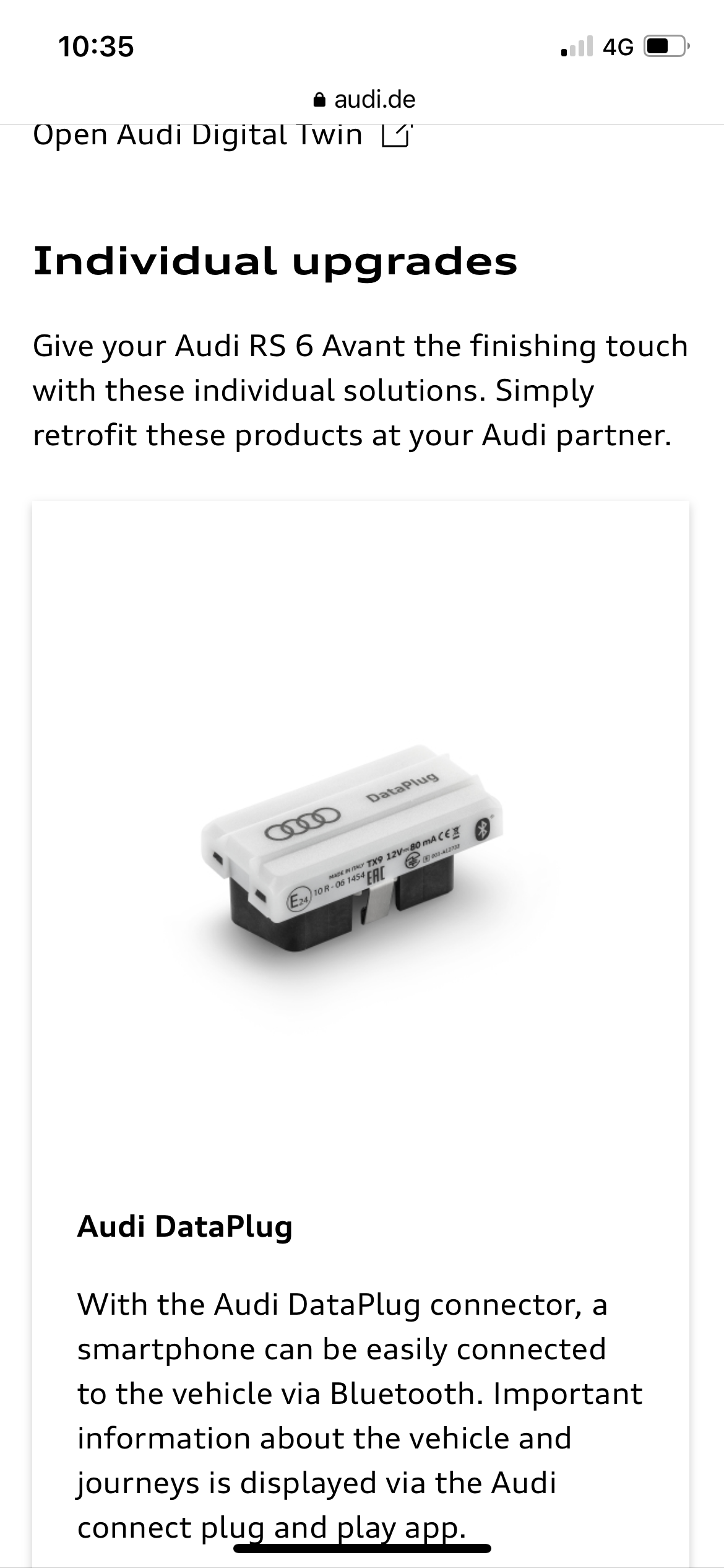

Well I bought my car in Germany second handed but now live in Belgium, hope Belgium accepts fix it
P.a tried log in into my Audi app using Germany or Belgium country nothing about recall only got update on smart phone adapter and it’s only when you log in using Germany country not Belgium
