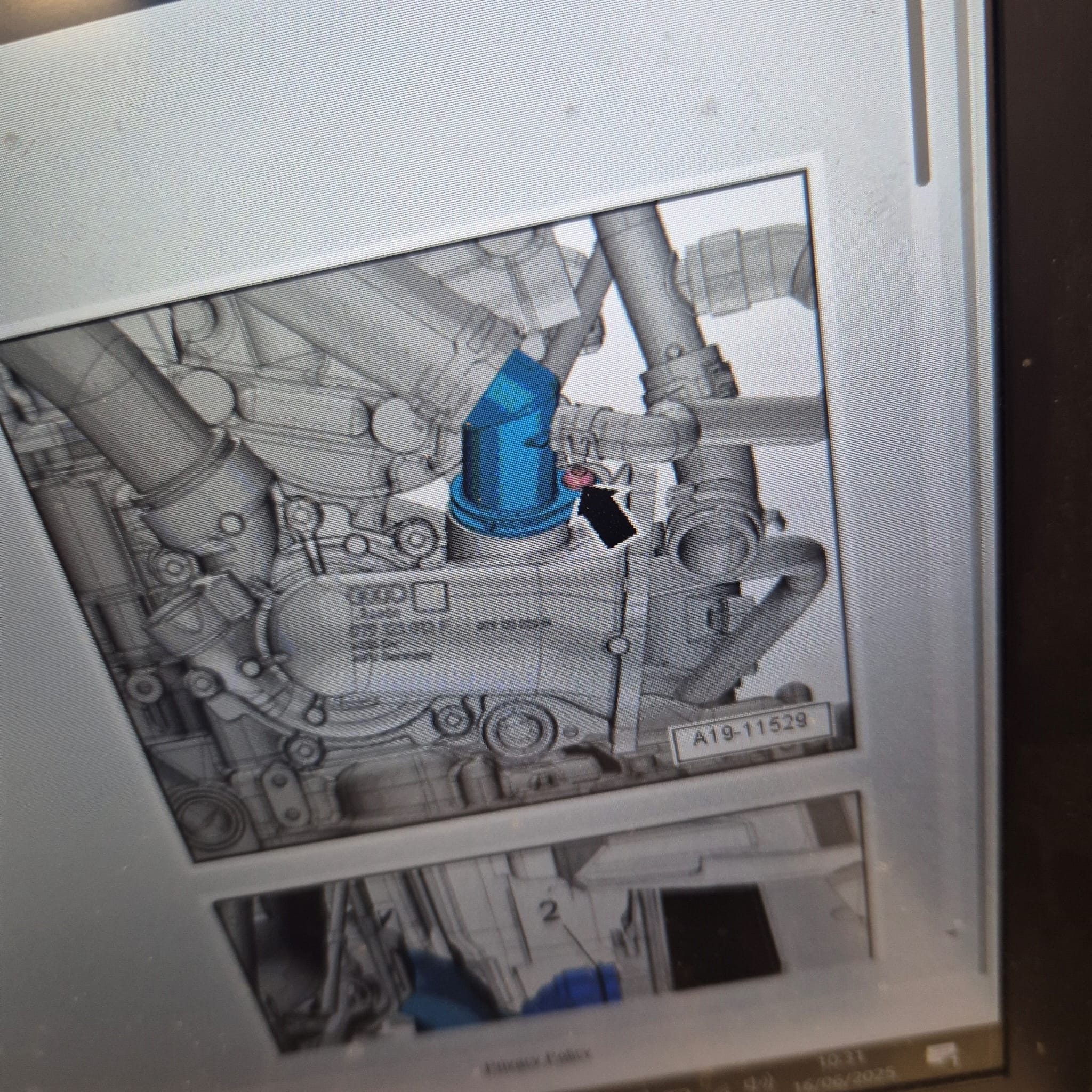

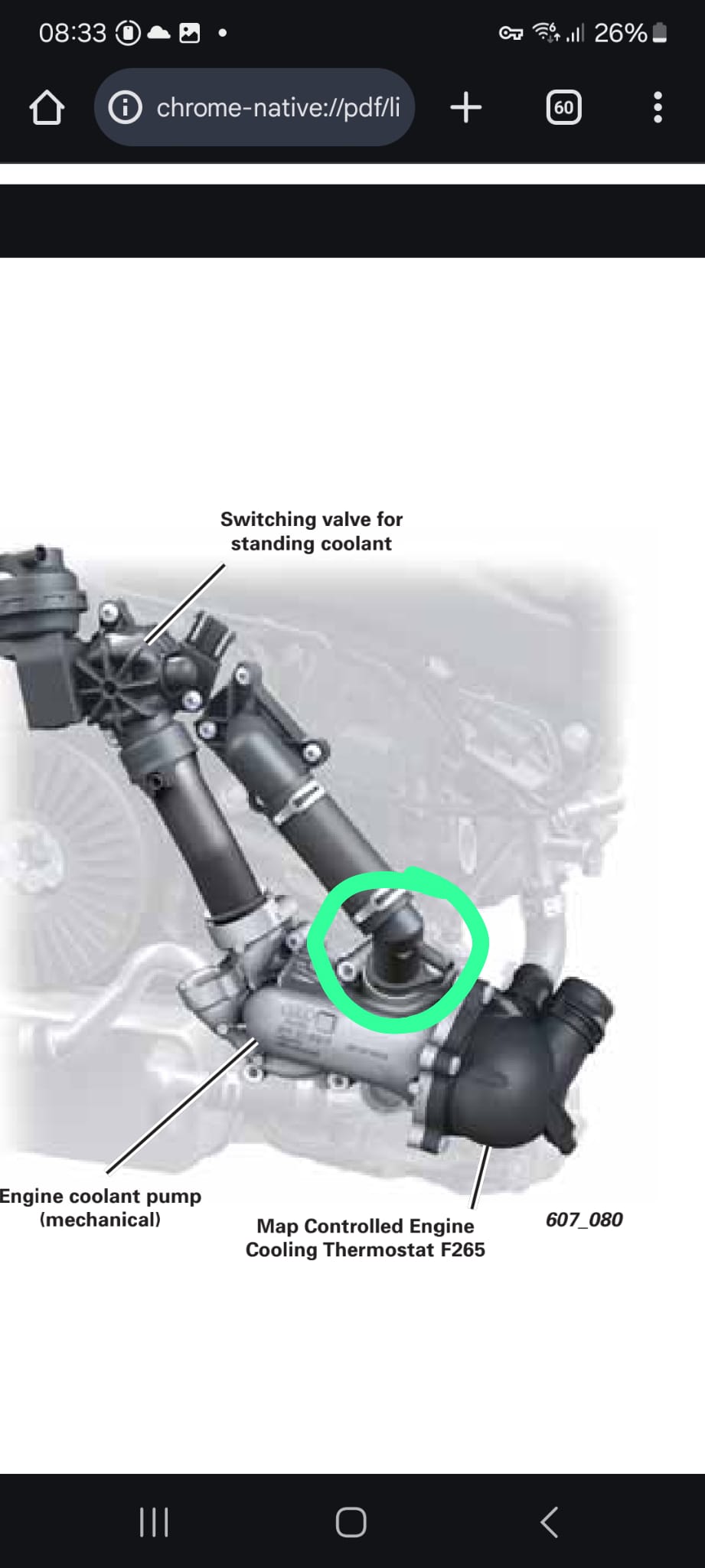

Old thread I know. I joined to answer this question as it had me vexed for months. I had exactly the same issue, a small coolant leak but only when stone cold. Wouldn't leak a drop when it was being driven daily and pressure test was turning up nothing. Five different garages including two Audi dealerships, one performance Audi specialist and two performance car garages with no joy.
I got in there myself afelter leaving it standing for a few days and with some UV dye, a UV torch and a boroscope and with some digging and I found the culprit. A fitting on top of the coolant pump. It is a front end off job to fix.
