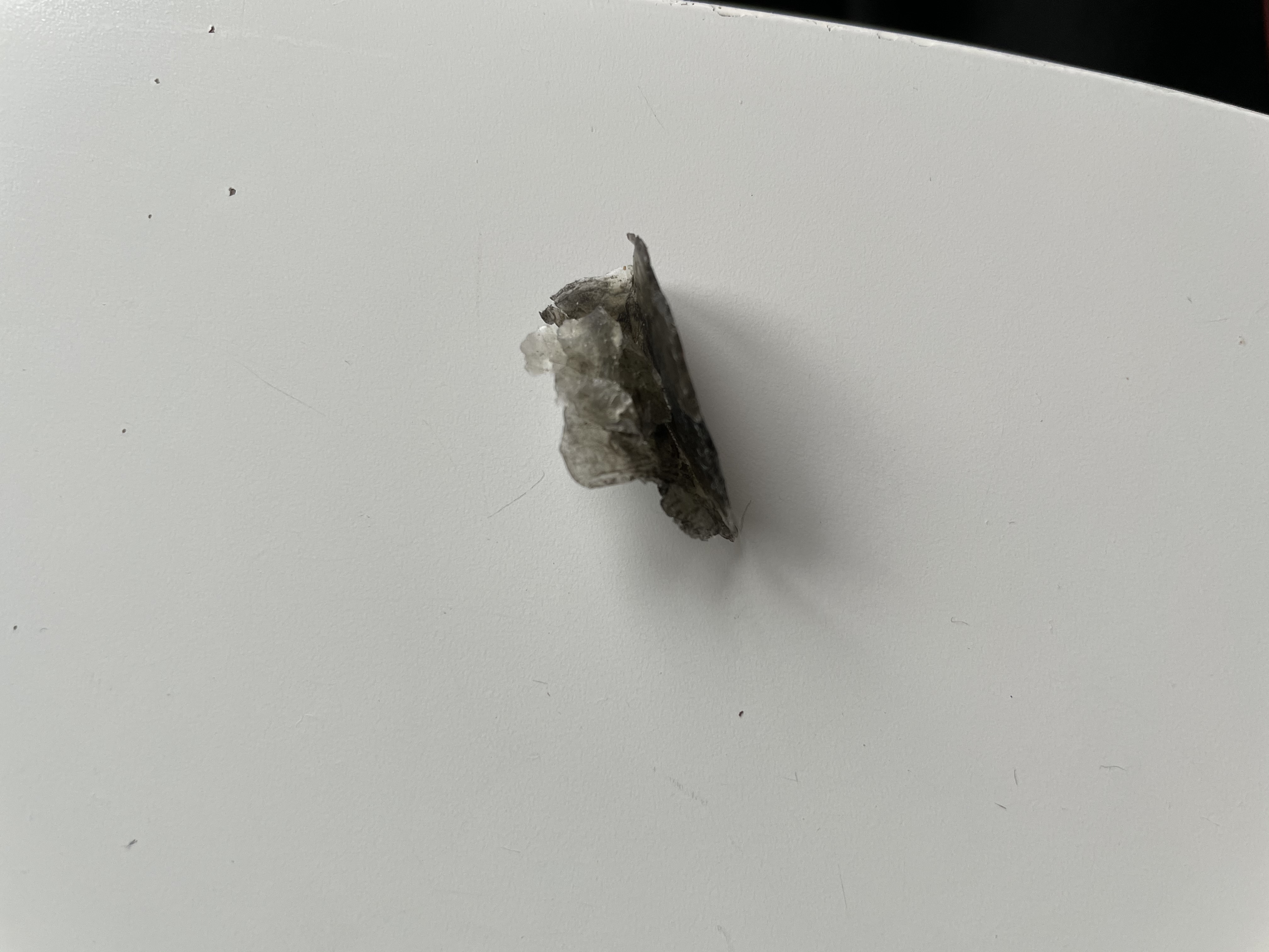

Interesting, sometime ago I also noticed on a floor something like yellow wax, but didn’t take any care, showed to dealer this piece of item but they said nothing, it’s like paraffine wax or something
