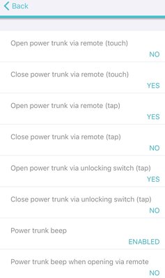

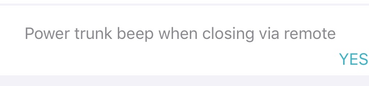

Post by Tadass910 » Wed Jan 08, 2020 5:32 pm
Just tried carista and got those boot options: so which one is for closing boot with remote key?
Re: VCDS - Carista
Post by MikeFish » Wed Jan 08, 2020 8:56 pm

Re: VCDS - Carista
Post by MikeFish » Wed Jan 08, 2020 9:08 pm
Are those options the current settings in your car (the yes and no part)? I ask because they look wrong from the factory setting to me.
This is my opinion on these settings;
open power trunk via remote (touch) set to yes
close power trunk via remote (touch) set to no
open power trunk via remote (tap) set to no
open power trunk via unlocking switch (tap) set to yes
close power trunk via unlocking switch (tap) set to yes
However, I'd expect to also see the following too:
open power trunk via unlocking switch (touch) set to no
close power trunk via unlocking switch (touch) set to no

Re: VCDS - Carista
Post by Tadass910 » Thu Jan 09, 2020 3:13 pm
Those pictures I took when I scanned my car, didn’t touch anything in there. P.s my car has no keyless option
Why I don’t see those options:?
Could it be because I don’t have keyless option?

Re: VCDS - Carista
Post by Sandy-m2 » Wed Jan 15, 2020 10:16 am
This worked for me in ODB11 once i worked out that it was an Adaptation and not a long code, Just in case anyone else is trying!
