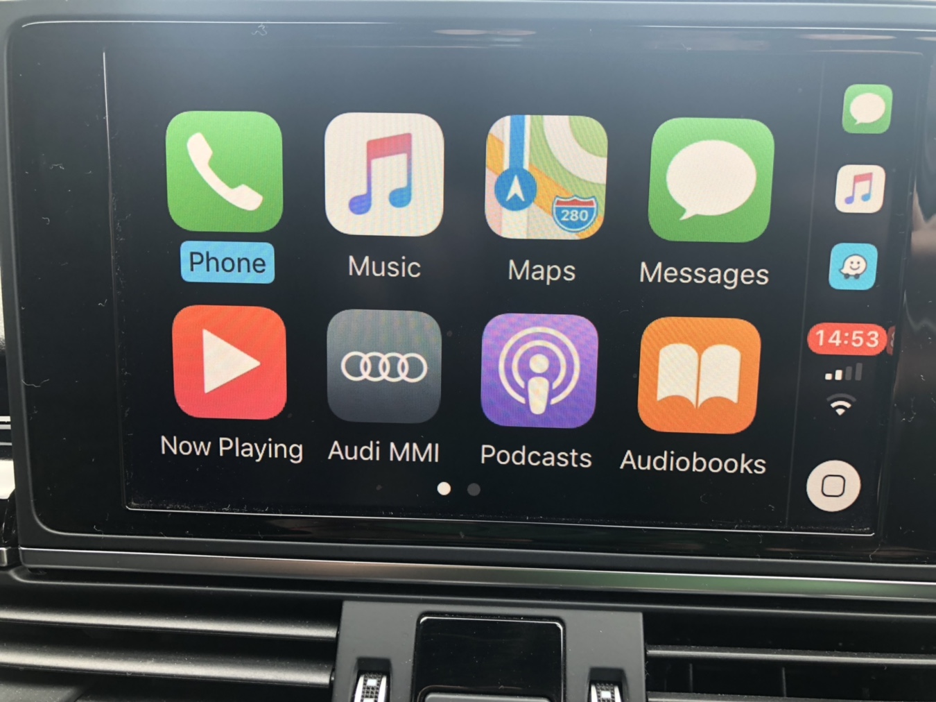

I’ve just had this done. The guy is genuine and I didn’t see anything suspicious in what he does (I work in IT security). I’m very pleased with my outcome!
In more detail:
You need a USB 2.0 to 100Mbps Ethernet adapter based on the AX88772 chip (not necessarily the Dlink one). I got one for £8 from Amazon.
You need an 8gb or larger SD card and be able to read that in your PC (may need a USB adapter)
He sends you a download. Download it and extract to the SD card in advance
He will connect to your pc via TeamViewer
First he will upload some additional files and tools to your machine
Then he does a custom firmware update on the USB to Ethernet adapter. This makes it appear like an Audi diagnostic tool so the MMI will detect it and assign itself an IP.
Then he uses the TeamViewer VPN so he can connect from his PC through to the MMI (via telnet).
He does something to enable custom firmware updates on the MMI
Then he takes you through entering the green screen diagnostic screen on the MMI and triggering a manual firmware update for the MMI components (this are the files you downloaded in advance on the SD card).
Once updated he connect again via telnet to enable the Audi Smartphone feature.
If anyone is getting it done, you’d be welcome to have my USB Etherner adapter for what I paid for it. Benefit is that it already has the right custom firmware on it which will save you half an hour of him updating it.

Just had my 2015 facelift done and it works perfectly. All done for £139 - Great result so much better than the external box

I had the upgrade done at the weekend and loving the use of waze over the standard sat nav. It works really well with the mmi knob/ touchpad too.
