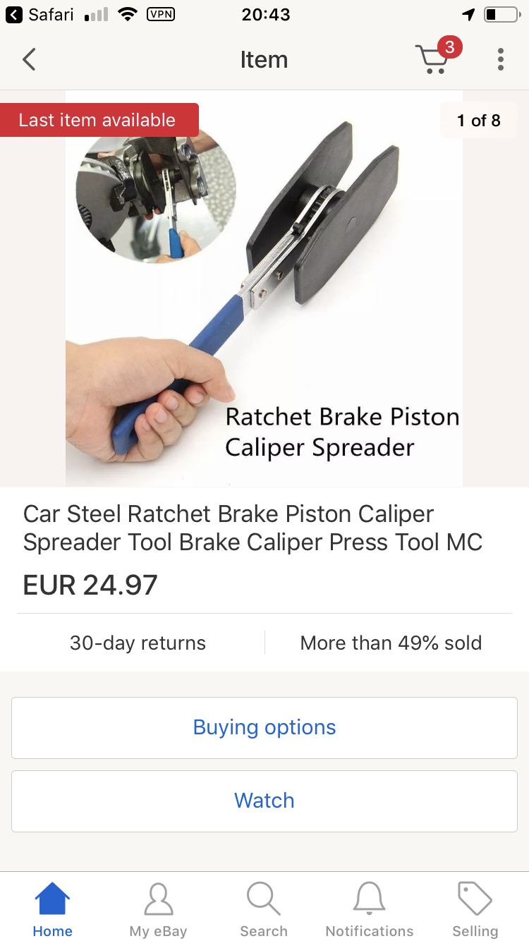

Re: Rear brake pads
Post by Toffeebananas » Tue Feb 05, 2019 8:45 pm
Not one of these then!
shanek
Posts: 59
Joined: Mon Jan 02, 2017 6:55 am
Re: Rear brake pads
Post by shanek » Tue Feb 05, 2019 8:58 pm
No, VCDS needs to be used due to the electronic hand brake, you can try it that way but you will end up wrecking the handbrake servo.

Post by Toffeebananas » Tue Feb 05, 2019 9:04 pm
Thank you :thumbs: Guesing the front callipers are ok to wind back the normal way?
Re: Rear brake pads
Post by MikeFish » Tue Feb 05, 2019 9:53 pm
Correct.
Some people have tried winding the rear ones like normal (on the A6 rather than RS6 but same thing) and reported no issues but not worth the risk if you ask me.

Post by Shimbo » Wed Feb 13, 2019 12:47 pm
you can disconnect the motor and wind them back in and then connect the motor back up its not a big job if you don't have access to VCDS
