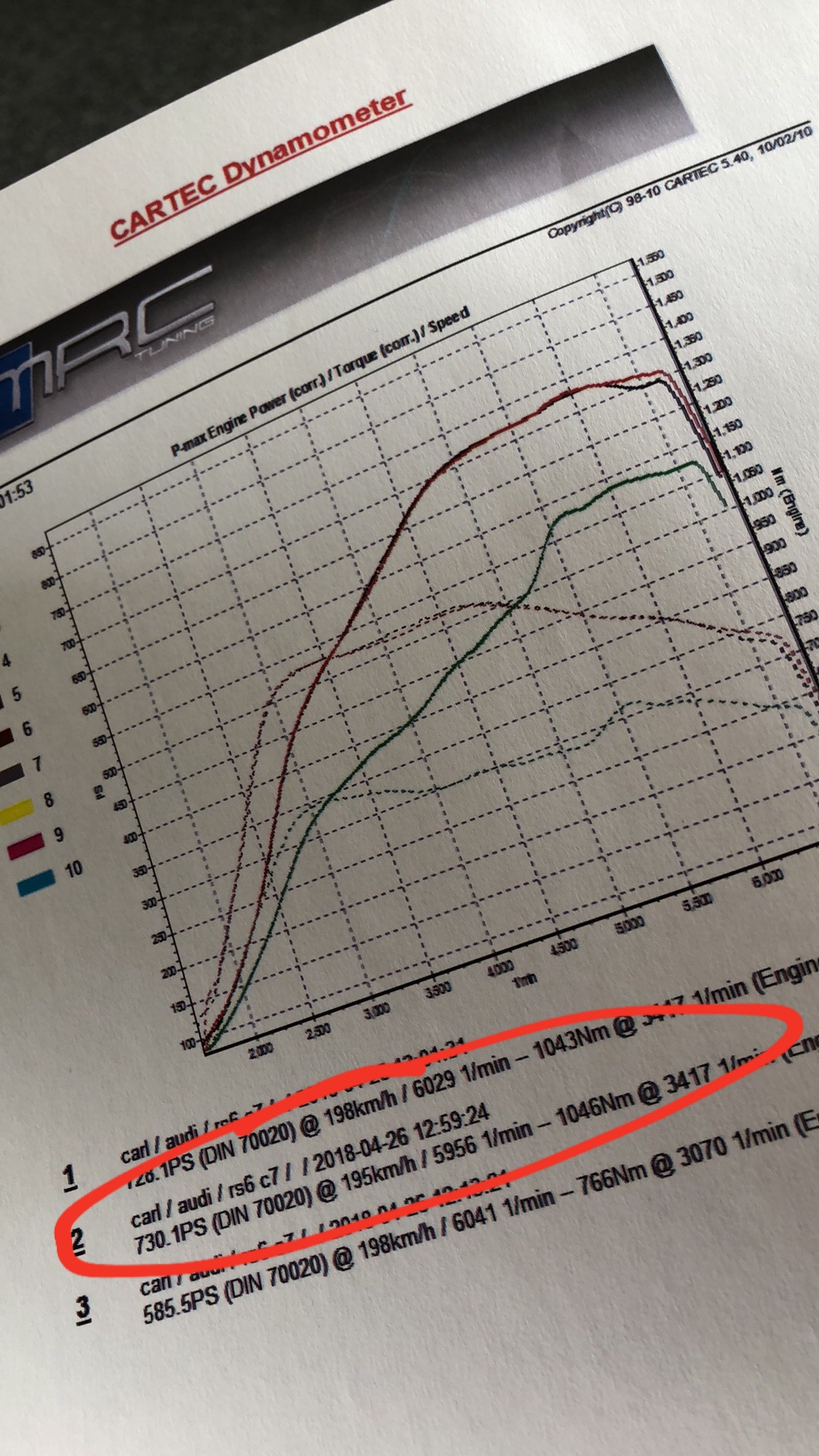

14 hours in the car today, set off at 1:30am and only been in a couple hours,
Well worth the trip though

What’s required hardware wise to achieve these figures mate?

Impressive is that stage 1 or 2 anything other than the ecu remap done
What was Doug's thoughts on the gearbox coping with the torque

That’s full stage 2, had all the hardware fitted by Dave at DH Automotive up here in Scotland then the map by MRC
Full exhaust (non res/decat), downpipes, BMC filter, airbox flap delete, race plugs and full service

My car is a 2014 so 550 standard, 585 with the mods fitted before the remap

730 PS from stage 2 !?!? Image

Sounds about right! They get 120 to 140 extra from the stock engine, so with your mods squeezing out an extra few BHP should be possible!

It’s a Bloody monster!!! Totally transforms the car
Maybe flap was wrong, there’s a part in the airbox to circulate the air around the box, that’s been removed so the BMC filter gets it direct
