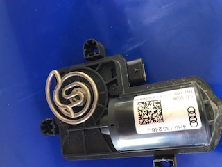

Anyone of you experienced (as i) one of the valves continuous open? Will not close in "Comfort" mode.

I used to have it when i swapped from stock exhaust to milltek. The left one (drivers) side wouldn't open. I couldn't figuer it out, so untill i found out why i had loosen up the actuator, manually turned open and soft bolted it back on. Drove a half year around with it untill i recently decided to check again. Realigned the spring and valueplate...and what you know, it was correct now.

Problem solved by myself. The spring connection from the exhaust valve motor and the valve itself was "out of position".

I’ve been having this exact issue. I know it’s an old post but I’ve got a 2015 s7 with apr exhaust. The Shop ended up swapping actuators bc the driver side kept staying closed. We unplugged them as per your post and just going to give it some time and plug them back in later.
We shall see lol.
In regards to OP. We tried to swap and realign the actuators and nothing was working right. Leaving them open all the time isn’t ideal bc it’s got a lot more droning now but 🤷🏻‍♂️

Not sure what valves APR use but milltek used valves with additional little spring under the valve (i suppose against rattling flap or give it some extra tension). But over time exhaust carbon fills up the cilinder with spring and therefor the OEM spring can't push the valve downwards enough and valve keeps in lock position (small lip).
SInce i removed the little spring on both sides, they been working flowless in combination with the cete exhaust module (manual overwrite + memory).
