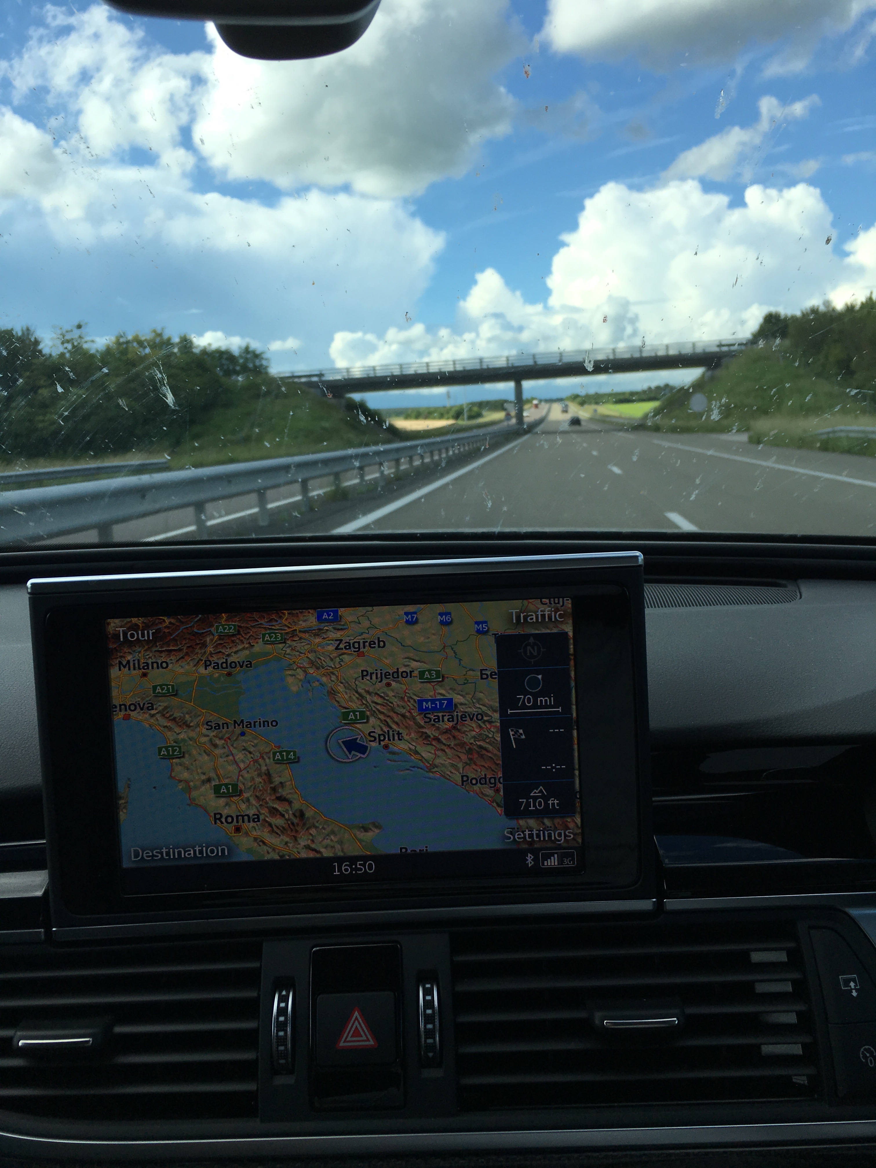

just to confirm what was said before, the car is clever enough to know that its in Europe from the satnav and switches the lights and adaptive cruise to suit. All good.... providing your satnav system doesn't go on the fritz as mine did!?
the car got locked on some random location and thus meant i was driving off road for vast swaths of my trip - see pic below: car thought had driven to Split from Italy, when actually I was just past Lyon - this in turn defaults the settings back to its standard ones (e.g. uk settings) and also disables the ability in the MMI to flip the lights manually too. brilliant.
anyway, it took about a dozen resets of the MMI to get the thing working again (and for some reason the reset only worked when the car was not running and then turned off straight after the reset).
