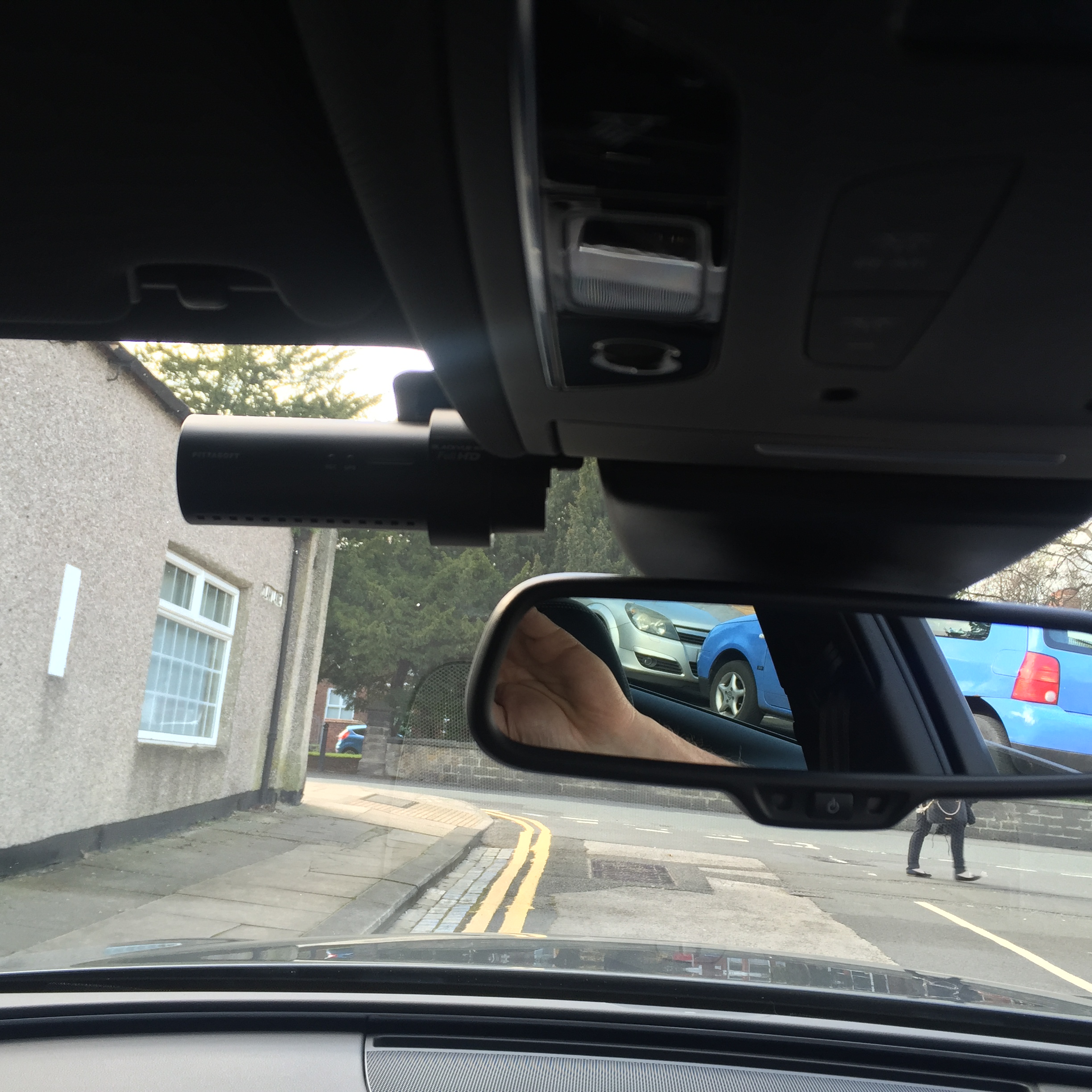

I've got a Blackvue fitted to mine. had about a year with no issues. easy to review the footage using the wireless and Blackvue app.

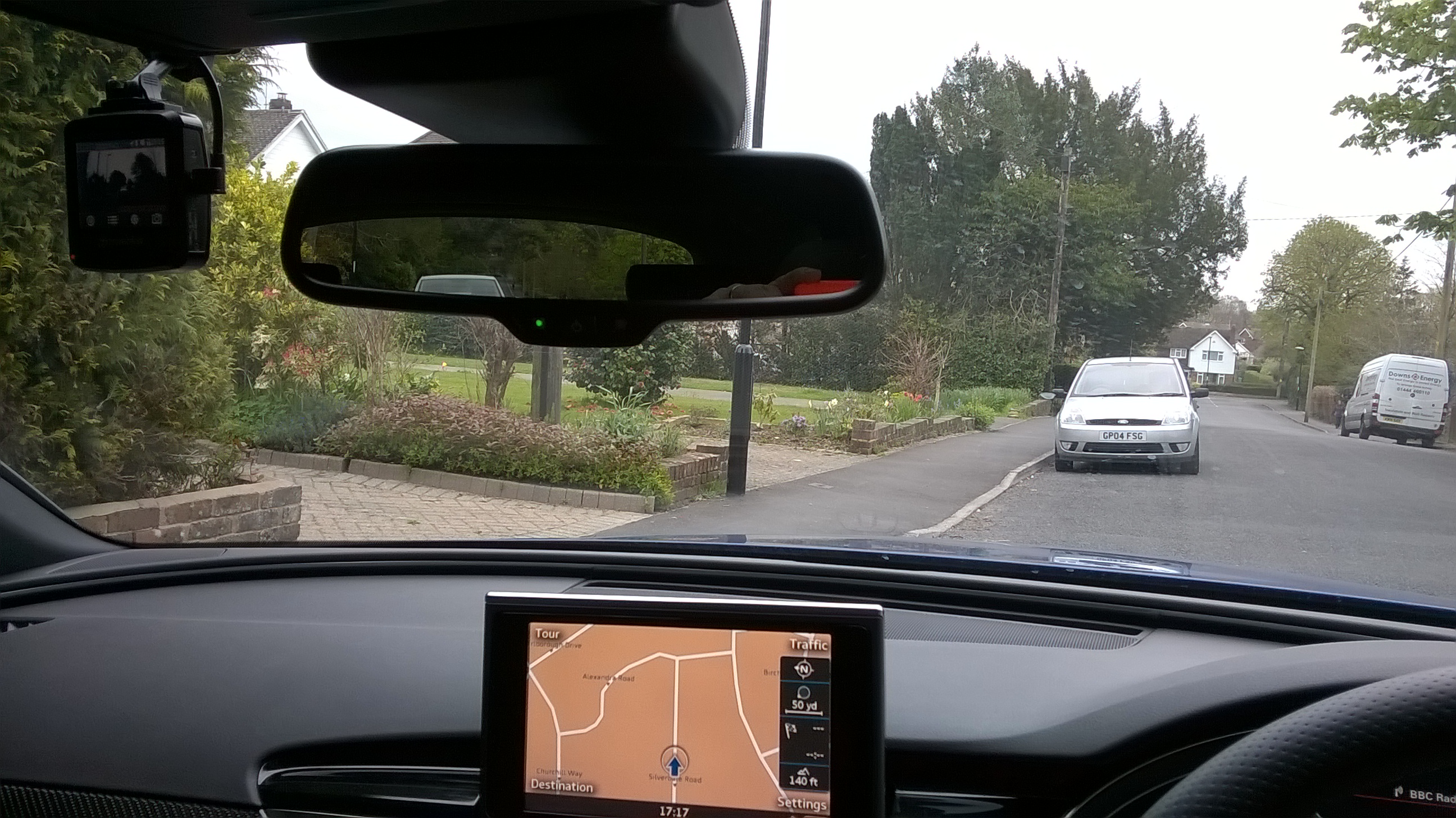

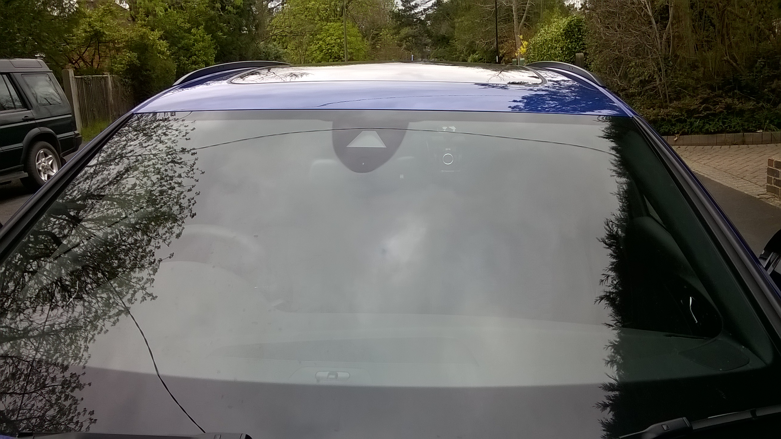

I went with a Transcend a month ago as good write ups and reliable. Wanted to buy from a Shop (Halfords) in case of returns also got it in a sale and then 10% off for British cycling org membership. had a roadhawk for many years and time to replace.
Small screen fitted to the left of my rear mirror in the rs6 (from drivers seat) . works well. run a cable to the centre arm rest usb port for power. nicely hidden easy to do.
Looked at one with front and rear etc but in the end didn't want the hassle of the wires and a 'central' box.
Pic of Transcend - if you click on the picture to enlarge - you can then just see the camera to the side of the rear mirror.

Blackvue for me
Pretty neat and simple to use

RS6Chris, I have a Blackvue in exactly the same place as you but I really struggled to get the wire down to the fusebox. How did you get down the A-pillar? Or did you go down via a different route? Thanks.

Hi mate
Wire runs at top of windscreen tucked under headliner, down A piller again tucked behind trim, behind end of dashboard trim, under glove box(using little Blackvue cable clips) behind transmission tunnel trim, up into armrest power socket.
It only works when ignition on of course at min....my Porsche ran all the time as always had power to 12v socket.
