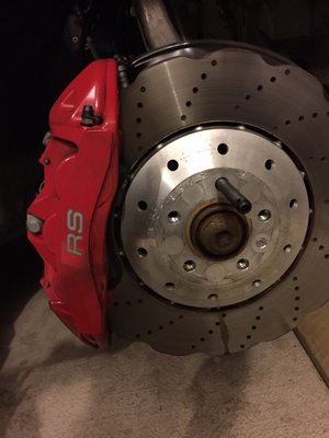

I run 20 inch wheels on my car. Can I get a spacesaver to fit in the well of the boot that fit over the brakes and work rolling circumference wise?

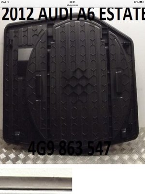

Have been meaning to write up properly but didn't get round to it. I ordered a 20 inch space saver for the RS6. It fit in the boot fine once the load liner over the battery is removed. I got a new tool kit from ebay which sits on top of the battery below the wheel. The compressor and gunk fit under the wheel also but this is because I have RS Sports suspension plus which removes the aluminium air accumulator the wheel well for the standard air suspension. I ordered the plastic tray from ebay to cover the wheel up as per the standard spec for cars with the spare wheel. I was also nervous that it wouldn't fit. On such a practical and already heavy car I think the spare is a must for long trips. If I ever use it in anger I'll be careful on the throttle as its nearly half the width of the standard wheel.

The wheel is a 145 60 R20. The toolkit that fits over the battery and under the wheels is part number 4G0 012 109. The new tray part number is 4G9 863 547
