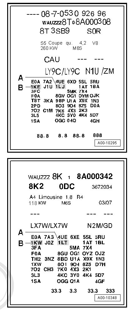

If you can give me the info off your build label I should be able to help. Example image attached, location A are the front and B the rear calipers.
I think you will have 1LM or 1LW (ceramic) on the front, the rear I can't guess at.
