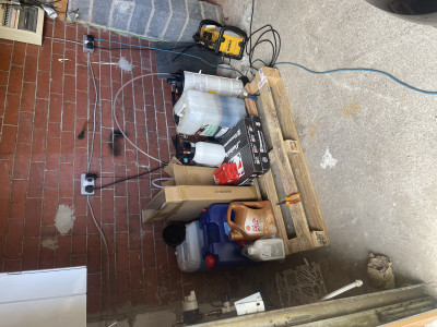

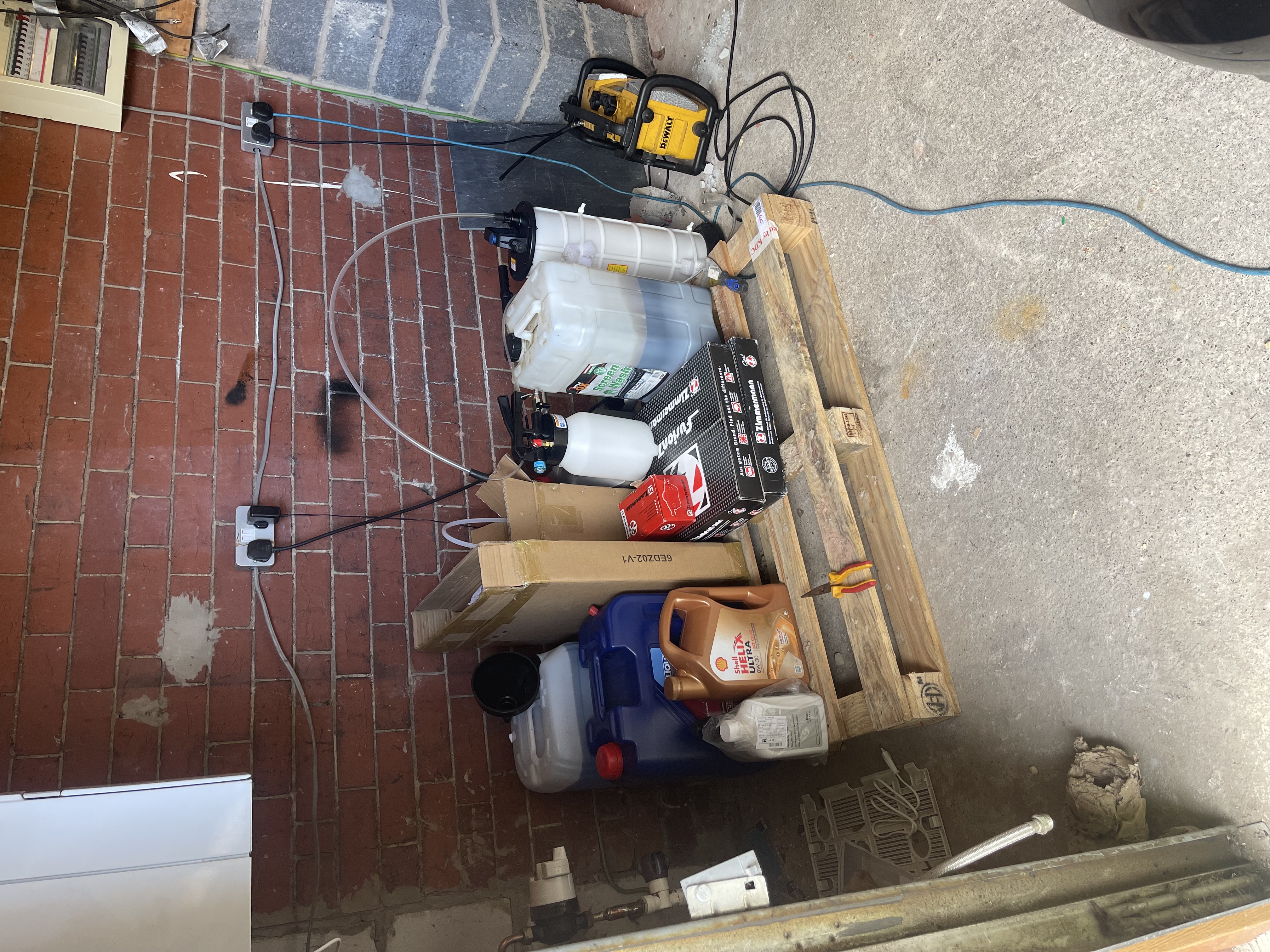

Post by Bendelaurence » Sat Jun 24, 2023 11:25 am
Life of an rs4 diyer.
Few more bits and we can get cracking
